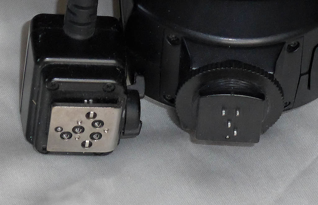

Jared Posted December 31, 2015 Share #15 Posted December 31, 2015 I just checked with my SF 58 (Leica/Metz) flash and the SL. HSS mode is set automatically on the flash when the flash is mounted in the hot shoe and shutter speeds climb up over 1/250s. Obviously, range is severely impacted (as you would expect). I also tried this same combination using Nikon SC-17 remote cord and everything worked the same--HSS was fine. The pin-out on Leica and Nikon hot shoes is identical so the cable works fine. I checked with my Phottix Strato II wireless triggers and HSS is NOT supported. That is as expected since not even TTL flash metering is supported using these simple triggers. They are meant for--and work well for--manual, remote flash but do not support anything sophisticated like TTL or HSS. It is possible that something like the Phottix Odin or Pocket Wizard MiniTT1 would work for HSS (they both support HSS on Nikon and the pin-out on Nikon is identical to Leica), but there is no guarantee that Leica and Nikon are similar enough in their signals for HSS to work with ANY wireless trigger that isn't designed specifically for Leica. Maybe someone else has experience? Frankly, I doubt it is possible to get HSS to work off-camera at this time, and PocketWizard has never supported Leica for anything other than manual triggering of flashes. For that, the PocketWizard (or the less expensive Phottix Strato II's) work just great. Multiple channels and multiple zones. By the way, for manual settings I would expect triggers like the Phottix and PocketWizard to work well with your SB-800/900 flashes as well. Again, the same pin-out for Nikon and Leica means that you should be able to trigger a manually set Nikon strobe the same way as a manually set Leica strobe. If remote trigger of flashes in HSS mode is an important part of your photography, I don't think ditching your Nikon system is possible at this time. - Jared 1 Link to post Share on other sites More sharing options...

Jared Posted January 3, 2016 Share #18 Posted January 3, 2016 My SF 58 must be series two, then, since HSS enables automatically when I select a shutter speed faster than 1/250s on the SL. I can see it light up in the LCD. And yes, it works the same on the Nikon SC-17 cord as well and produces an evenly exposed image. This feature is also available on the newly announced SF 64 and SF 40, but I have no experience with those units. I would be very surprised if HSS worked with a Nikon speed light on the SC-17 but I no longer have any Nikon flashes, so I can't try it out. My guess is that the SC-17 and Leica flash combination is the only way to get off camera HSS, and that would limit you to a single strobe with a fairly short cable. Of course, HSS uses so much power range is going to be limited in any event. - Jared Link to post Share on other sites More sharing options...
