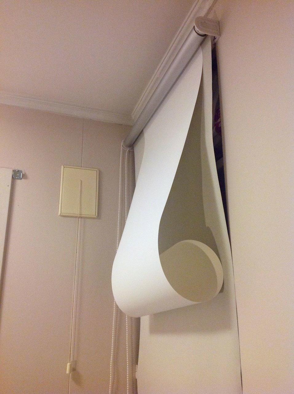

wlaidlaw Posted May 1, 2015 Author Share #55 Posted May 1, 2015 I didn't have any luck cutting roll paper and trying to decurl when I had an Epson R1800 some 12 years ago, so for me, I think it is a process I will try and avoid if there is an alternative. I know my daughter's father-in-law, who is one of the USA's top professional art photographers, and prints off roll on Epson 7880 and 11880 wide format printers, always has stacks of prints for clients sitting in flattening clamps in a heated cupboard. Even he says how difficult it is to get roll paper 100% flat. For his really important exhibition stuff he often uses a huge Durst flat bed printer that takes up the whole of a large room. He can then print on very thick flat paper and even on steel or copper sheets with that. Wilson Link to post Share on other sites More sharing options...
Nordvik Posted May 1, 2015 Share #56 Posted May 1, 2015 I have cut a 30m roll of Enhanced Matte Epson and about half of a 27m Smooth Pearl Ilford into 25,5 x 17". I think the printer head hit the paper two times out of 50-70 papers. The problem with cutting paper like this is to get the cut at 90 degrees, if it is not the printer will not accept it. Link to post Share on other sites More sharing options...
wlaidlaw Posted May 1, 2015 Author Share #57 Posted May 1, 2015 Cutting is no problem as I have a large guillotine (well one would in France ). It is getting the paper flat enough to feed that concerns me. The 3880 seems less fussy than the Canon Pixma Pro-1, where the tiniest bend or curl in the paper will cause a misfeed. Even paper which has sat in a box and got slightly cold or damp (the Canon sits in an attic bedroom in my UK house, which until late last year, only had a small oil filled electric radiator in it) and is not exactly 100% flat, will misfeed in the Canon. Wilson Link to post Share on other sites More sharing options...
Nordvik Posted May 1, 2015 Share #58 Posted May 1, 2015 It gets flat enough if you decurl the first five cm at both ends (there are youtube videos for this, or use something like in my picture. I think that one is from IKEA). I had one or two head strikes with the Enhanced Matte paper, but none with Smooth Pearl. The rear paper feeder is temperamental, you need to push the paper "just right". When you have done it a couple of times you will get the feel of it. Link to post Share on other sites More sharing options...
