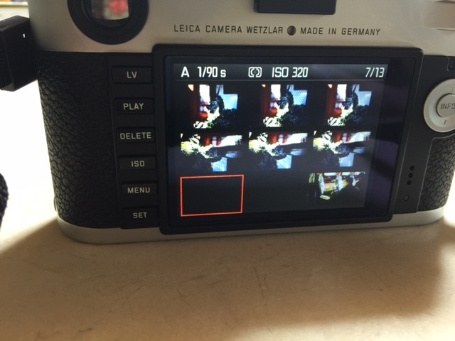

carta Posted December 14, 2014 Author Share #7 Posted December 14, 2014 Advertisement (gone after registration) If you view the image in the camera do you get a text “L123456 (or another number) on it?If so, you have an SD card that a has either been used in another camera and not reformatted in the Leica, or an SD card gone bad. Thank you for your reply. Once again today this happened - I checked and there are no such messages. Let me post some pictures once I get home. I will contact Leica on Monday. Link to post Share on other sites More sharing options...
carta Posted December 14, 2014 Author Share #8 Posted December 14, 2014 All, Here is what the black photos look like: Welcome, dear visitor! As registered member you'd see an image here… Simply register for free here – We are always happy to welcome new members! I will be contacting Leica about this issue. 1 Link to post Share on other sites Simply register for free here – We are always happy to welcome new members! I will be contacting Leica about this issue. ' data-webShareUrl='https://www.l-camera-forum.com/topic/238422-pitch-black-photos/?do=findComment&comment=2727986'>More sharing options...

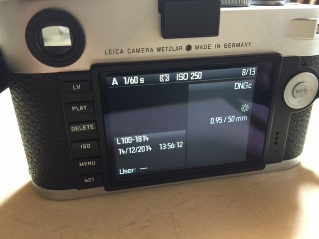

carta Posted December 28, 2014 Author Share #15 Posted December 28, 2014 Hi, just received my camera back from Leica support. Welcome, dear visitor! As registered member you'd see an image here… Simply register for free here – We are always happy to welcome new members! They examined the black DNG file and understood what the problem was, but were unable to re-create the situation at their labs. However, they were kind enough to exchange the shutter unit, the image sensor unit, and the circuit that connects with the SD card - pretty much a brand-new camera. It was within warranty so no charge. Initially I was told that I may not get the camera back within the year, so that was unexpected but very welcome. Again, thank you all for your input - hope that nobody will have to go through the same problem! 7 Link to post Share on other sites Simply register for free here – We are always happy to welcome new members! They examined the black DNG file and understood what the problem was, but were unable to re-create the situation at their labs. However, they were kind enough to exchange the shutter unit, the image sensor unit, and the circuit that connects with the SD card - pretty much a brand-new camera. It was within warranty so no charge. Initially I was told that I may not get the camera back within the year, so that was unexpected but very welcome. Again, thank you all for your input - hope that nobody will have to go through the same problem! ' data-webShareUrl='https://www.l-camera-forum.com/topic/238422-pitch-black-photos/?do=findComment&comment=2736558'>More sharing options...
