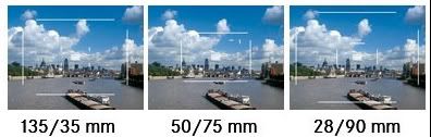

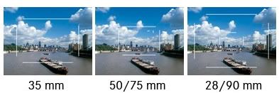

visiondr Posted March 12, 2007 Share #17 Posted March 12, 2007 I have a .72 MP and only use lenses 50mm and wider. I wonder, can someone who's had .72 and .58 finders tell me if the 75mm framelines on the .72 are close in physical size to what the 50mm framelines would look like on the .58? Does this question make sense? I just want to know how small the 50mm framelines will look through a .58 finder. Link to post Share on other sites More sharing options...
DBerens Posted March 12, 2007 Author Share #18 Posted March 12, 2007 Ron, Here is a shot of the .58 frames from the Leica website. Hope that answers your question. -D. Link to post Share on other sites More sharing options...
DBerens Posted March 12, 2007 Author Share #19 Posted March 12, 2007 Oops, and the .72 Looking at them side-by-side the difference seems fairly small but the 75mm frame is already really small...I like the subtle difference it makes in the 35mm frame. So on the .58 does it look like you could use the 24mm and estimate the framing using the full frame (no lines)? Link to post Share on other sites More sharing options...
visiondr Posted March 13, 2007 Share #20 Posted March 13, 2007 David, Thank you. That set of illustrations (although small) make sense to me. I suspect you're correct; that one can use the outside of the .58 finder to determine the view of a 24 or 25mm lens. Link to post Share on other sites More sharing options...
