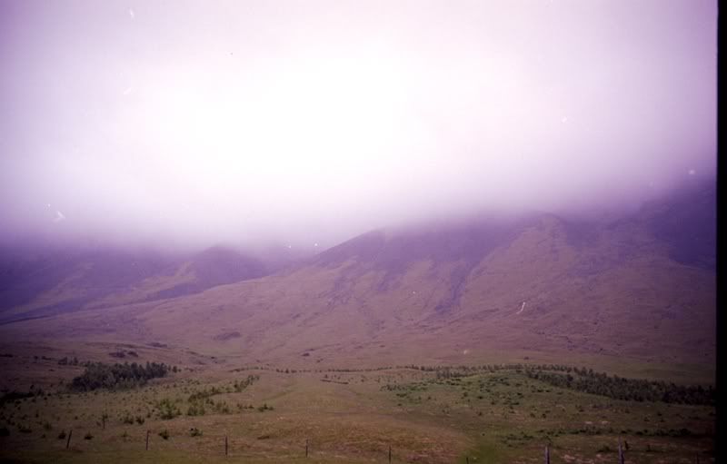

skovbo13 Posted September 13, 2010 Share #1 Posted September 13, 2010 Advertisement (gone after registration) G'day everyone, A couple of months ago I purchased an Epson V700 scanner in order to be able to scan my rolls of 35mm color film myself. Since using it for the first time, I have been getting a more or less constant blue/purple tint in all my scans. I have tried both the bundled epson and silverfast software and both provide less than adequate results colorwise. Fiddling with the scan settings doesn't radically improve things either and is rather cumbersome. Is there a solution to this? Here is an example scan I made with all settings at default, shot with Fuji Reala film on my MP: Link to post Share on other sites More sharing options...

Stealth3kpl Posted September 13, 2010 Share #4 Posted September 13, 2010 Pete Link to post Share on other sites More sharing options...

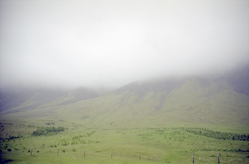

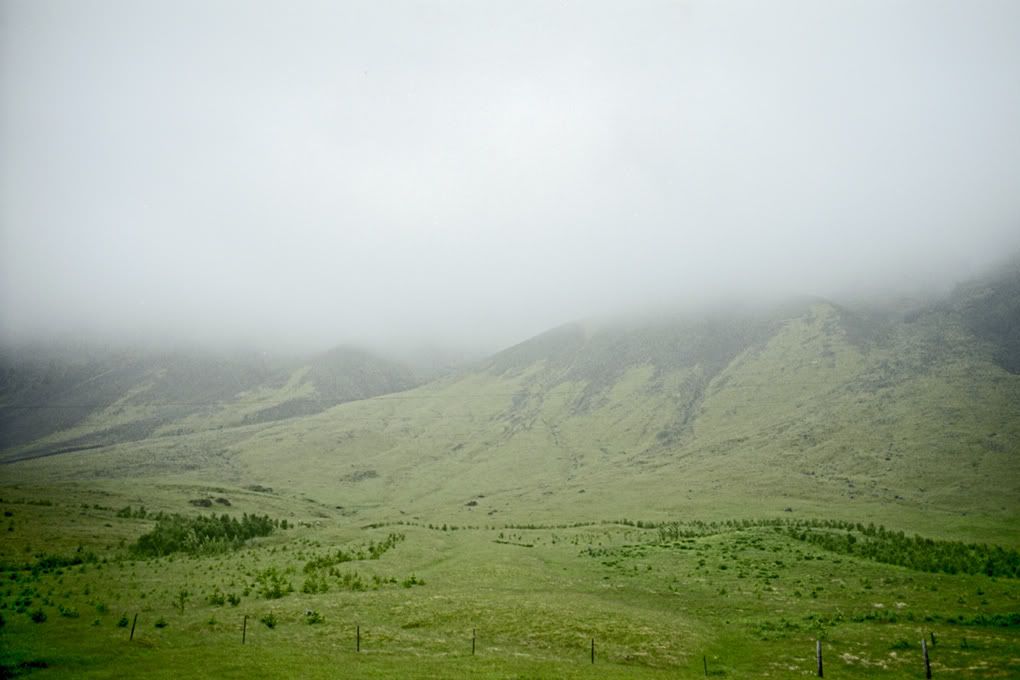

skovbo13 Posted September 14, 2010 Author Share #7 Posted September 14, 2010 Advertisement (gone after registration) Thanks everyone for taking the time to answer. I went ahead and bought the vuescan software, the interface seemed nicely intuitive (especially compared to the horrible silverfast software), and I seemed to get good results at first. But.... I noticed now that I get a lot of black burnout in most of my scans, as can be seen in the lower left corner of this image: I have been fiddling with different setting for hours and can't get rid of this. I know it is probably hard to give advice on this without having firsthand control over the settings, but I just cannot believe how difficult and cumbersome this is. I am not exactly new to color correction, having worked for over ten years in advertising and graphic design, but this whole film scanning business strikes me as ridiculously complicated and unintuitive. This below is the scan of the same image which I got from my local lab, and which demonstrates the result I would like to achieve with my own scan: Link to post Share on other sites More sharing options...

menos I M6 Posted September 15, 2010 Share #11 Posted September 15, 2010 I can only think of two reasons, why your lab scans show less "black burnout" than your own scans: They might use a Flextight scanner with the negative evenly lit in all areas. They have an automatic correction for this enabled in software (unlikely the cause). I can actually not think of a reasonable cause for this other than vignetting, which calls always for an easy to do software fix in post processing. Link to post Share on other sites More sharing options...

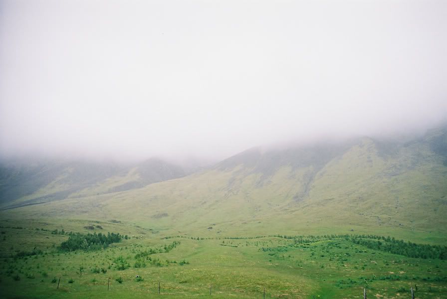

skovbo13 Posted September 22, 2010 Author Share #12 Posted September 22, 2010 After a lot of trial and error in both vuescan and photoshop I finally got this result: Quite an improvement I'd say? Now if I get rid of the cyan cast (tips?) in the sky/fog I am a happy man, and will try an easier image to scan next. Stealth3kpl's advice was rather helpful, thanks a lot. ~S Link to post Share on other sites More sharing options...
