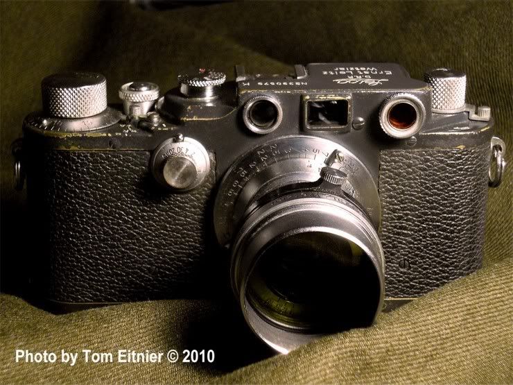

Hello DDM,
The camera with the Elmar has original vulcanite (painted) and the camera with the Summitar has original era pattern but appears to be a replacement (maybe a 1946 shell swap?) ~ the well worn *PATINA* IIIC K looks almost like IIIF vulcanite, but it's not rough enough, strange looking, I know that there was at least (2) differnet vulcanite patterns in the life of the IIIC K era cameras 1942/43 and 1944/45, but that one pattern has be puzzled.
Please write me off the board so I may get your serial numbers for the survivors list that will be published in my Leica Book next year, (book all about the IIIC K and the issues to the US Army)
And it's nice to find another IIIC K collector here at the forum, all three look great, I have to add a shot of my jewels here as well :)
Cheers and Happy Shooting
Tom

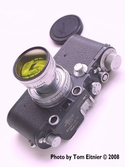

Here's an old photo of my 1943' IIIC K Grey "DARK RED" shutter curtain K, it's about 98.5% paint and all original matching numbers Summitar, it was a WW2 "BRINGBACK" camera the Solider was with the 9th Armored Division that crossed the Luddendorf Bridge/Rhine River at Remagen, March 1945 ~ he brought the camera back and used it while he was an agency Photographer with Black Star NYC ~ shooting for LIFE magazine in the late 1940's
He passed away and I bought the camera from his younger brother from New York in 2008, a IIIC K full of history and ambiance.
Enjoy!
Tom

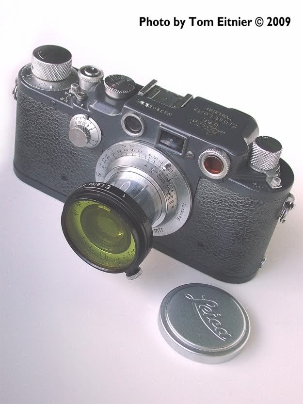

And here's my other IIIC K Grey it's a 1945 US Army issue, issued to a US Army Japanese American First Lieutenant, who gave it to his future wife, who was a Danish national, (German Speaking) interpreter for Military Intelligence in Frankfurt, Germany in 1945.
The camera is 99% paint, but sadly has had a vulcanite shell swap, (correct vulcanite, but from a Leica IIIC conversion *see chrome bumper*) ~ I have a 1946 Grey vulcanite shell I have to swap out, but I have to mix the Luftwaffe RLM 75 paint first.....the Elmar lens is the original lens to body.
Enjoy!
Tom

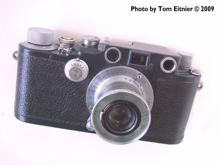

And this was the camera I traded late last year for my Leica M8 ~ #390469 K
*The May 8th 1945 IIIC K ~ Ex - Everett T. Brown collection/ George Carr restored IIIC K/ original matching numbers Elmar 50*
One of the very first cameras issued to the US Army in 1945, (issued only 12 hours after the surrender) the camera was expertly repainted by George Carr sometime in the late 1960's, it came to me with nice patina, (Everett must have used it alot himself) , and I I used it extensively for about 2 years, it was a real fun camera, it's somewhere in the Far East now I believe?
I sort of miss this camera, it was really neat to have a Grey paint IIIC K as a daily user, but I'm L@@KING for another one, original but with lot's of patina, JUST like the one you have DDM ........ ;)
Enjoy
Tom
