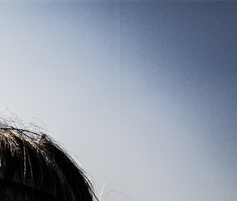

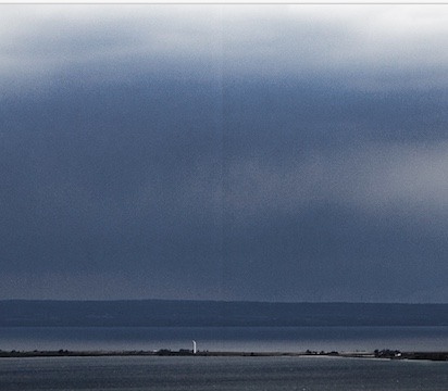

  1. I post this to see if anyone else have/had the same sensor issues with their M240 (M-P). I was playing around in Lightroom in November 2017, mainly testing different extreme values with the haze control, and other stuff to experiment with my photography. To my astonishment I saw a vertical line running exactly in the middle of the uncropped image. I then tested a photo from April 2015 that was taken with another M240 M-P body I had at that time. And the same vertical line appeared. I then randomly tested several other photos, and the same line appears, in virtually all photos, from both M-P bodies! I have a total of more than 20000 photos with M-P:s that in some or another way are affected by this problem. Attached here is an example of a jpg from M-P body 1, and one of M-P body 2, after tweakning the dng:s. The dng:s and full JPG:s can be downloaded to view through the links provided here: Link to DNG (M-P body 1): https://we.tl/FQQkFgKo7U Link to JPG (M-P body 1): https://we.tl/4BpPecbwmR Link to DNG (M-P body 2): https://we.tl/O2Kb9XKab7 Link to JPG (M-P body 2): https://we.tl/a3Vw2FUBYQ These images do not represent my photography (www.m9x.se), but they show the problem very clearly. So I went to my local Leica center in Stockholm who sent it to Leica in Germany. My lokal Leica dealer is fantastic by the way. I instructed Leica to test the way I had done in Lightroom doing the following: - adjust ”haze” to a the right - lower the value of vibrance - lower the value of saturation - set exposure to show a standard good histogram curve Leica concluded that the sensor ”function within tolerances”. They said: Both I and my lokal Leica dealer where astonished and very surprised. Separately we wrote to Leica. My dealer wrote this to Leica: To add to this, I told Leica that I would most likely post something on a forum to see if others have the same problem. To this Leica sent out a in-house alert message (that I mistakenly received a copy of) saying: Have I found an inherent problem with the sensor construction on the M240? To sum up: The vertical line appears in the exact same position in both bodys. This probably means it is an inherent problem in the construction of the sensor, or? My guess is that the sensor consists of two halves fused together, and that this fuse is not seamless (no, I do not know this, I am not a technician). The line appears in Lightroom (but also in C1Pro, Silver Efex Pro, ON1 Photo Raw). So it is not a matter of software. Although, in Lightroom (Leica´s preferred software) it appears much stronger than in C1P11. I have tested other cameras, and I cannot get a vertical line to appear in any images from them. I tested a GH4 heavily during the period my M-P was in Germany, as well as Ricoh GRii. And my old M9 did not have this problem, nor the even older Canon 5D. It is not a dead pixel problem. It is not banding. A camera that costs around 7000 Euro should not have this kind of sensor issue. A photographer/artist should be able to tweak a photo without a vertical line separating the image in two halves. There are many other competing camera makers nowadays. A camera company in 2018 should not act this way to faithful consumers. My Leica garage includes/included: R4, M9, M-P, 18/3.4, 28/2.8 Asph, 35/2 vers 4, two 50/1.4 Asph, 50/1.4, two 75/2 APO, 90/2.8, Digital flash SD20, etc… I am a devoted hobby photographer. I am not rich (not even close) and the expenses from Leica equipment means less of other things in my life. But I have spent 25000 Euro on Leica products through the years. I do not make any money on photography. I have used Leica for the love of their products. But maybe not som much anymore, to which I am very sad. Any one out there that has had the same problem?
