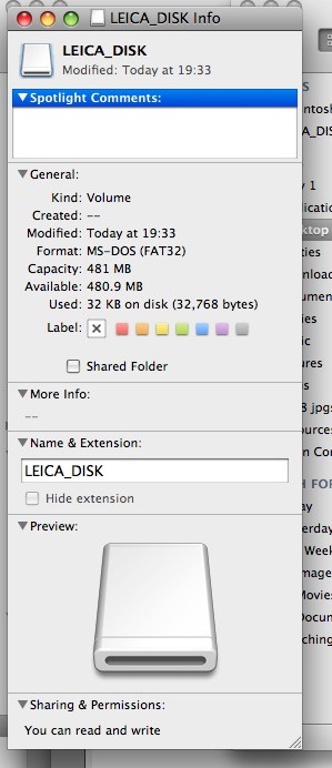

andybarton Posted March 23, 2008 Share #7 Â Posted March 23, 2008 Advertisement (gone after registration) I have just mounted a card of mine and there is no option to lock the card in software. Â Have you tried formatting the card via the Mac and trying again (this D-Lux 3 card is formated as MS-DOS FAT 16, while my DMR ones are MS-DOS FAT 32, by the looks of it) Link to post Share on other sites More sharing options...

andybarton Posted March 23, 2008 Share #10  Posted March 23, 2008 You should be able to "Read and Write"  Welcome, dear visitor! As registered member you'd see an image here… Simply register for free here – We are always happy to welcome new members! Link to post Share on other sites Simply register for free here – We are always happy to welcome new members! ' data-webShareUrl='https://www.l-camera-forum.com/topic/48736-hlep-message-sd-card-locked-error-message/?do=findComment&comment=518418'>More sharing options...
