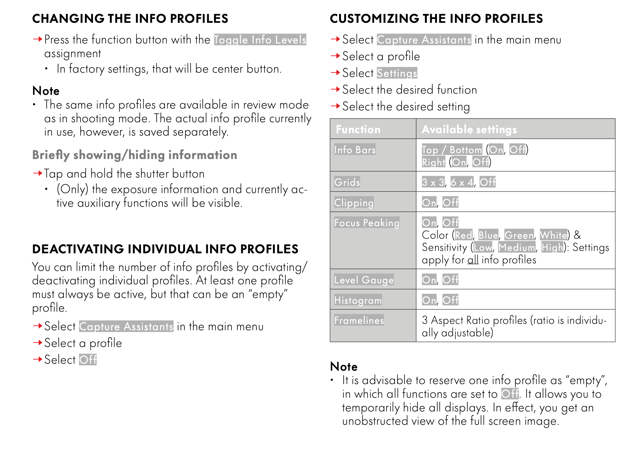

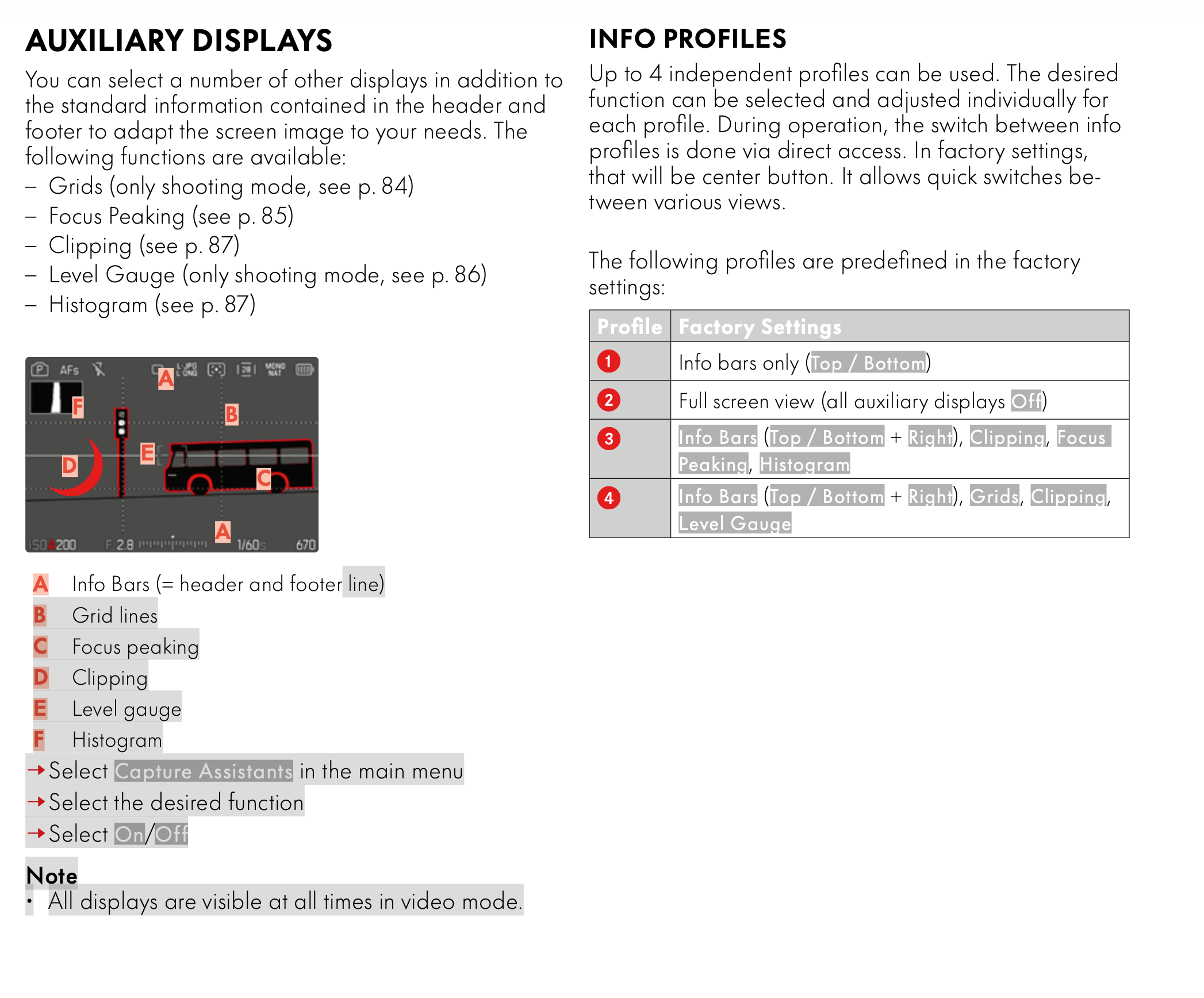

jlnevill Posted 3 hours ago Author Share #5 Posted 3 hours ago All glitch free, although you'll need to re-pair the camera. I just need to get my head around the new menu system....but like the new info bar display changes. 1 Link to post Share on other sites More sharing options...
