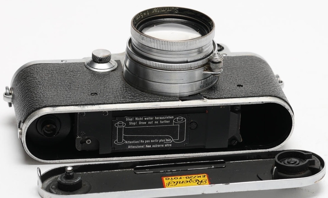

PeLu Posted September 13 Share #1  Posted September 13 Advertisement (gone after registration) I have a question about the marking on this Leica. Serial number checks out correct according to Leica. They Confirm delivery to Berlin early -40 for both lens and body. Not the same year though. But when I look at the markings on top they seam a bit coarser and less delicate that I have seen on similar bodies  the number ”9” in the end of the serial looks smaller than the rest of the numbers  is this beacuase they are marked by hand? Or have they been refilled after someone removed other markings that might have identified them as former ”nazi equipment”. It doesn’t look like someone has scraped or sanded something away either. Welcome, dear visitor! As registered member you'd see an image here… Simply register for free here – We are always happy to welcome new members! Link to post Share on other sites Simply register for free here – We are always happy to welcome new members! ' data-webShareUrl='https://www.l-camera-forum.com/topic/424255-markings-restored-fake-on-wartime-leica/?do=findComment&comment=5862978'>More sharing options...

alphonse2501 Posted September 13 Share #2  Posted September 13 Please send your camera to repairman like Don Goldberg to check the serial numbner beneath of top plate. This is how the S/N looks like in my chromed IIIc K. I think yours is imperfect engraving. Welcome, dear visitor! As registered member you'd see an image here… Simply register for free here – We are always happy to welcome new members! Link to post Share on other sites Simply register for free here – We are always happy to welcome new members! ' data-webShareUrl='https://www.l-camera-forum.com/topic/424255-markings-restored-fake-on-wartime-leica/?do=findComment&comment=5862993'>More sharing options...
Shac Posted September 13 Share #3 Â Posted September 13 what shape is the rangefinder cam - round or triangular? Link to post Share on other sites More sharing options...
johanvo Posted September 13 Share #4  Posted September 13 The serial # is 1942 and looks genuine. Is there a K printed/painted on the shutter screen (sometimes less visible due to wear)?  The easiest way to know if it is a real K (Kaeltefest) camera is to send it for CLA to a reputable repair shop, where they can verify that the shutter has a ball bearing mechanism. Link to post Share on other sites More sharing options...
PeLu Posted September 14 Author Share #5  Posted September 14 Puh,,,, I now have started on a journey that could be quite expensive. However I hope it will be even more rewarding. I won the auction for the camera I was looking at. Regarding the etching on the top I decided it was normal for a Leica during this period (1941). Looking at pictures of other cameras there are slight variations. Letters don’t always look exactly the same. Letter Z in Leitz and the capital L could differ. According to Leica this camera was delivered to Berlin September 29, 1942 (made 1941/42). Lens was also delivered to Berlin March 9, 1940 (made 1939). I also think that if someone would make a false war-time Leica they would also make some kind of military marking. So for now I strongly believe this is genuine. It has obviously ended up in Sweden eventually since the sticker inside the bottom lid is a logo probably from 1950/60. Now I do hope that I didn’t overpay for this. Maybe there will be rainy days where one would need to sell.  Question. Should I have this CLA:d? Would that lower its value if I service and clean it up? I really would like to use it from time to time. Especially the lens since I could use it on my other M-mount cameras. Welcome, dear visitor! As registered member you'd see an image here… Simply register for free here – We are always happy to welcome new members! Link to post Share on other sites Simply register for free here – We are always happy to welcome new members! ' data-webShareUrl='https://www.l-camera-forum.com/topic/424255-markings-restored-fake-on-wartime-leica/?do=findComment&comment=5863471'>More sharing options...
