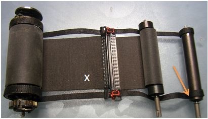

Wcuriosity Posted May 26 Author Share #22 Posted May 26 vor 22 Stunden schrieb TomB_tx: In your picture of the curtain through the back, the bottom of the curtain looks more "slack" than the top. Looks like uneven tension on the curtain ribbons, which males the problem worse towards the top of the picture. This needs more than a brake adjustment to really set it right. You have a very good eye, the curtain is indeed not 100% straight. Thank you for point this out! What do you think the reason could be? Link to post Share on other sites More sharing options...
jerzy Posted May 27 Share #23 Posted May 27 (edited) what Tom noticed is that the closing curtain in lower part is a bit lose. This is how shutter looks like: each curtain has 2 ribbons, they are glued on the other end to the roller. In your case curtain marked x is affected, lower ribbon shall be spanned a bit more and glued again. This is complicated, nothing what you can do at home. It requires complete dismantle of the camera, so full CLA. However I am not sure if this is worth to do. In the situation as it is now slit in lower part is a bit wider than in upper part, frame in lower part will be a bit more exposed than in upper. I do not think that it is noticeable on the picture. The other possibility is that there is some dirt on upper ribbon of the closing curtain and this casues that is is being wound a bit more when the shutter runs. But if you give camera to technician anyhow, let them check it as well. On rare occasions a wrong brake adjustment may cause similar effect Welcome, dear visitor! As registered member you'd see an image here… Simply register for free here – We are always happy to welcome new members! Edited May 27 by jerzy 1 1 Link to post Share on other sites Simply register for free here – We are always happy to welcome new members! ' data-webShareUrl='https://www.l-camera-forum.com/topic/421451-weird-white-bars-on-right-side-of-photos-%E2%80%93-leica-m3-issue/?do=findComment&comment=5807897'>More sharing options...
