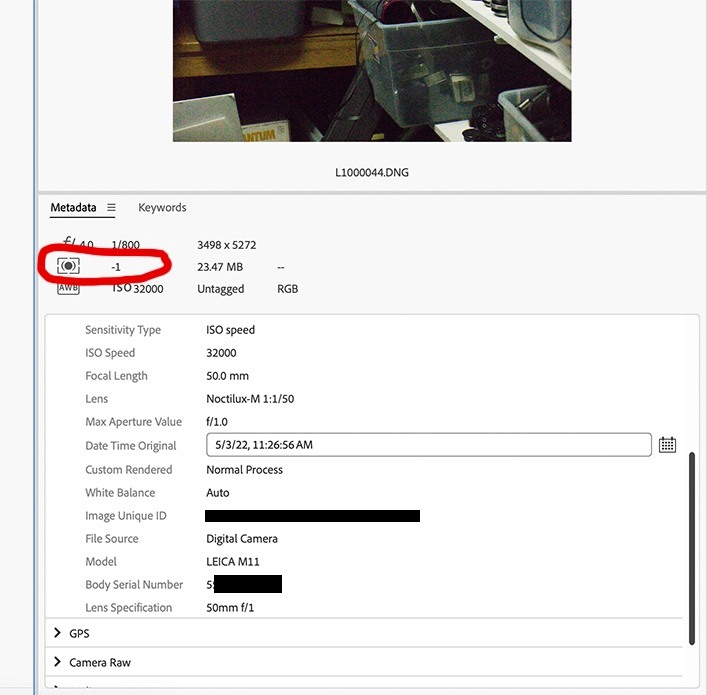

adan Posted October 25, 2024 Share #17 Posted October 25, 2024 Hmmm - my Adobe Camera Raw (16.1.1.1733) shows the M11 Exposure compensation used, right in the top section of the metadata, beside the metering mode icon. (And I don't even use an M11 regularly - this was just a test image with a friend's M11). If there is NO exposure compensation used - it will be blank. And it is from 2022 - maybe the various firmware ugrades since have dropped the EC metadata along the way. But I doubt it. Welcome, dear visitor! As registered member you'd see an image here… Simply register for free here – We are always happy to welcome new members! Link to post Share on other sites Simply register for free here – We are always happy to welcome new members! ' data-webShareUrl='https://www.l-camera-forum.com/topic/414322-lightroom-80-not-showing-accurate-camera-information/?do=findComment&comment=5673938'>More sharing options...
Guest Posted October 25, 2024 Share #18 Posted October 25, 2024 1 hour ago, adan said: Hmmm - my Adobe Camera Raw (16.1.1.1733) shows the M11 Exposure compensation used, right in the top section of the metadata, beside the metering mode icon. (And I don't even use an M11 regularly - this was just a test image with a friend's M11). If there is NO exposure compensation used - it will be blank. And it is from 2022 - maybe the various firmware ugrades since have dropped the EC metadata along the way. But I doubt it. Welcome, dear visitor! As registered member you'd see an image here… Simply register for free here – We are always happy to welcome new members! Lightroom Desktop (that the OP is using) has an extremely limited display of metadata, and the exposure compensation is not available. Like ACR, Lightroom Classic does show the exposure compensation using the "Exposure Bias" field. Link to post Share on other sites More sharing options...
