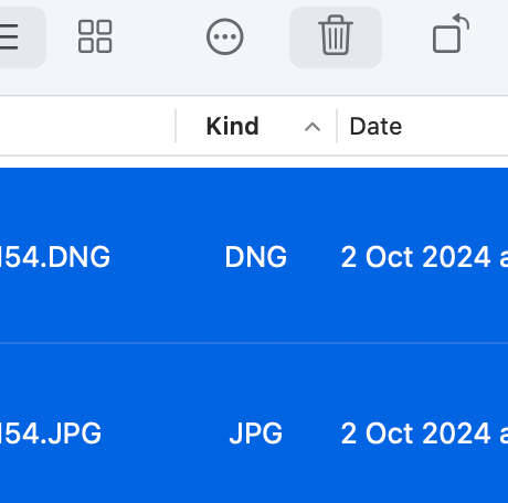

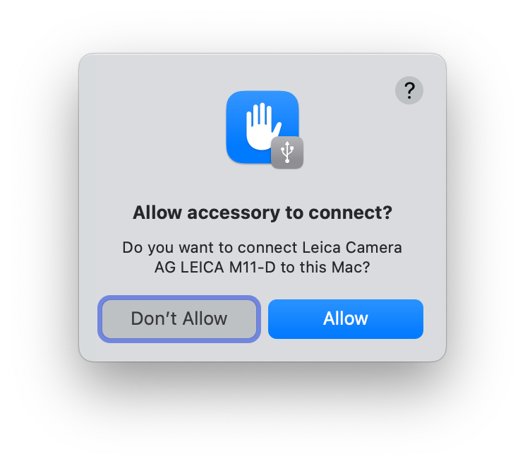

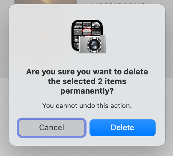

Robert Blanko Posted December 11, 2024 Share #42 Posted December 11, 2024 Am 2.10.2024 um 14:31 schrieb maxpower: I don't think right now it's possible to format, but one method to delete photos from Internal Storage other than the FOTOS app is the following procedure: 1. Connect M11-D with USB-C cable to your Mac (it needs to be in PTP but PTP mode is the default setting, you can check with the function button, 3 clicks to see in the viewfinder what the current mode is) 2. Turn on the M11-D 3. If prompted, allow camera to connect. (see screenshot below) Welcome, dear visitor! As registered member you'd see an image here… Simply register for free here – We are always happy to welcome new members! 4. Open "Image Capture" on your Mac, this application is from Apple and installed by default on every Mac for many years. Depending on language it might have a different name. When opened you should see all photos (note that internal storage and SD storage are shown as one, so you cannot differentiate between internal and SD.) Select photos you want to delete and click the trash can, then confirm deletion. 5. Then you can remove the cable and turn off the M11-D again. Thanks, this works perfectly fine on my Macbook. I could thus delete the photos from the internal memory. Has anyone managed to format the internal memory in the meantime? When connecting to my Macbook I don't see any options to format the internal storage, because it neither appears in the finder nor in the hard drive utility program. The reason why I'm asking is that even though I deleted all photos from the internal memory, the camera shows only 399 shots available which is ridiculous for a 256GB storage (the SD card was removed when deleting and testing). Notably, I deleted about 600 photos of about 75MB each when the camera indicated that the internal memory was full which is not much better. Thus, I'm wondering whether formatting the internal storage would help to increase the usable capacity. I would have expected that it should be sufficient for about more than 3000 photos in full resolution DNG. 🤔🤔 Link to post Share on other sites More sharing options...
