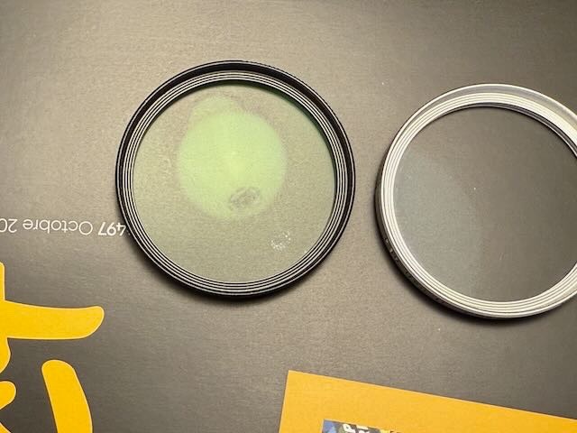

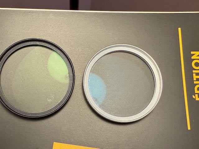

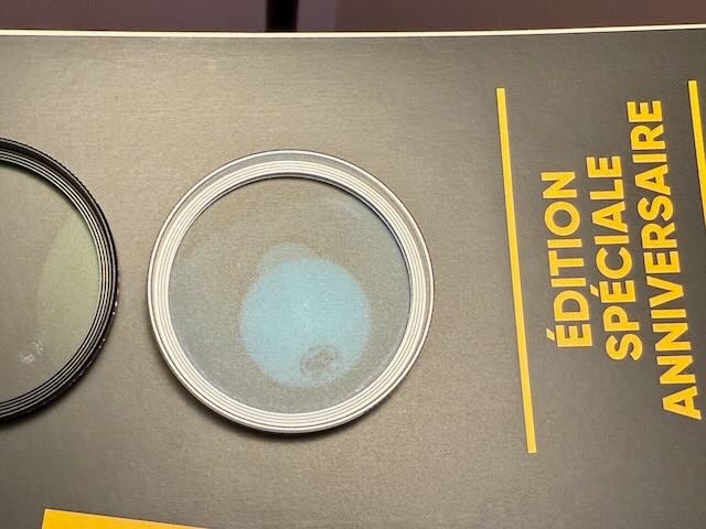

fil-m Posted October 2, 2024 Share #43  Posted October 2, 2024 (edited) 4 hours ago, Crem said: Definitely looking forward to you checking again since you purchased both from an official Leica store. It sounds like you have two Leica filters like I do and they have different tints similar to mine? Do you know the purchase dates? So here we go, and until further notice, I am not crazy, which could be good news  The two Leica (FR) store E39 UVa II filters that I bought display different reflection tints under multiple light sources, and I have tried many back home. The silver one shows a blue sometimes slightly greenish tint, the back filter shows a definite, constant and strong green tint. I bought the black one September 23, and the Silver one February 24 as we can see below (invoices + sample of light reflection). Either their supply chain has been compromised with fakes which is unlikely, or the characteristics have changed. As we are most probably in the second case, the real question is whether this change keeps the filter within Leica's specs in terms of image rendering and neutrality or not. And the second question would be, whether Leica's been made aware (from their filter manufacturer) of this change or not. I know that sometimes they modify the coating during a given lens lifecycle (and people become crazy about a serial number range whose coating is different leading to a magical rendering beyond the realm of the living), but I am not sure if this applies to the filters too  We shall tag them now with serial numbers and hunt the different coatings  Jokes aside, I had tried the black filter with the Omnar ring for my v2 (which looked magnificent!) but noticed the slight vignetting. I will try later the silver one to see if it makes a difference. But I won't do it soon as I mounted back the original ring and I'll be a bit busy until the weekend.  Welcome, dear visitor! As registered member you'd see an image here… Simply register for free here – We are always happy to welcome new members!     Edited October 2, 2024 by fil-m 1 Link to post Share on other sites Simply register for free here – We are always happy to welcome new members!     ' data-webShareUrl='https://www.l-camera-forum.com/topic/410785-for-those-with-35mm-summilux-v2-lenses/?do=findComment&comment=5640109'>More sharing options...

69xchange Posted October 2, 2024 Share #45  Posted October 2, 2024 (edited) 1 hour ago, fil-m said: So here we go, and until further notice, I am not crazy, which could be good news  The two Leica (FR) store E39 UVa II filters that I bought display different reflection tints under multiple light sources, and I have tried many back home. The silver one shows a blue sometimes slightly greenish tint, the back filter shows a definite, constant and strong green tint. I bought the black one September 23, and the Silver one February 24 as we can see below (invoices + sample of light reflection). Either their supply chain has been compromised with fakes which is unlikely, or the characteristics have changed. As we are most probably in the second case, the real question is whether this change keeps the filter within Leica's specs in terms of image rendering and neutrality or not. And the second question would be, whether Leica's been made aware (from their filter manufacturer) of this change or not. I know that sometimes they modify the coating during a given lens lifecycle (and people become crazy about a serial number range whose coating is different leading to a magical rendering beyond the realm of the living), but I am not sure if this applies to the filters too  We shall tag them now with serial numbers and hunt the different coatings  Jokes aside, I had tried the black filter with the Omnar ring for my v2 (which looked magnificent!) but noticed the slight vignetting. I will try later the silver one to see if it makes a difference. But I won't do it soon as I mounted back the original ring and I'll be a bit busy until the weekend.  Welcome, dear visitor! As registered member you'd see an image here… Simply register for free here – We are always happy to welcome new members!     Wow, that reflective coating on the black filter is similar color to the both filters that I purchased of eBay & aliexpress. Do you have a kitchen scale by any chance to weigh and compare the weight of the two filters? Also can you take a picture of the two box’s side by side with the authenticity decal facing up and pointed towards the camera? I want to see if there are any obvious telltales. Edited October 2, 2024 by 69xchange Link to post Share on other sites More sharing options...

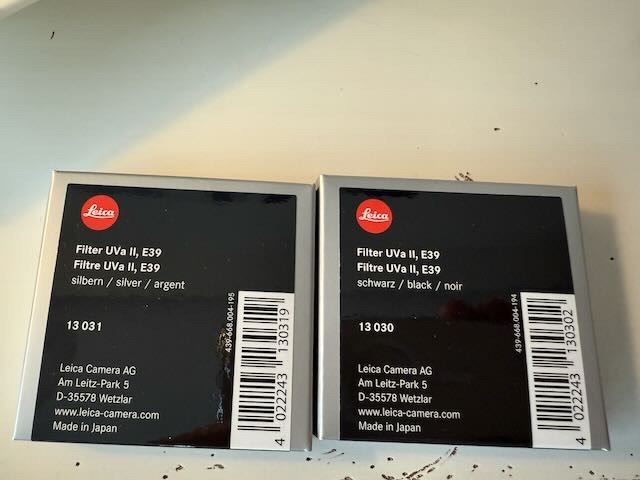

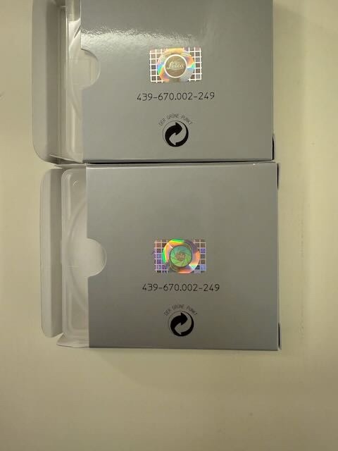

fil-m Posted October 2, 2024 Share #48  Posted October 2, 2024 2 hours ago, 69xchange said: Wow, that reflective coating on the black filter is similar color to the both filters that I purchased of eBay & aliexpress. Do you have a kitchen scale by any chance to weigh and compare the weight of the two filters? Also can you take a picture of the two box’s side by side with the authenticity decal facing up and pointed towards the camera? I want to see if there are any obvious telltales. The two Leica boxes look similar and the authenticity seal similar even if it is hard to make them look alike with my iPhone due to the reflections. Same weight, 7g. No differences except for the tint as shown in my previous snapshots. NB: there is no "white box" for either. Welcome, dear visitor! As registered member you'd see an image here… Simply register for free here – We are always happy to welcome new members!   Link to post Share on other sites Simply register for free here – We are always happy to welcome new members!   ' data-webShareUrl='https://www.l-camera-forum.com/topic/410785-for-those-with-35mm-summilux-v2-lenses/?do=findComment&comment=5640377'>More sharing options...

hdmesa Posted October 2, 2024 Share #50  Posted October 2, 2024 52 minutes ago, fil-m said: The two Leica boxes look similar and the authenticity seal similar even if it is hard to make them look alike with my iPhone due to the reflections. Same weight, 7g. No differences except for the tint as shown in my previous snapshots. NB: there is no "white box" for either. Welcome, dear visitor! As registered member you'd see an image here… Simply register for free here – We are always happy to welcome new members!   Counterfeit Leica filters and other small counterfeit items like Leica M thumb grips come in boxes that look identical down to the holographic sticker — however, there are always slight differences in the fonts and font kerning of the counterfeits. 1 Link to post Share on other sites More sharing options...
