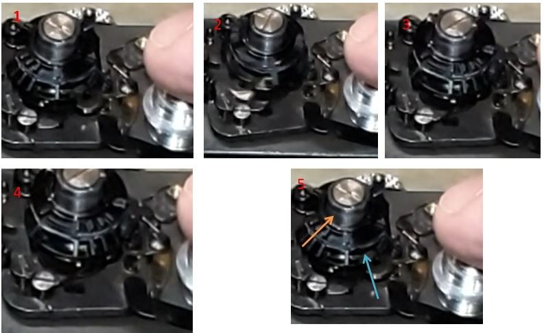

possibly shutter will need to be CLAed again. I sonaooeed few frames from your video showing few steps of shutter run.
1 - speed is set to 1/250 - correct? Release button is pressed, opening curtain will start to run immediately
2 - pawl is being pushed away, shall releease closing curtain but it does bot run
3 - opening curtain is fully opened, but it bounced. you will need to adjust brake, although it will not cure the problem
4 - after some time closing curtain start to run, pawky is returning to home position
This is reconstruction of steps, closing curtain is being hold but we do not know why.
Try following (photo 5): hold shutter with your fingers where the orange arrow shows. Press and keep release, opening curtain shall not run. Release slightly pressure of your fingers allowing opening curtain to rotate slowly, stop at again after the pawl is pushed away. Try to observe what may hold closing curtain. Wait a bit with the shutter in this position and check if closing curtain will start to run after some time. If you want to do further experiments you may take lighter fluid and with syringe inject few drops where blue arrow shows.
But I am afraid that you will need full CLA again, including opening small shutter drums and cleaning the springs inside
I suppose this runs down the shaft into the springs and bearings and loosens old dried lubricant; I did as you said, and then let the camera sit with the shutter spanned over night and in the morning it fired properly instead of catching as usual. Of course this effect would only last until it dries out again but at least it's now clear what needs to be disassembled and cleaned.
lighter fluid went to the upper ball bearing and along the shaft where the middle part of shutter drum (the one where closing curtain is fastened). So these are the places where old lubricant might still be. Shutter springs are within the smaller drums located to the right. They shall be as well opened and springs cleaned and lubricated.

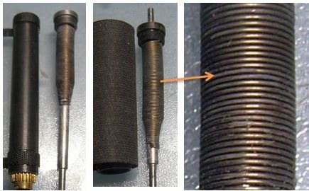

well, this statement wonders me, cleaning and lubricating shutter springs, in my understanding, is part of any regular CLA. Here is example of IIIf red scale, notice white depositis in the spring - this is old, dried lubricant, and some dirt on it. All this needs to be cleaned and lubed again
This picture is helpful because now I understand what they look like inside!  Your explanation makes sense. It seems the drums and therefore also the shutter cloth would need to be taken out in order to do it right, so maybe he tries to avoid that.

it is not required to remove curtains whane you want to open small drums and clean/lube curtain springs. For older svrewmount, pre IIIf red dial, it is sometimes needed to remove one ribbon in order ot open the drum. But the rest (ribbons and curtains) stay as they are and are replaced when rubber detoriates only.
Different story is with the big, main drum - with exception of  very first types of shutter (pre II) you cannot take it apart easily, without special tools, I suppose. But there are no springs  there, it may be cleaned and lubed without taking apart. And the ball bearings are accessible when the shutter is taken out of the crate.

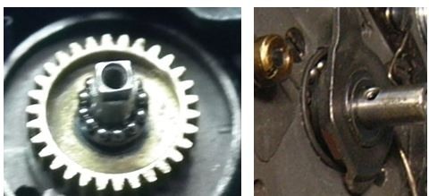

Btw, for ineterst - there are two ball bearings on the main shutter drum, one consists of lose balls (1mm), the other one, in upper part (right on the photo below), has already a sort of cage, and shall be cleaned without taking apart (correct positioning of the parts of cage is critical for proper function of shutter).'
