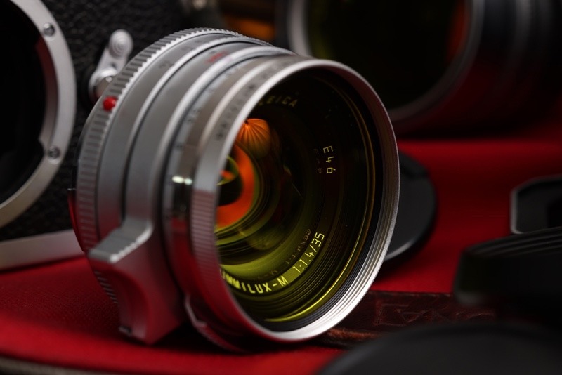

patrickcolpron Posted June 17, 2024 Share #2 Posted June 17, 2024 The only filter I use is a Leica silver chrome E46 filter. I swapped the lens from a black rim Leica E46 yellow filter in it, when shooting black and white. Welcome, dear visitor! As registered member you'd see an image here… Simply register for free here – We are always happy to welcome new members! I prefer using the lens without a filter when using a color Digital M or color film stock and I also prefer using it without a lens hood. 4 Link to post Share on other sites Simply register for free here – We are always happy to welcome new members! I prefer using the lens without a filter when using a color Digital M or color film stock and I also prefer using it without a lens hood. ' data-webShareUrl='https://www.l-camera-forum.com/topic/396344-what-filter-for-35mm-summilux-steel-rim-re-issue/?do=findComment&comment=5363742'>More sharing options...
28framelines Posted August 26, 2024 Author Share #3 Posted August 26, 2024 On 6/17/2024 at 2:44 PM, patrickcolpron said: The only filter I use is a Leica silver chrome E46 filter. I swapped the lens from a black rim Leica E46 yellow filter in it, when shooting black and white. Welcome, dear visitor! As registered member you'd see an image here… Simply register for free here – We are always happy to welcome new members! I prefer using the lens without a filter when using a color Digital M or color film stock and I also prefer using it without a lens hood. Forgot to follow up: do you find this filter causes additional vignetting if you use the updated hood, or flaring if you don’t use the hood? Link to post Share on other sites More sharing options...
patrickcolpron Posted August 26, 2024 Share #4 Posted August 26, 2024 32 minutes ago, 28framelines said: Forgot to follow up: do you find this filter causes additional vignetting if you use the updated hood, or flaring if you don’t use the hood? No added vignetting or flaring with or without the hood. 1 Link to post Share on other sites More sharing options...
