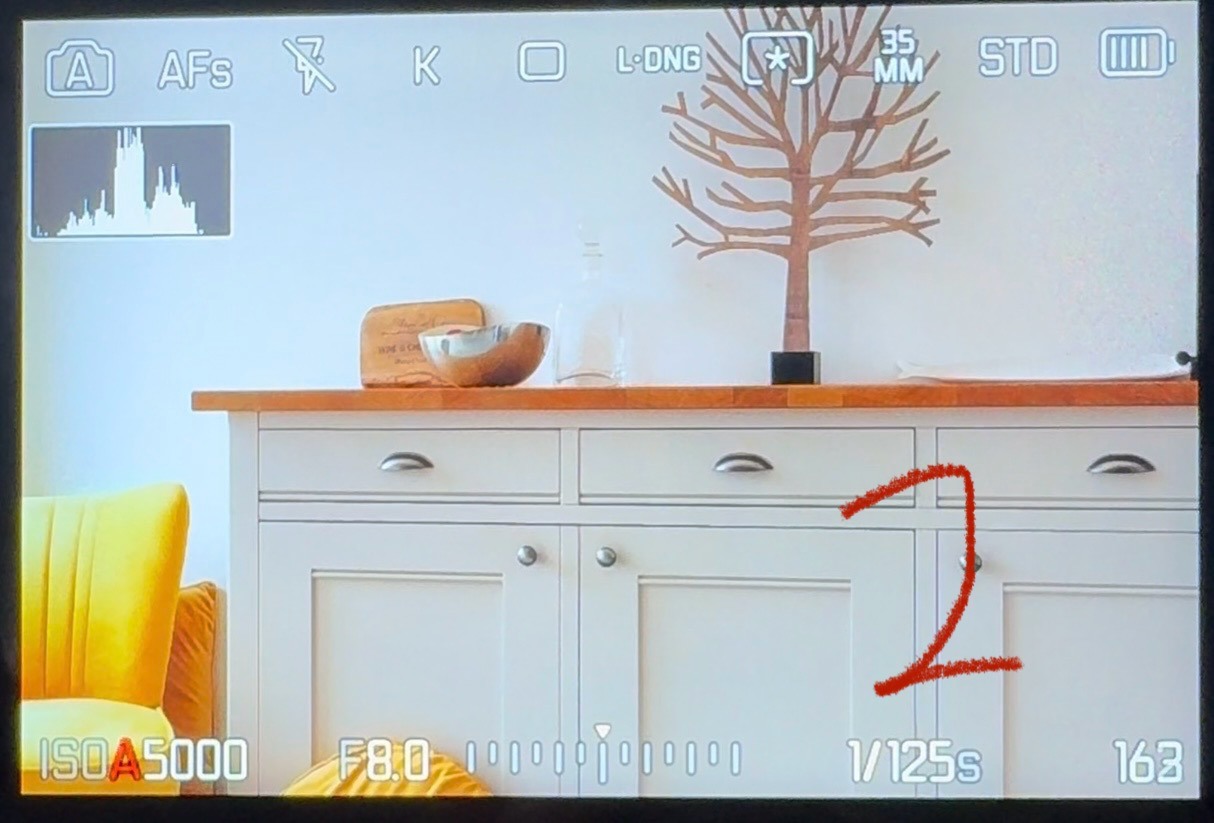

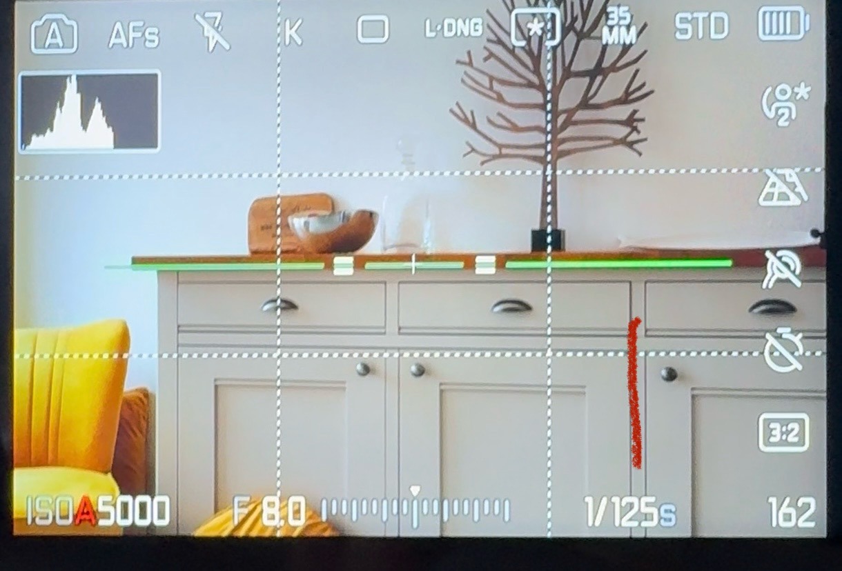

Hi from Europe, I tested a Leica SL3-S in a store and it has exactly the same problem. The images after half-pressing the shutter button are brighter than what I see before half-pressing. This is not how a photographer can work. This is unforgivable for a device costing 5k dollars and more. I have a Sony A1 and I have never had such problems, it is clearly a bug. I tried shooting professional assignments with the SL3 and it was unusable. No matter what I set, nothing helped, not even a factory reset or a fw update. Leica wake up.
