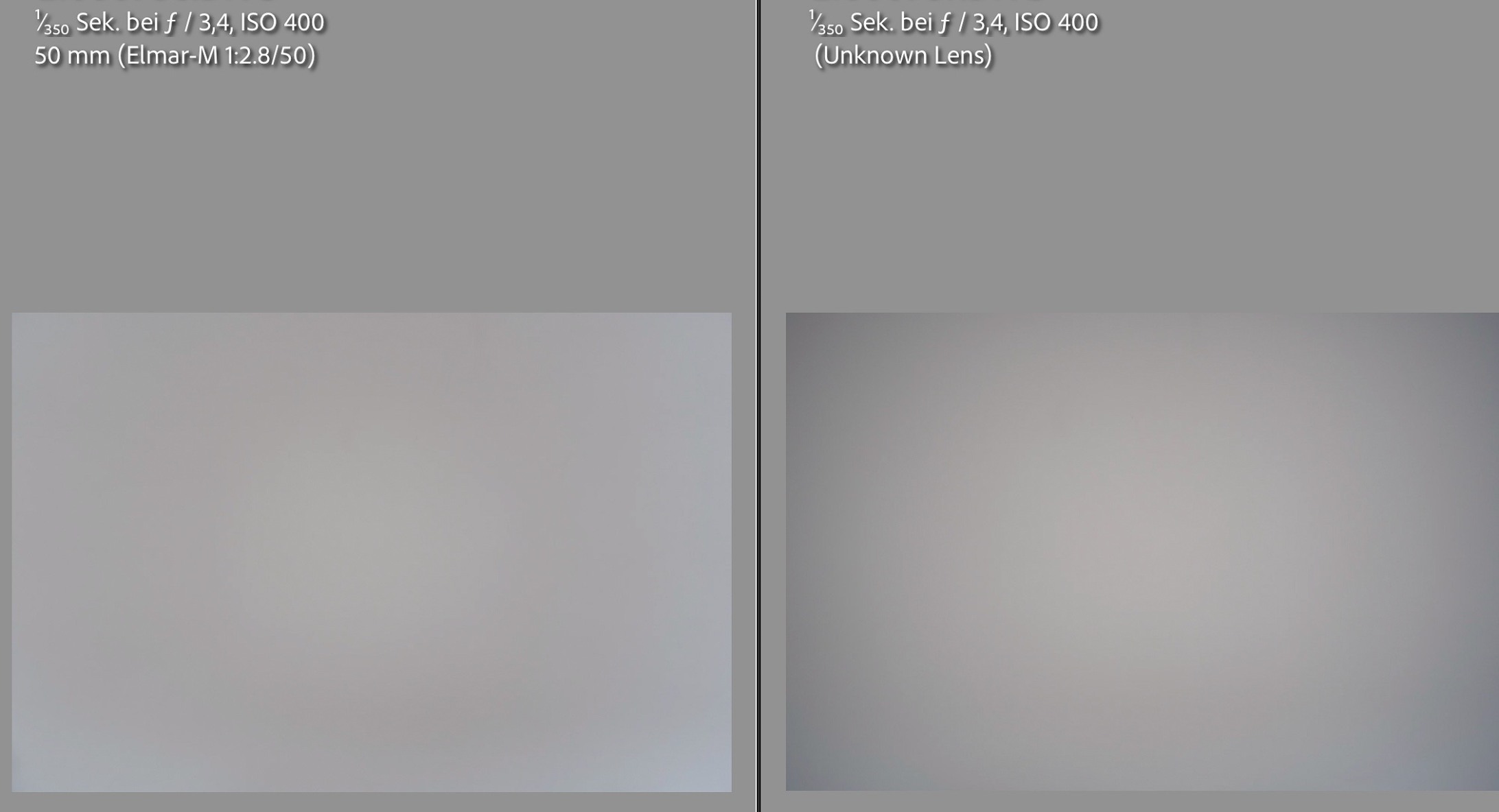

Photoworks Posted March 19, 2024 Share #31 Â Posted March 19, 2024 1 hour ago, hansvons said: If these lenses are from the film era that would be an improvement over the earlier SL models. Good to know. I don't think you get any in-camera correction on older film lenses since they don't have 6Bit coding, if the camera does not recognize the lens it will not apply the effect. I used 28mm Summilux and 50mm, they are both new lenses Link to post Share on other sites More sharing options...
tomasis7 Posted March 19, 2024 Share #32 Â Posted March 19, 2024 you can set a lens manually in the menu. Link to post Share on other sites More sharing options...
Photoworks Posted March 19, 2024 Share #33  Posted March 19, 2024 52 minutes ago, tomasis7 said: you can set a lens manually in the menu. you can and you gain IBIS and Mata data. But none of the lens corrections get applied unless the camera does not recognize the lens itself. Link to post Share on other sites More sharing options...
tomasis7 Posted March 19, 2024 Share #34  Posted March 19, 2024 3 hours ago, Photoworks said: you can and you gain IBIS and Mata data. But none of the lens corrections get aapplied unless the camera does not recognize the lens itself. is that so? it'd be annoying to spend a few hundred quids to get corrections. Grr... A bad move from Leica. Link to post Share on other sites More sharing options...

2M6TTLs Posted March 22, 2024 Share #40  Posted March 22, 2024 On 3/20/2024 at 6:59 AM, tomasis7 said: is that so? it'd be annoying to spend a few hundred quids to get corrections. Grr... A bad move from Leica. Huh? If it already has the data why can't the camera identify the lens and make corrections? Link to post Share on other sites More sharing options...
