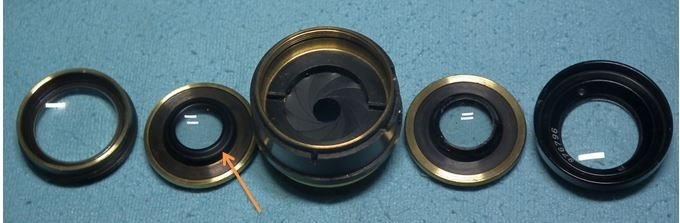

jerzy Posted July 9, 2023 Share #3  Posted July 9, 2023 (edited) here is Summaron with all elements removed. Both lenses before and behind aperture are sitting indeed very firmly. What helps is suction cup, rubber or silicon. You may do it however differently, open the rear of the leans and push, very carefully the second element (or clean affected surface with lens inside). Marked rear element sits as well tight but it has groves (arrow) so it is easier to remove it. Welcome, dear visitor! As registered member you'd see an image here… Simply register for free here – We are always happy to welcome new members! Edited July 9, 2023 by jerzy Link to post Share on other sites Simply register for free here – We are always happy to welcome new members! ' data-webShareUrl='https://www.l-camera-forum.com/topic/379359-summaron-35mm-35-earlier-version-ltm-cladisassembly-help/?do=findComment&comment=4810822'>More sharing options...
Junebat Posted July 10, 2023 Author Share #4  Posted July 10, 2023 7 hours ago, jerzy said: here is Summaron with all elements removed. Both lenses before and behind aperture are sitting indeed very firmly. What helps is suction cup, rubber or silicon. You may do it however differently, open the rear of the leans and push, very carefully the second element (or clean affected surface with lens inside). Marked rear element sits as well tight but it has groves (arrow) so it is easier to remove it. Welcome, dear visitor! As registered member you'd see an image here… Simply register for free here – We are always happy to welcome new members! This is great for reference, thank you! There doesn't seem to be much on disassembling this lens online, so hopefully this thread could come in handy to someone in the future. I did end up getting in finally through that exact element on the back, which was the one I was struggling with, but the grooves helped a lot! I created this little loop out of malleable wire and gently went around and pulled the element up. That all done, I think I've gone over my head with other stuff on this lens, so I'll probably have to send it away anyway lol. A bummer but c'est la vie. Link to post Share on other sites More sharing options...
