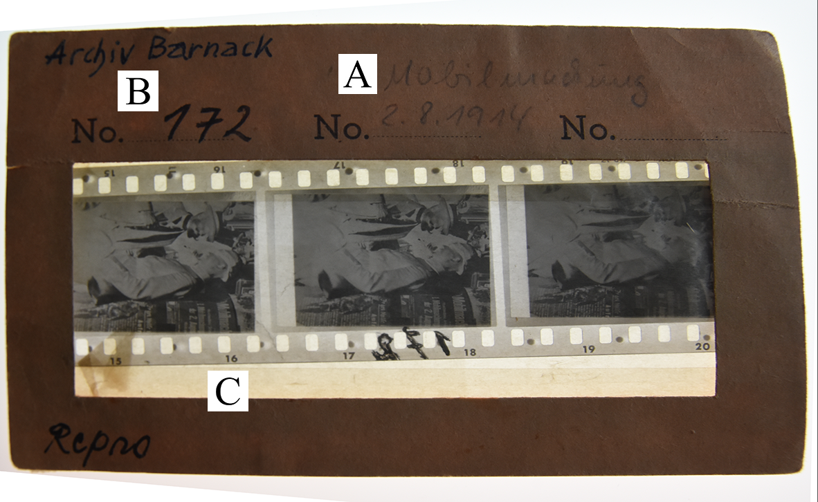

Roland Zwiers Posted June 27 Author Share #761 Posted June 27 Advertisement (gone after registration) Another later copy of a 1917 negative In this filmstrip we see the same negative copied twice, at two different densities. At A we see the date 1914, but I hesitate if this is correct. It may well be 1917 in the Black Forest. B-B-B-B suggests that the original negatives were situated well within the perforations, but this was not the case. So this suggests that the copied negatives are slightly reduced in size. We can observe the familiar C-C-C-C dimensions discussed before. I forgot to use the D. This was reserved for the wide spaces in between the negatives. At E we can see that the negatives have been copied at Agfa Isopan F film. This film must have been introduced in the 1930s. To be continued! Roland Welcome, dear visitor! As registered member you'd see an image here… Simply register for free here – We are always happy to welcome new members! 1 1 Link to post Share on other sites Simply register for free here – We are always happy to welcome new members! ' data-webShareUrl='https://www.l-camera-forum.com/topic/378437-100-years-null-serie/?do=findComment&comment=5824602'>More sharing options...

BernardC Posted June 27 Share #762 Posted June 27 One thing to note is that if the earlier negs are copies, they would have likely been done via an inter-positive, or via a paper print. The "ISOPAN F" negs shown above are obviously copies of a positive, or else the edge lettering would be inverted (clear on black). This doesn't add much to the conversation, because inter-negatives and inter-positive would have been common in the German cinema industry in the 1920s. Inter-positives are struck for editing and for release prints, and inter-negatives are used for any film that is widely distributed (because original camera negatives aren't sturdy enough to be copied hundreds of times). 1 Link to post Share on other sites More sharing options...
SpotmaticSP Posted June 27 Share #763 Posted June 27 Roland, you already noticed that some boundaries between negatives are not sharp. I'm almost sure that this is caused by using a film without anti-halation layer. Link to post Share on other sites More sharing options...
Roland Zwiers Posted June 27 Author Share #764 Posted June 27 BernardC and SpotmaticSP, Thank you for your replies! In the 1910s and 1920s there were indeed many types of perforated 35mm fim for the cinema industry. The 35mm cine negative film (suitable for Leica photography) was just one type. The production of films for copying was much bigger as hundreds of cinemas would require a cine positive copy from one and the same cine negative film. I am not sure why some negatives have unsharp bounderies. All suggestions are welcome! It may also be a feature of the prototype camera in use. Or even a feature of the copying set-up. Note that pictures that we can identify as being 1914 pictures, usually sink through the perforations. So this may be a feature of the Ur-Leica. With 1917 Oskar Barnack pictures the images are exactly within the perforations. This may indicate that in 1917 Barnack was using an improved prototype. In a later slide I will include information about German DIN-norms as to the perforation of cine negative and cine positive film. In Germany in the period 1914-1926 DIN-norms were more important that the international standards set by Bell & Howell. Roland 1 Link to post Share on other sites More sharing options...
