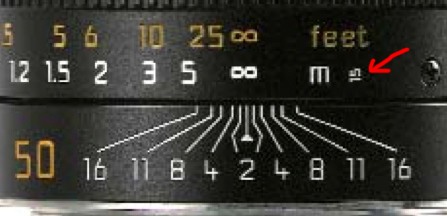

adan Posted August 16, 2022 Share #10  Posted August 16, 2022 On 8/14/2022 at 9:47 AM, edenl said: it is my observation that the blades do go few degrees hidden from just a bit protruding at the widest stop. Will it result in a slight change of imaging since the blades are not fully concealed at f 1.4 1) Leica often slightly overdesigns the diameter of their glass, and then adjusts the aperture blades to accurately produce "f/1.4" or whatever, in each individual lens made. I suspect this is because there are always slight variations in true focal length (51mm, 51.2mm, 51.5mm, 51.6mm, etc. - see the tiny sideways numbers next to the m symbol on your focusing ring). Welcome, dear visitor! As registered member you'd see an image here… Simply register for free here – We are always happy to welcome new members! For which Leica then corrects the aperture diameter (51mm/1.4 = 36.428mm opening, 51.6mm/1.4 = 36.857mm opening), and also the focusing cam. So that is normal. 2) The protruding blades may change the shape of out-of-focus blur-circles ("bokeh balls"), very slightly, to polygons. That will depend on a lot of things - contrast of the blur edge (intense bright pin-point lights out-of-focus vs. low-contrast midtone blurs or large lights), focused distance, background distance. 1 1 Link to post Share on other sites Simply register for free here – We are always happy to welcome new members! For which Leica then corrects the aperture diameter (51mm/1.4 = 36.428mm opening, 51.6mm/1.4 = 36.857mm opening), and also the focusing cam. So that is normal. 2) The protruding blades may change the shape of out-of-focus blur-circles ("bokeh balls"), very slightly, to polygons. That will depend on a lot of things - contrast of the blur edge (intense bright pin-point lights out-of-focus vs. low-contrast midtone blurs or large lights), focused distance, background distance. ' data-webShareUrl='https://www.l-camera-forum.com/topic/335551-new-lens-doesnt-stop-at-the-biggest-f/?do=findComment&comment=4490468'>More sharing options...
Siriusone59 Posted August 16, 2022 Share #11  Posted August 16, 2022 4 hours ago, adan said: 1) Leica often slightly overdesigns the diameter of their glass, and then adjusts the aperture blades to accurately produce "f/1.4" or whatever, in each individual lens made. I suspect this is because there are always slight variations in true focal length (51mm, 51.2mm, 51.5mm, 51.6mm, etc. - see the tiny sideways numbers next to the m symbol on your focusing ring). Welcome, dear visitor! As registered member you'd see an image here… Simply register for free here – We are always happy to welcome new members! For which Leica then corrects the aperture diameter (51mm/1.4 = 36.428mm opening, 51.6mm/1.4 = 36.857mm opening), and also the focusing cam. So that is normal. 2) The protruding blades may change the shape of out-of-focus blur-circles ("bokeh balls"), very slightly, to polygons. That will depend on a lot of things - contrast of the blur edge (intense bright pin-point lights out-of-focus vs. low-contrast midtone blurs or large lights), focused distance, background distance. Thanks for posting this info, adan.  I've wondered why my 50 cron had a sideways 22 past the m. Link to post Share on other sites More sharing options...
