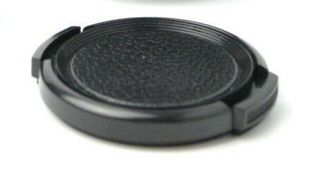

pippy Posted February 23, 2022 Share #4  Posted February 23, 2022 (edited) 1 hour ago, Braaamer said: ...would it be possible and practical to just get a 39 mm snap-on lens cap to snap into the filter thread of the filter? Or in case the filter is not mounted, snap that into the filter thread on the lens directly?... Having just tried this out with my v4 50mm Summicron this is what I discovered; The typical 39mm twin-clip 'unbranded' plastic caps Leica used will fit onto an e39 thread filter-ring inside the 12585. However when there is no filter on the lens the filter thread of the lens sits too low down inside the throat / clip-part of the 12585 for me to be able to operate the cap's clips as the distance between the inner edge of the hood and the outer edges of the cap do not leave quite enough space for my fingertips to push the clips to allow fitment of the cap. It works with the filter fitted for two reasons (AKAICT); firstly the filter's threads are, subsequently, further forward in the throat of the hood than when the lens is filter-less and secondly the filter-ring of a Leica E39 filter is narrower - in terms of diameter - than is the front of the lens itself leaving more space for adquate fingertip access. It might be that someone with even daintier fingers than myself would be able to manipulate the clips but my own digits are hardly sausage-like... It might also be the case that any generic cinch-clip type cap will work but I don't have any so cannot comment further on that score. Philip. EDIT : This is the type I tried; Welcome, dear visitor! As registered member you'd see an image here… Simply register for free here – We are always happy to welcome new members! Edited February 23, 2022 by pippy Link to post Share on other sites Simply register for free here – We are always happy to welcome new members! ' data-webShareUrl='https://www.l-camera-forum.com/topic/330101-12585-lens-hood-on-summicron-50-with-filter-lens-caps/?do=findComment&comment=4389276'>More sharing options...

pippy Posted February 23, 2022 Share #7  Posted February 23, 2022 Advertisement (gone after registration) 37 minutes ago, Braaamer said: Ah! There are snap-on clips that don’t operate on the outside of the cap’s circumference but on the inside of the front surface. Those might work better. Yes; they might. Unfortunately though, as I mentioned at the end of my earlier post, I don't have any of those (in 39mm fit) here so can't comment with any certainty but as long as the outer edge of the cap can fit inside the 12585's clip they might well be a better option as they may allow for use when no filter is fitted. Good luck! Philip. Link to post Share on other sites More sharing options...
Braaamer Posted February 23, 2022 Author Share #8  Posted February 23, 2022 I just ordered such a snap-on cap. As soon as I have my Summicron 50 back from CLA, I will post how it works - with and without filter. I know one might argue that there is no need for a cap when you have a filter and the hood mounted, but I would prefer it for storage at home or in the camera bag. Link to post Share on other sites More sharing options...
