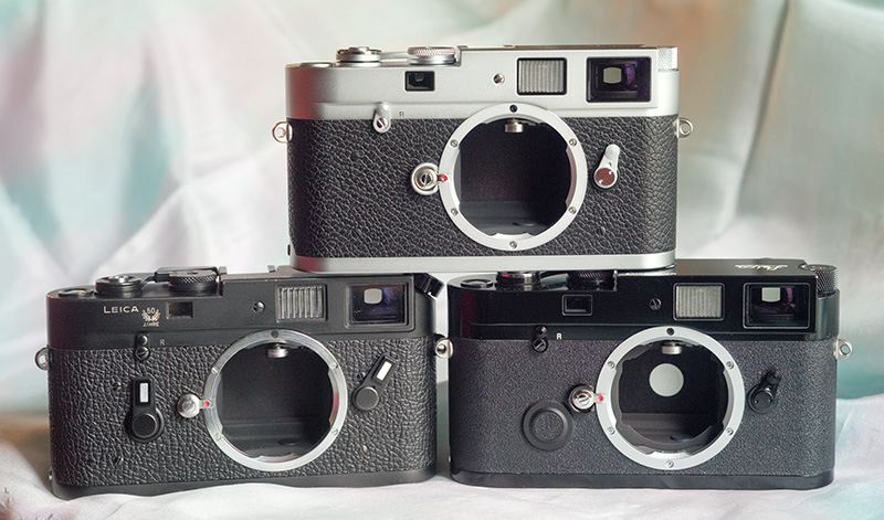

To understand this, we can consider the M's roller position which can be at different a bit from 12:00 (by construction and final adjust from factory).
The coupling ramp of the lens is adjusted for let's admit 12:00 of CLE ( = on the M roller), if you push further the lens, the 12:00 can be 11:50 at the point of contact.
Have a critical look at these three Leica M rollers position, comparing to 12:00 of black screw.
In real life the left M4's is the most adjusted to right (12:10 ?)
