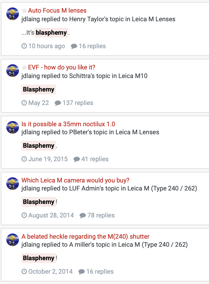

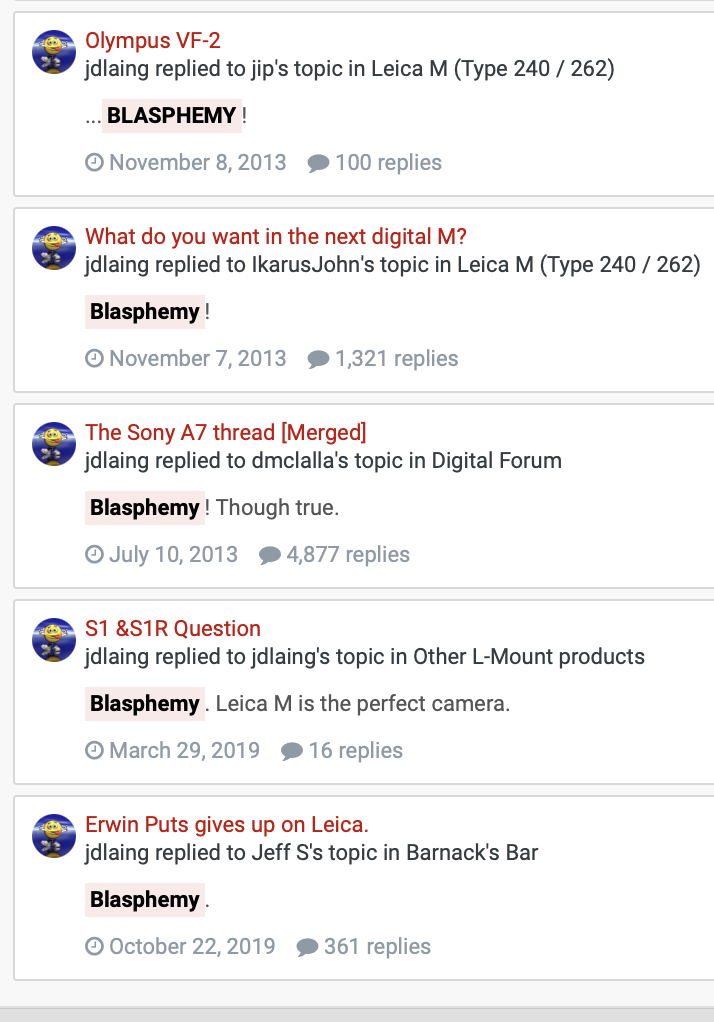

Simone_DF Posted December 1, 2020 Share #18 Posted December 1, 2020 (edited) 10 hours ago, jdlaing said: Me neither. It’s blasphemy. I wonder if there's something you tolerate in this world Welcome, dear visitor! As registered member you'd see an image here… Simply register for free here – We are always happy to welcome new members! Edited December 1, 2020 by Simone_DF 6 Link to post Share on other sites Simply register for free here – We are always happy to welcome new members! ' data-webShareUrl='https://www.l-camera-forum.com/topic/315415-auto-focus-m-lenses/?do=findComment&comment=4090133'>More sharing options...
