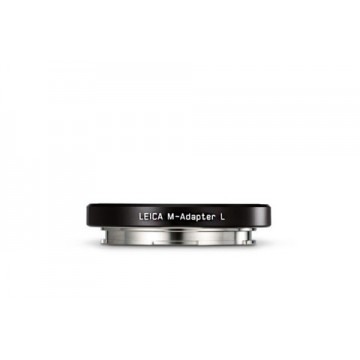

analog-digital Posted January 4, 2020 Author Share #6  Posted January 4, 2020 (edited) vor 47 Minuten schrieb Macberg: I bought my M to T for 250 Euros (mint condition with original packaging. little bag etc.) instead of paying 380 Euros for the M to L, and it works perfectly.  This one cost approx € 420.- With the M-Adapter L, you have over 20 of the legendary M lenses at your disposal. The adapter fully supports functions such as exposure metering, automatic timer and manual control.  Welcome, dear visitor! As registered member you'd see an image here… Simply register for free here – We are always happy to welcome new members!      This cost approx € 750.- With the R-adapter L you can use your flawlessly ground and high-quality coated R-lenses. You benefit from the current technology of the Leica SL and achieve new top performances.  Edited January 4, 2020 by analog-digital Link to post Share on other sites Simply register for free here – We are always happy to welcome new members!      This cost approx € 750.- With the R-adapter L you can use your flawlessly ground and high-quality coated R-lenses. You benefit from the current technology of the Leica SL and achieve new top performances.  ' data-webShareUrl='https://www.l-camera-forum.com/topic/305009-adapter-again/?do=findComment&comment=3884706'>More sharing options...
Macberg Posted January 4, 2020 Share #7  Posted January 4, 2020 (edited) Advertisement (gone after registration) vor 11 Minuten schrieb analog-digital:  This one cost approx € 420.- With the M-Adapter L, you have over 20 of the legendary M lenses at your disposal. The adapter fully supports functions such as exposure metering, automatic timer and manual control.  Welcome, dear visitor! As registered member you'd see an image here… Simply register for free here – We are always happy to welcome new members!   I know. So it seems like the M-Adapter L is even more expensive in Switzerland, which is one more good reason for trying to find a used M-Adapter T which is identical (identical in every detail and function except for the letter "T" instead of "L") to the M-Adapter L. The M-Adapter T also "fully supports functions such as exposure metering, automatic timer and manual control". Of course this is only partly a solution for your problem (as it is only for your M-Lenses). Edited January 4, 2020 by Macberg Link to post Share on other sites More sharing options...
