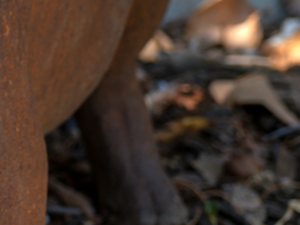

Jared Posted August 27, 2019 Share #21 Posted August 27, 2019 Advertisement (gone after registration) OK, now here is a 100% crop from the rear leg area of the right-hand piggy. I have added back 0.7EV of exposure (as well as the 100% shadows adjustment already mentioned). This will, of course, exaggerate the effect somewhat, but again it gives you a good idea of the limitations as you near the camera's noise floor. This is the ISO 100 shot. We don't generally think of ISO 100 shots as having any noise or grain, but if you push the files very hard they definitely do. Welcome, dear visitor! As registered member you'd see an image here… Simply register for free here – We are always happy to welcome new members! Link to post Share on other sites Simply register for free here – We are always happy to welcome new members! ' data-webShareUrl='https://www.l-camera-forum.com/topic/300615-q2-iso-50-broken/?do=findComment&comment=3806882'>More sharing options...
