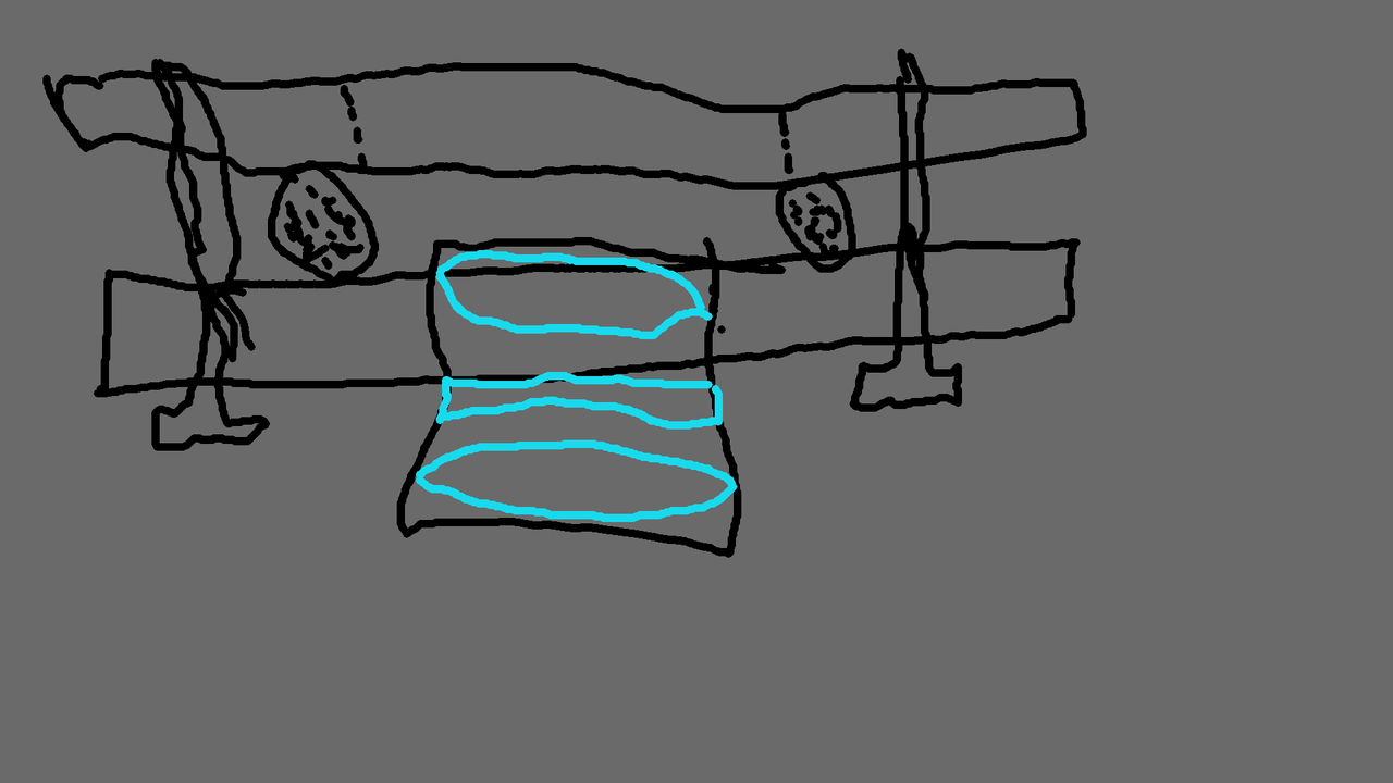

logan2z Posted December 30, 2018 Author Share #7  Posted December 30, 2018 Advertisement (gone after registration) 1 hour ago, semi-ambivalent said: http://fpointinc.com/glass.htm http://www.conradhoffman.com/beseler01.htm I can also vouch for the laser alignment tool by Versalab but don't know if they're still in business. Get an ANR negative holder; you won't regret it. I made a lens holder by taking a piece of aluminum the same size as my 23CII-XL takes, had a large hole drilled in its center and then drilled three holes in both in a tripod arrangement for three small bolts to adjust the two plates against each other. spacing was maintained with a ring of black foam. A 30 second gimp rendered cross section is attached herewith. lower plate can be smaller. I missed my calling. hth Welcome, dear visitor! As registered member you'd see an image here… Simply register for free here – We are always happy to welcome new members! Thanks so much for the links. I believe I've got the enlarger aligned pretty well but I'll use the info you provided to verify it.  FYI, Versalab is alive and well - I recently purchased their print washer. They still manufacturer their laser alignment tool as well. It's a bit pricey but may be worth the investment.  Quote Link to post Share on other sites More sharing options...
