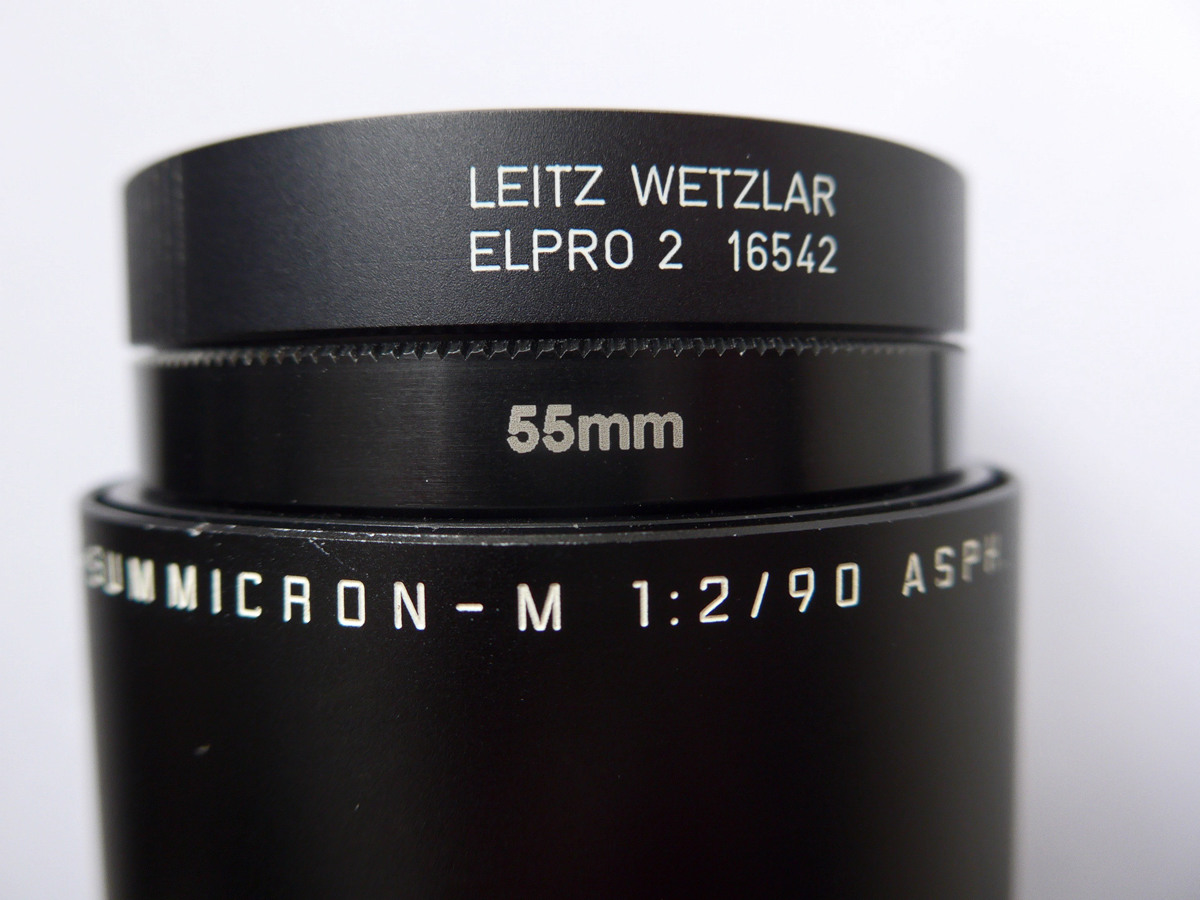

I was curious as to whether my 90/2 APO Summicron M lens (55mm filter thread) would be usable with the older and very reasonably priced Leitz Elpro 1 (2.51 diopter), Elpro 2 (4.92 diopter) , Elpro 3 (1.66 diopter) and Elpro 4 (0.75 diopter) achromats … because their diopter strengths are more useful (to me) than the Elpro E52's relatively high 7 diopter power. I have no plans to buy the E52 Elpro … it's too powerful for my needs. If I require circa 7 diopter strength this can be achieved by stacking the Elpro 2 and Elpro 1 together … combined power 7.43 diopters. Any of the older Leitz Elpro achromats can be purchased s/h for considerably less that the cost of the E52 Elpro … sometimes just for a few $£€ from some dealers.

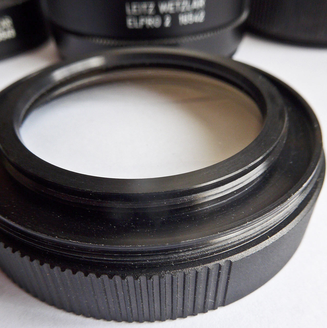

The 90/2 APO Summicron M has a noticeably bulbous, convex front element. The Elpro 1 and Elpro 2 both have dual thread mounts i.e. M55 and Leitz Series VI ... latter being 44mm and 'protruding' behind the 55mm thread.
To illustrate Elpro 2 dual thread mount and resultant protruding rear element
Due to the protrusion the Elpro's rear element hits the 90mm APO Summicron's front element. However, this can be avoided by use of a 55mm spacer ring
To illustrate use of the 55mm spacer ring to prevent contact between the Elpro 2 and 90 Summicron M front element

My Elpro 3 and Elpro 4 c/u lenses do not have the dual thread - they have a single 55mm thread - but their rear elements 'just' make contact with the 90mm APO Summicron front element … so will be also used with the spacer ring.
