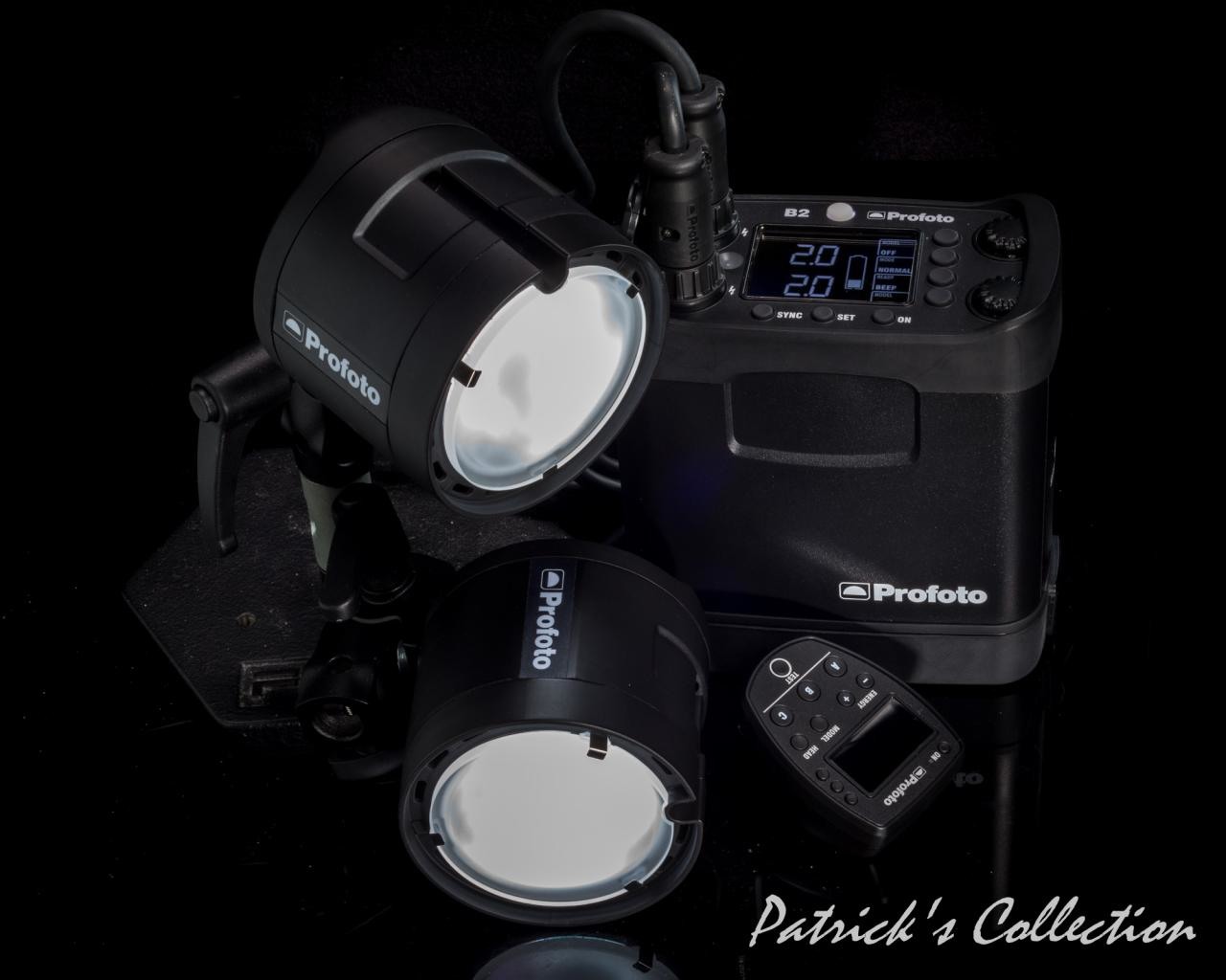

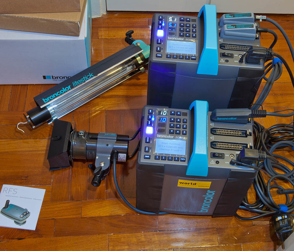

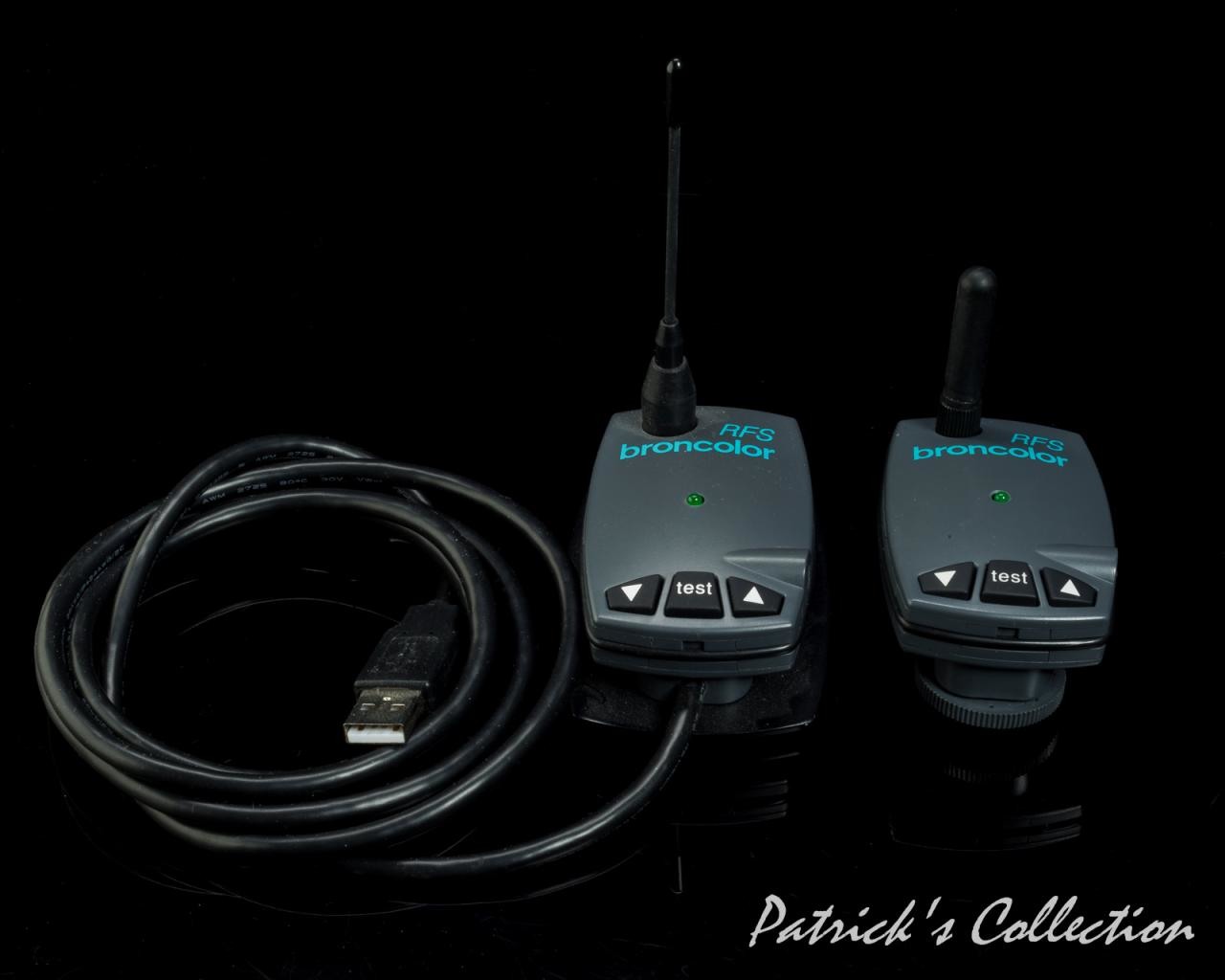

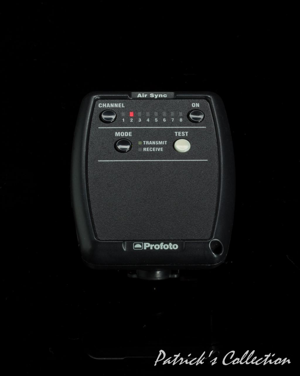

I can use Profoto Air Sync on my SL for wireless trigger of any Profoto flash, I am using AcuteB2 600 AirS and B2; I can also use Broncolor RFS on my SL for wireless trigger of my Broncolor flashes, and I am using Scoro A4S and A2S.
However, both Profoto Air Sync and Broncolor RFS have no TTL function .............
The Profoto Air remote (not the TTl-versions) also works fine with the SL.
