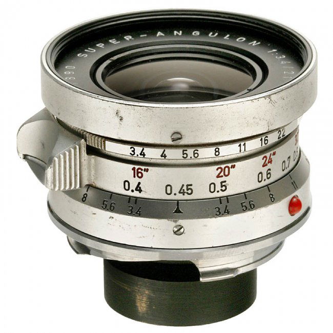

the warrior Posted April 24, 2016 Share #1  Posted April 24, 2016 Advertisement (gone after registration) I have a 21mm ASPH elmarit, I'm happy with, but I'm tempted to look retro, I like the retro look of old lenses ASPH seems very hard and lacking the Leica 3D.My cameras with the M3, the MP and MMonochrom.I do not mind the lack of measurement ttl, I use the M3 and I have no problems with light.Vignetting in the corners say it's a problem, I do not think it's very serious.But I would like to hear from you who own this lens for street photography.  I had read some reviews of this lens over the network, but seek opinions of people who use it on the street.I do not care compared to other lenses of any kind, only interests me opinióin this goal if possible.How many of you use it every day ?.I've seen photographs of great quality and use all your life or much and I have seen your photos, this 21mm lens generally must know him well, but offers very interesting things.I'm thinking of changing my 21mm Elmarit ASPH ASPH by the Super-anbgulon, I'm crazy or not ?.I use a UV filter always scratched to lower contrast and sharpness in the film and the MMonochrom, I like much more so, I wonder if this is going to get the Super-Angulon 21mm f4 .......Greetings.  21mm Elmarit ASPH - MMonochrom CCD - Screatched UV Filter - f4  Link to post Share on other sites More sharing options...

adan Posted April 24, 2016 Share #3  Posted April 24, 2016 The 21mm f/4 Super-Angulon was adequate, but quickly replaced (in Leica years ) by the f/3.4, which is noticeably crisper. But if you scratch your filters anyway - it'll be more than fine.  It is virtually unusable (as is the 3.4) on color full-frame digital Ms, due to the short back-focus (rear element nearly touching the shutter), which creates a nasty purple/red stain around the edges of the picture ("italian flag syndrome"). Except for B&W conversions. On the cameras you list (film and the Monochrom), it will work as well as it ever did. Also may work on the M8 (which crops off the area where the stain occurs).  Leica also warns about using the SA lenses on digital, due to the narrow clearance between the lens and shutter (digital M shutters are "fatter" than the cloth film shutters). - so try with care on the Monochrom, just to be safe.  Both the Super-Angulons will block the metering on an MP or Monochrom - you'll need to use a hand meter, or guess the exposures.  One plus - they focus (by scale, not by using the rangefinder) down to 40 cm or so. Quite a bit tighter than the Elmarits. See attached image.  Be aware there is a "21mm f/4 Super-Angulon" built for the Leica SLRs - totally different lens, needs adapter for M use, no RF focusing, BIG! Don't confuse them!  21 f/4 for M - http://www.mir.com.my/rb/photography/companies/nikon/nikkoresources/RF-Nikkor/Leica_RF/leica_sm_21_1646612_1.jpg  21 f/4 for Leicaflex/Leica R: http://www.l-camera-forum.com/leica-wiki.en/images/thumb/6/64/R-21f4.jpg/250px-R-21f4.jpg  21 f/3.4 for M (also retro-looking) - https://p2.liveauctioneers.com/364/60019/29643695_1_l.jpg  In my film days, I used the 21 f/3.4 SA for a while - ultimately just too slow an aperture for me.  21mm f/3.4 @ 0.4m, Leica M4-2, Velvia 50. Welcome, dear visitor! As registered member you'd see an image here… Simply register for free here – We are always happy to welcome new members! Link to post Share on other sites Simply register for free here – We are always happy to welcome new members! ' data-webShareUrl='https://www.l-camera-forum.com/topic/259648-nobody-talks-about-super-angulon-21mm-f4-why/?do=findComment&comment=3032202'>More sharing options...

michaelwj Posted April 24, 2016 Share #6 Â Posted April 24, 2016 I use the 3.4 SA all the time. It's my second favourite lens, behind my 35 lux pre asph (but I only just got the 35, so it is still in its honeymoon period). Never used digital so can't comment. If you haven't already, check out the very long thread on RFF, and a somewhat shorter thread in the historia section here. Loads of examples. But it is not an unsharp lens, the centre is very sharp and the corners very dark. It also has no distortion at all, and can be successfully used for portraits- see Jeanloup Sieff, he used the lens very well. It is defiantly a love or hate lens though. I love it. Â M Link to post Share on other sites More sharing options...

adan Posted April 24, 2016 Share #12  Posted April 24, 2016 Image is by W. Eugene Smith - taken on the New York docks, as people waited for survivors of the sinking of the Andrea Doria in 1956.  Probably with a Canon Serenar and Canon RF camera - if it matters.  BTW, as the name reveals, the Super-Angulon lenses were designed by Schneider-Kreuznach, based on their large-format wideangle designs.  https://upload.wikimedia.org/wikipedia/commons/thumb/8/85/SuperAngulon.png/250px-SuperAngulon.png  E. Leitz/Leica just licenced (bought) the design from them. If you want a Mandler-designed 21, you need the original non-ASPH Elmarit.  But from the point of view of "look," not that big a deal. They are different from each other, but also quite different from Karbe's ASPHs. Link to post Share on other sites More sharing options...
