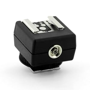

pico Posted July 22, 2014 Share #3 Posted July 22, 2014 Get one of these. (Picture here) which slides into the cold shoe, and a simple flash cord. Quote Link to post Share on other sites More sharing options...
louispreynolds Posted July 22, 2014 Author Share #4 Posted July 22, 2014 Get one of these. (Picture here) which slides into the cold shoe, and a simple flash cord. Okay this sounds good - could you possibly direct me to a shop link, like B&H eg.? But also, is this really the only way i can use ANY FLASH with an auto setting on it? surely there must be a more simple method!! Cheers, Louis Quote Link to post Share on other sites More sharing options...

Fotoklaus Posted July 22, 2014 Share #6 Posted July 22, 2014 Okay this sounds good - could you possibly direct me to a shop link, like B&H eg.? Hama Hot Shoe Adapter 2 - Hot Shoe with PC (Male) Sync HA-6952 But also, is this really the only way i can use ANY FLASH with an auto setting on it? surely there must be a more simple method!! Cheers, Louis What is more simple than that ??? You don´t have wireless flash- control with an M2 ... Quote Link to post Share on other sites More sharing options...

pico Posted July 22, 2014 Share #13 Posted July 22, 2014 (edited) Okay thanks for that, that's great. And this is why I mean, I don't need wireless flash!! I'm happy to use a flash where it only has a sync lead like back in the day! My m2 has a cold shoe, so surely there are flashes with auto mode that connect only via sync lead, and just sit in the cold shoe!? Gee whiz, that's exactly what Fotoklaus pointed out to you. Click on his link and order it. Here it is again: http://www.bhphotovideo.com/c/product/89982-REG/Hama_HA_6952_Hot_Shoe_Adapter_2.html Edited July 22, 2014 by pico Quote Link to post Share on other sites More sharing options...
Fotoklaus Posted July 22, 2014 Share #14 Posted July 22, 2014 Yes, i would prefer this solution, so you can use your Leica- Flash and that´s it. This tiny adapter won´t bother you too much, i think. Quote Link to post Share on other sites More sharing options...
