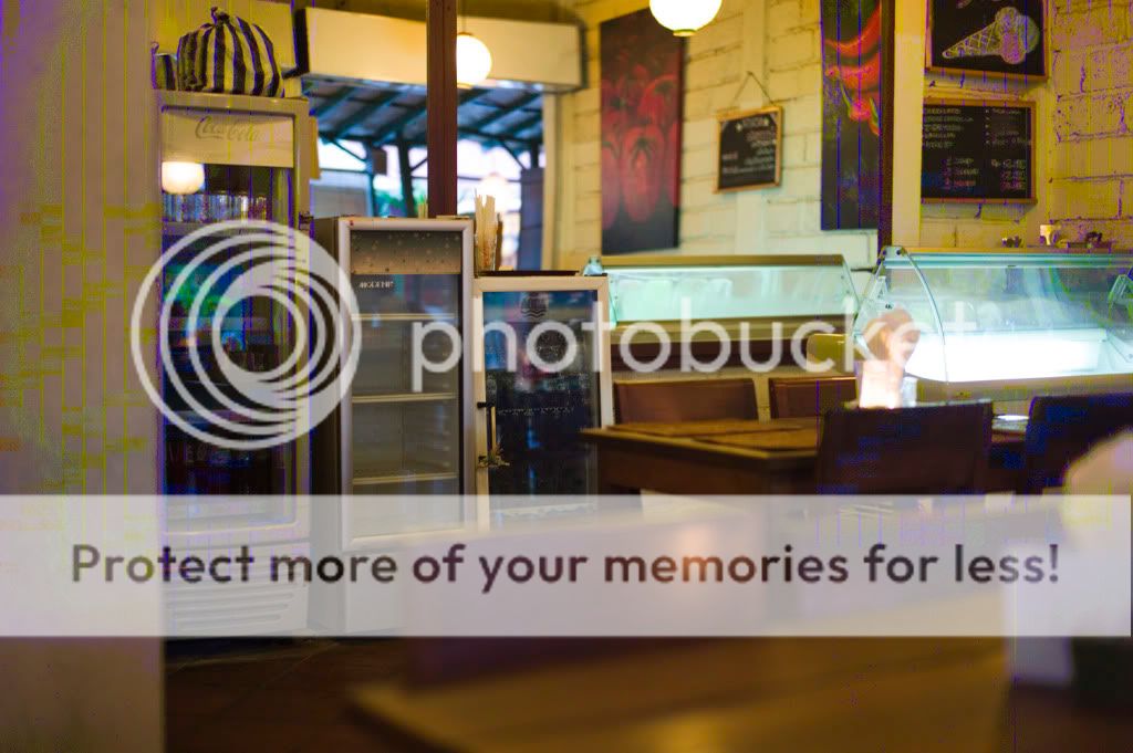

rgp Posted May 28, 2010 Share #35 Posted May 28, 2010 any suggestions as to the large artifact here.... M9 jpeg out of camera, it is not then present on raw dng file (or after processing) camera jpeg error or sensor Welcome, dear visitor! As registered member you'd see an image here… Simply register for free here – We are always happy to welcome new members! Link to post Share on other sites Simply register for free here – We are always happy to welcome new members! ' data-webShareUrl='https://www.l-camera-forum.com/topic/117785-sensor-problem/?do=findComment&comment=1336895'>More sharing options...
jaapv Posted May 28, 2010 Share #36 Posted May 28, 2010 If it is not on the DNG, then it is an error in the JPG processing or a write error on the SD card. Link to post Share on other sites More sharing options...
ho_co Posted May 28, 2010 Share #37 Posted May 28, 2010 Just backing up what Jaap said: As I understand it, the M8 and M9 produce the DNG first, then apparently derive the JPG from it. I would send a copy of the file to Stefan Daniel and let him know that it's on JPG only, not on DNG. There've been several reports of similar problems on DNG, so it might help Leica find the problem if they're aware it can happen this late in the chain. BTW--You're talking about the regular green pattern, right? What's the cause of the red blurring? Is that also part of the effect you're speaking of? I haven't seen anything like that before. Link to post Share on other sites More sharing options...
rgp Posted May 28, 2010 Share #38 Posted May 28, 2010 ho_co, this shot was an accident, it is my blurred hand in front of the lens, should have deleted it, but noticed the green blocks Link to post Share on other sites More sharing options...
Shade Posted May 28, 2010 Author Share #39 Posted May 28, 2010 I just had that green patch thing on my jpeg file.. Good thing it didn't affect the dng as well.. I think this should be a firmware related issue.. I wonder when the next update will be.. Link to post Share on other sites More sharing options...
ho_co Posted May 29, 2010 Share #40 Posted May 29, 2010 ho_co, this shot was an accident, it is my blurred hand in front of the lens, should have deleted it, but noticed the green blocks Good! Now I recognize the hand! I'm glad it wasn't on an otherwise good shot, but I'd send a description and a copy of the file to Stefan Daniel just to be sure Leica gets as much information as possible. There have been a few similar occurrences IIRC; very likely a firmware or timing problem that can be fixed with new firmware once Leica figures out what it is. Link to post Share on other sites More sharing options...
