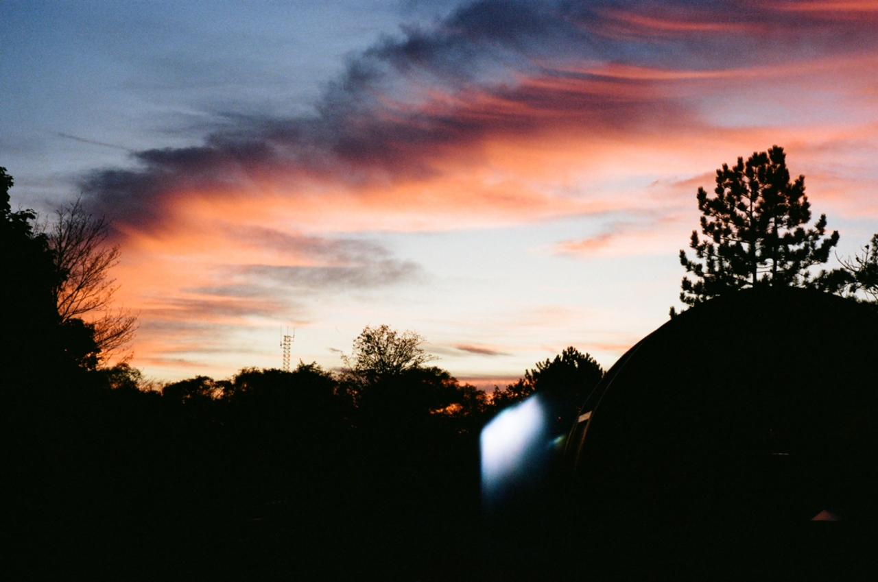

  1. Hello, After saving for a long time I was able to do two things I’ve always wanted: Travel to Japan and buy a Leica M6!! I bought the M6 from a reputable dealer in Tokyo I was told it has just had a CLA. Long story short when I got home the 5 rolls of porta I took had a strange light leak. Not every frame and it moves slightly. It happens mostly mid roll say shots 15-30. I contacted the dealer and they paid to ship it back to Japan. They said they could not find the light leak but replaced all the light seals anyways. They tested it with film and could not duplicate it... I received the camera back and ran a roll though and still have this damn light leak. On thing I can think of is when I sent it to Japan I did not include the strap.... Thanks for reading and any help is appreciated. I’ve been searching for days and have found some info but the threads are old, pictures are no longer uploaded and original posters are not responding. Sorry for the small photos, it’s the only size I could attach. If it helps I can post more/bigger ones from another site.
