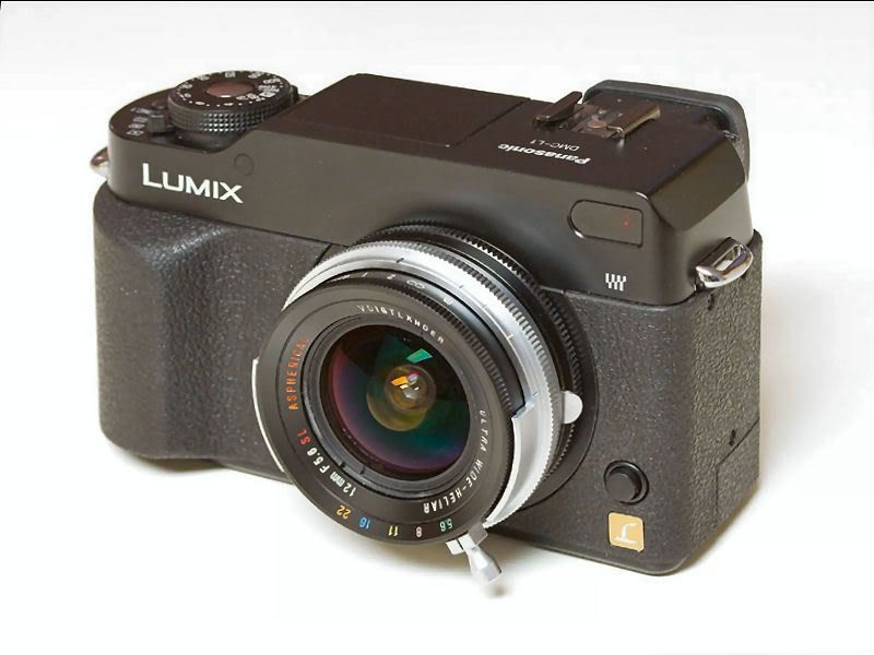

Riley Posted January 13, 2009 Author Share #13 Posted January 13, 2009 Jens, audidudi is not your average user it wont clear the mirror, he does indeed shoot the CV mirror up I believe this is it situated on his L1, and isnt it nice ! Link to post Share on other sites More sharing options...

audidudi Posted January 14, 2009 Share #16 Posted January 14, 2009 I wasn't aware that the L1 could lift the mirror. Or is he doing a trick? There's no trick. I'm using the NLA Nikon F-mount version of the CV 12mm/f5.6 lens. When you engage Live View on the L1, the mirror flips out of the way to expose the sensor. When you fire the shutter, the mirror flips back, makes contact with the lens barrel (but very softly, as there isn't even a mark on it after several hundred exposures), then flips out of the way during the exposure. It's all very Mickey Mouse, but it works well enough and IMO, the results have been worthwhile. FWIW, I also have the 15mm/f4.5 version as well... Link to post Share on other sites More sharing options...
TEBnewyork Posted January 14, 2009 Share #17 Posted January 14, 2009 There's no trick. I'm using the NLA Nikon F-mount version of the CV 12mm/f5.6 lens. When you engage Live View on the L1, the mirror flips out of the way to expose the sensor. When you fire the shutter, the mirror flips back, makes contact with the lens barrel (but very softly, as there isn't even a mark on it after several hundred exposures), then flips out of the way during the exposure. It's all very Mickey Mouse, but it works well enough and IMO, the results have been worthwhile. FWIW, I also have the 15mm/f4.5 version as well... But hasn't Oly done a very good job on their wide zooms and kept them reasonably small? Link to post Share on other sites More sharing options...
audidudi Posted January 14, 2009 Share #18 Posted January 14, 2009 But hasn't Oly done a very good job on their wide zooms and kept them reasonably small? Sure, but they're still orders of magnitude larger than the CV 12mm fixed lens (which was / is an important consideration for me) and at the time I bought the CV 12mm, it was less expensive than either the Oly 7-14 or 11-22, the only two options then available. If you search the archives, you'll find that I never touted this solution as a universal one or even claimed that it made sense, only that it served my particular purposes. As it turned out, though, given that Cameraquest is asking $1300 for its last NOS F-mount CV 12mm, I may have actually made a good investment as well, because that's nearly twice what I paid for mine! Link to post Share on other sites More sharing options...
