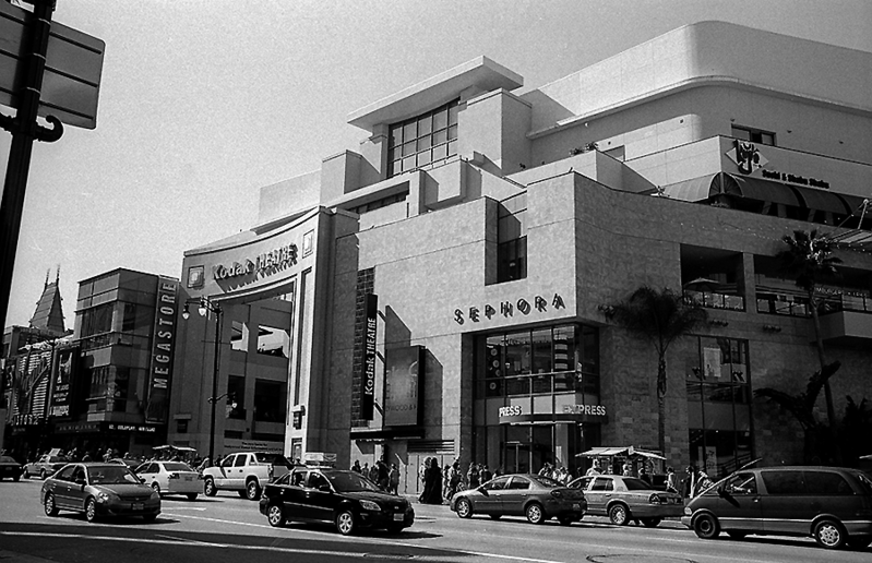

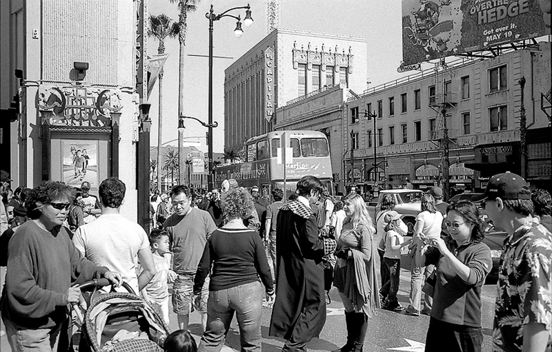

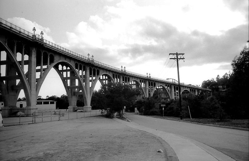

ron110n Posted November 10, 2008 Share #21 Posted November 10, 2008 Advertisement (gone after registration) Catherine, What film? what ISO? What developer? The particular developer has a lot to do in making your image sharp. I also think the grains are too harsh in your sample. The right developer combo can tame that. Try removing your UV filter and see if there's a difference. If there is... $$$Heliopan$$$ can fix that. Here's something who's light condition is very similar to your sample. Below is the softest Elmarit with an "E49" filter thread. I don't think it's that bad at all. M7, Elmarit 28mm f/2.8 (E49), Fomapan 200, Fomadon R09 1:40 dilution, 20C Pasadena Suicide Bridge Below is a classical film emulsion based in a 1952 German Emulsion and Grain standard. M7, Elmarit 28mm f/2.8 (E49), Efke KB100, Fomadon R09 1:40 dilution, 20C Hollyweird CA Here's a 50mm perspective, to compare to a 28mm like you did in your sample. M7, Summilux 50mm asph, Efke KB100, Fomadon R09 1:40 dilution, 20C Hollyweird, CA Try learning to develop your own film. It's easy and you don't need a dark room since you have a scanner. Most of all, it's fun and you have more command to your results. There are a lot of colleagues here at the forum who just recently learned B&W film developing. Now, they are better than us. Look at Rob & Peter, many of their images can smoke ours. Cheers! -Ron -Ron Link to post Share on other sites More sharing options...
