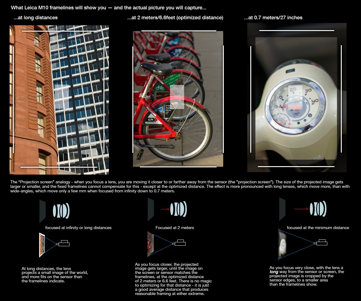

adan Posted July 10 Share #6 Posted July 10 How close is your eye to the eyepiece? It should be as close as possible! Mash the camera into your face. Do you wear eyeglasses that get between your eye and the eyepiece? If anything, Leica M framelines are designed to be a bit narrow for the lens in use (your final picture will include slightly more than the lines indicate). In order to make sure you capture everything the framelines show (tops of heads, etc.) - with an extra margin for aiming error. Welcome, dear visitor! As registered member you'd see an image here… Simply register for free here – We are always happy to welcome new members! Link to post Share on other sites Simply register for free here – We are always happy to welcome new members! ' data-webShareUrl='https://www.l-camera-forum.com/topic/422971-new-rangefinder-user-question-about-frame-lines/?do=findComment&comment=5831401'>More sharing options...

Chris W Posted July 11 Share #8 Posted July 11 I'm usually rammed up to the viewfinder and have no problem seeing 35mm framelines. Also be aware that the framelines are slightly a guide, not 100% accurate. The offset of the two focussing elements means that if you centre your subject, depending on how far away you are, the subject will be slightly off centre in the final image. With practice you will be able to compensate for that while composing in camera. 1 Link to post Share on other sites More sharing options...
