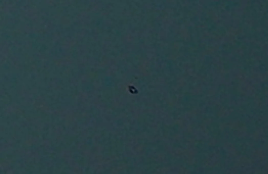

Herman Zhang Posted February 8 Share #1 Posted February 8 Advertisement (gone after registration) I noticed a spot while shooting at f2.8 on a 35mm lens today. It does not seem to be dust, as it is bright in the centre and sharp even when the image is defocused. It is visible at all apertures, and with all lenses that I own(so it is not dust on lens). The sensor is ID11, looks pretty clean under a strong lamp and is claimed to have had the filter replaced by a workshop. I just found today it but it happens to be found in all of my photos in the same spot since I bought it 4 months ago. I suspect that it might be a hot pixel, as allegedly corrosion is only visible at very small apertures (like F/16 or 22). Can anyone tell me what it is, and if it does happen to be a corrosion, can someone tell me which specific filter(which one from Schott) does the M9 originally has (I want the original colour rendering). The other dark dots should be dust on sensor, as it seems to be somewhat defocused Welcome, dear visitor! As registered member you'd see an image here… Simply register for free here – We are always happy to welcome new members! Link to post Share on other sites Simply register for free here – We are always happy to welcome new members! ' data-webShareUrl='https://www.l-camera-forum.com/topic/419129-sensor-corrosion-or-something-else/?do=findComment&comment=5753725'>More sharing options...

irenedp Posted February 8 Share #2 Posted February 8 I would examine the sensor with a magnifier before making any assumptions. Sometimes it might be something else Link to post Share on other sites More sharing options...
mujk Posted February 11 Share #3 Posted February 11 Agree with @irenedp. If i's dust or corrosion you should be able to see it with the loupe, corrosion possibly only at an angle. If it's a hot pixel you should not be able to see it with a loupe. In an image corrosion is actually visible at least until F/8 and sometimes even with bigger apertures. Link to post Share on other sites More sharing options...
Herman Zhang Posted February 11 Author Share #4 Posted February 11 17 minutes ago, mujk said: Agree with @irenedp. If i's dust or corrosion you should be able to see it with the loupe, corrosion possibly only at an angle. If it's a hot pixel you should not be able to see it with a loupe. In an image corrosion is actually visible at least until F/8 and sometimes even with bigger apertures. Mine is visible at all apertures. If it possible that it's a very bad corrosion? Link to post Share on other sites More sharing options...
pedaes Posted February 11 Share #5 Posted February 11 On 2/8/2025 at 4:41 AM, Herman Zhang said: It does not seem to be dust, Give the sensor a clean and if it is still there you will know answer. Link to post Share on other sites More sharing options...
Elliot Harper Posted February 19 Share #6 Posted February 19 Looks like a corrosion to me if it's visible and same shape across all the apertures. Link to post Share on other sites More sharing options...
