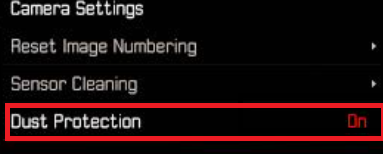

Evan-Liu Posted December 25, 2024 Share #2 Posted December 25, 2024 Would you like to try turning off the dust protection function first? It’s possible that the M11 isn’t recognizing the lens and is closing the shutter for dust protection. Welcome, dear visitor! As registered member you'd see an image here… Simply register for free here – We are always happy to welcome new members! 3 Link to post Share on other sites Simply register for free here – We are always happy to welcome new members! ' data-webShareUrl='https://www.l-camera-forum.com/topic/418134-are-there-any-cases-where-exposure-metering-doesnt-work-with-certain-lenses/?do=findComment&comment=5728440'>More sharing options...
Azure78 Posted December 25, 2024 Author Share #3 Posted December 25, 2024 15 minutes ago, Evan-Liu said: Would you like to try turning off the dust protection function first? It’s possible that the M11 isn’t recognizing the lens and is closing the shutter for dust protection. Welcome, dear visitor! As registered member you'd see an image here… Simply register for free here – We are always happy to welcome new members! Wow thank you so so much. I didn't know this would be a problem. Today is my birthday, and I feel like I got a great birthday present. Thank you. Link to post Share on other sites More sharing options...
