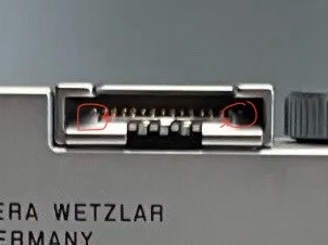

kyono Posted June 6, 2024 Share #2 Posted June 6, 2024 (edited) Oh you had exactly the same experience as me. If you look closely at the inside of your camera's hot shoe, there will be a brass plate like a plate spring at both ends of the shoe. Welcome, dear visitor! As registered member you'd see an image here… Simply register for free here – We are always happy to welcome new members! This is a problem caused by the reduction of tension in the area marked in red. The solution is to restore the tension with something like tweezers (Of course, it can also be solved at the service center.) I also experienced it only 2 months ago, so I hope it helps.(Please understand that I used a translator because I'm a non-English speaker.) Edited June 6, 2024 by kyono 1 Link to post Share on other sites Simply register for free here – We are always happy to welcome new members! This is a problem caused by the reduction of tension in the area marked in red. The solution is to restore the tension with something like tweezers (Of course, it can also be solved at the service center.) I also experienced it only 2 months ago, so I hope it helps.(Please understand that I used a translator because I'm a non-English speaker.) ' data-webShareUrl='https://www.l-camera-forum.com/topic/395665-hotshoe-springs-m11/?do=findComment&comment=5335493'>More sharing options...
nxko Posted June 6, 2024 Author Share #3 Posted June 6, 2024 1 hour ago, kyono said: Oh you had exactly the same experience as me. If you look closely at the inside of your camera's hot shoe, there will be a brass plate like a plate spring at both ends of the shoe. Welcome, dear visitor! As registered member you'd see an image here… Simply register for free here – We are always happy to welcome new members! This is a problem caused by the reduction of tension in the area marked in red. The solution is to restore the tension with something like tweezers (Of course, it can also be solved at the service center.) I also experienced it only 2 months ago, so I hope it helps.(Please understand that I used a translator because I'm a non-English speaker.) Yes, I have adjusted slightly, but not quite there yet. Keeps sliding out. Was just wondering the exact profile of the spring in normal position. Looks like its lower than mine is now. Hm. Thanks anyways! Link to post Share on other sites More sharing options...

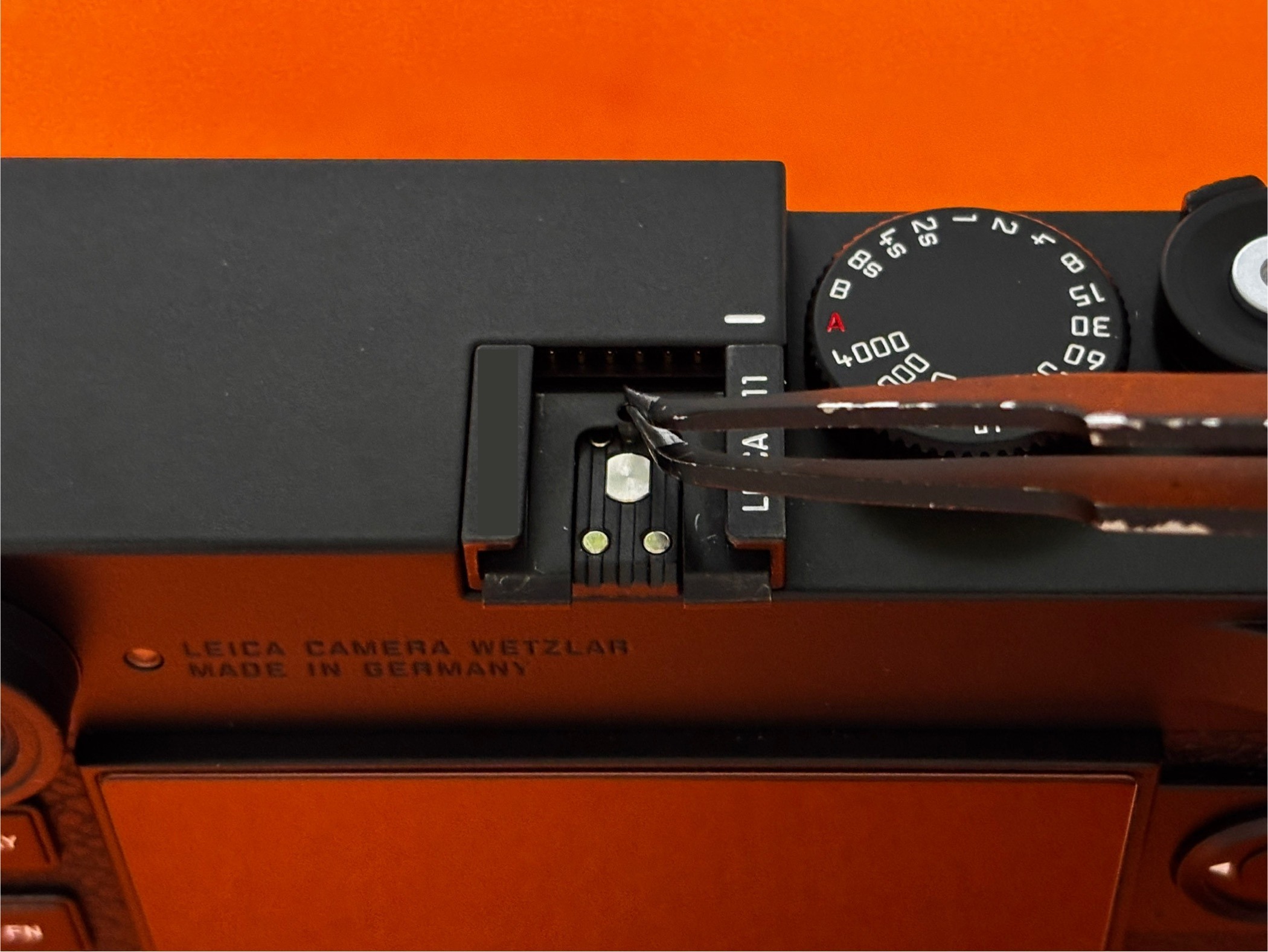

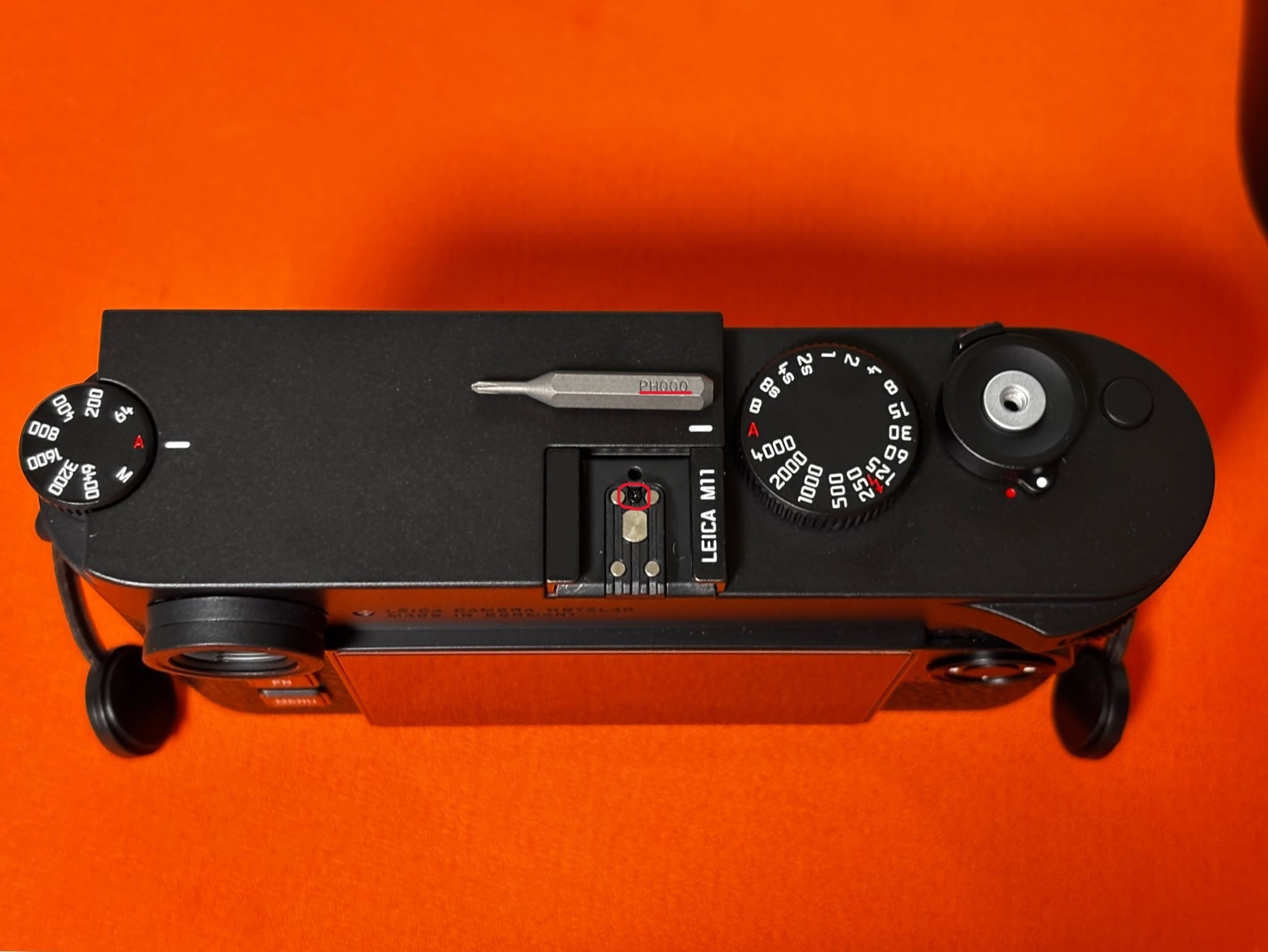

kyono Posted December 6, 2024 Share #12 Posted December 6, 2024 (edited) On 12/5/2024 at 1:02 AM, mrmr said: 제 M11이 느슨해져서 실망스럽습니다. 카메라를 새 것으로 바꾼 후 시도한 첫 번째 핫슈 커버와 뷰파인더가 미끄러져 나갑니다. 지금은 Voigtlander 뷰파인더 아래에 테이프를 사용하고 있습니다. 이 스프링을 조정하는 방법에 대한 팁을 알려주셔서 감사합니다. 이것과 형편없는 플라스틱 커버는 지름길 같습니다. It's been a while since I've posted on this thread, so I'm adding a simple way to adjust it at home. 1. Loosen the screw in the center of the hot shoe with a PH000 driver. Welcome, dear visitor! As registered member you'd see an image here… Simply register for free here – We are always happy to welcome new members! 2. Insert the tweezers into the hole above the screw hole and pull the spring out. 3. Adjust the separated spring. 4. Assemble in reverse order. Edited December 6, 2024 by kyono 8 Link to post Share on other sites Simply register for free here – We are always happy to welcome new members! 2. Insert the tweezers into the hole above the screw hole and pull the spring out. 3. Adjust the separated spring. 4. Assemble in reverse order. ' data-webShareUrl='https://www.l-camera-forum.com/topic/395665-hotshoe-springs-m11/?do=findComment&comment=5718653'>More sharing options...
michaelbrenner Posted December 6, 2024 Share #13 Posted December 6, 2024 12 hours ago, kyono said: It's been a while since I've posted on this thread, so I'm adding a simple way to adjust it at home. 1. Loosen the screw in the center of the hot shoe with a PH000 driver. Welcome, dear visitor! As registered member you'd see an image here… Simply register for free here – We are always happy to welcome new members! 2. Insert the tweezers into the hole above the screw hole and pull the spring out. 3. Adjust the separated spring. 4. Assemble in reverse order. I've got mine on order. Many thanks for such a simple and obvious solution. I've been using toothpicks to keep my gear attached... Link to post Share on other sites More sharing options...

kiwidad Posted January 11 Share #18 Posted January 11 On 12/6/2024 at 2:38 AM, kyono said: It's been a while since I've posted on this thread, so I'm adding a simple way to adjust it at home. 1. Loosen the screw in the center of the hot shoe with a PH000 driver. Welcome, dear visitor! As registered member you'd see an image here… Simply register for free here – We are always happy to welcome new members! 2. Insert the tweezers into the hole above the screw hole and pull the spring out. 3. Adjust the separated spring. 4. Assemble in reverse order. So the screw is just loosened? Link to post Share on other sites More sharing options...
kyono Posted January 11 Share #19 Posted January 11 (edited) 36분 전에, kiwidad가 말했다: 그래서 나사가 그냥 풀린 거야? The screw is the element that fixes the spring(brass plate). The spring is made of brass, so if you continue to attach the thumb grip or external viewfinder to the hot shoe, the spring may not be restored to its original state after disconnecting it. Welcome, dear visitor! As registered member you'd see an image here… Simply register for free here – We are always happy to welcome new members! Edited January 11 by kyono Link to post Share on other sites Simply register for free here – We are always happy to welcome new members! ' data-webShareUrl='https://www.l-camera-forum.com/topic/395665-hotshoe-springs-m11/?do=findComment&comment=5737690'>More sharing options...
