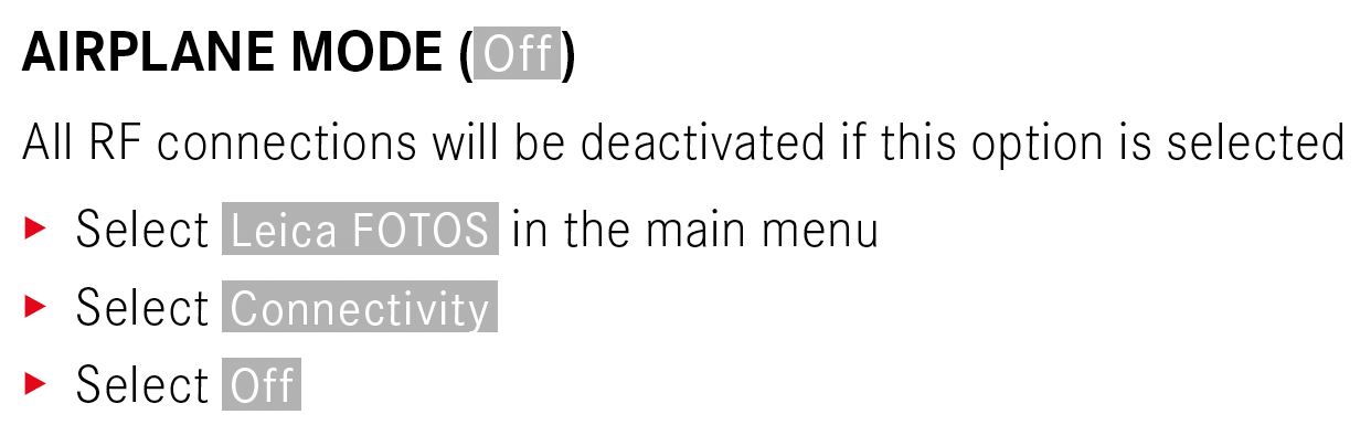

Ad Dieleman Posted January 11, 2024 Share #12 Posted January 11, 2024 I can see the Q3's Bluetooth connection on my Mac, indeed even when the camera is switched off. But as soon as I switch the connectivity to "Off" under the "Leica FOTOS" menu, the camera disappears from the Bluetooth list of devices on the Mac. It returns again when the connectivity is switched to "Eco mode" or "Performance mode". So if you want to save battery power, just switch the Leica FOTOS connectivity to off. This setting is part of a profile, so I made a profile "Radio off" to prevent unnecessary battery drain, easy peasy. Link to post Share on other sites More sharing options...
SnapshotGR Posted January 11, 2024 Share #13 Posted January 11, 2024 1 hour ago, David EI7KN said: I confirm that my Leica Q3 with the latest version 1.3 firmware does leave Bluetooth permanently on, even with the camera switched off at its Power Switch. I can therefore go into the Fotos App on my iPhone and can then 'Connect' to the camera and even remote control it. When I use the App's 'Disconnect' feature, it disconnects and shortly after the Leica Logo appears on the LCD of the Q3 and then the camera powers down - but Bluetooth remains active. Mine does this too. The manual mentions MIMO which I don’t know a lot about. I find it all convenient and works in a useful way to me. But I can see how it bothers people that want it the other way. it could do with an airplane mode though. I’m not sure how this works. Link to post Share on other sites More sharing options...
Ad Dieleman Posted January 11, 2024 Share #14 Posted January 11, 2024 3 hours ago, SnapshotGR said: it could do with an airplane mode though. I’m not sure how this works. Manual says: Welcome, dear visitor! As registered member you'd see an image here… Simply register for free here – We are always happy to welcome new members! 1 1 Link to post Share on other sites Simply register for free here – We are always happy to welcome new members! ' data-webShareUrl='https://www.l-camera-forum.com/topic/381777-q3-bluetooth-always-on/?do=findComment&comment=4983173'>More sharing options...
