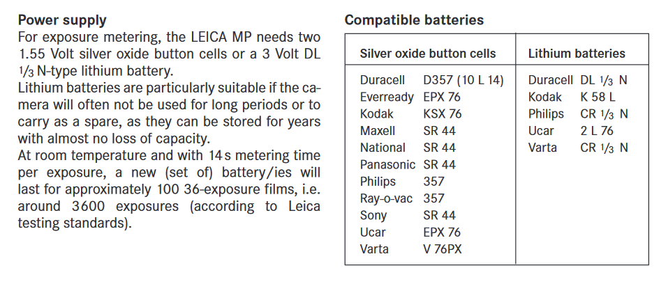

LocalHero1953 Posted July 6, 2023 Share #1 Posted July 6, 2023 (edited) Advertisement (gone after registration) The title says it all. I'm in Arles for the photo festival and the CR-1/3N battery in my 2022/23 MP has just died. I'm staying in the centre of town, getting around on foot, so I'm limited to nearby shops. I found no one that sold batteries until just now, when the saleswoman in an all-purpose tourist tat shop produced SR44 batteries and said two would work - and they do. As far as I can tell (Sunny 16 in bright south of France sunlight) the exposures are in the right ballpark. They also check with my phone exposure meter, tested against a plain cream wall. The CR-1/3N has a nominal voltage of 3.0V, while 2xSR44 will have a nominal voltage of 3.1V. I'm sure that's not a difference that will cause any harm, but will my exposures be accurate? Do modern Leica meters incorporate a voltage regulator? Edited July 6, 2023 by LocalHero1953 Link to post Share on other sites More sharing options...
Advertisement Posted July 6, 2023 Posted July 6, 2023 Hi LocalHero1953, Take a look here MP battery - can I replace CR-1/3N with two SR44?. I'm sure you'll find what you were looking for!
Anbaric Posted July 6, 2023 Share #2 Posted July 6, 2023 Yes, they'll be fine: Welcome, dear visitor! As registered member you'd see an image here… Simply register for free here – We are always happy to welcome new members! 1 Link to post Share on other sites Simply register for free here – We are always happy to welcome new members! ' data-webShareUrl='https://www.l-camera-forum.com/topic/379262-mp-battery-can-i-replace-cr-13n-with-two-sr44/?do=findComment&comment=4808726'>More sharing options...
madNbad Posted July 6, 2023 Share #3 Posted July 6, 2023 (edited) This shold help: https://www.l-camera-forum.com/topic/223525-sr44-battery-for-m7/ Edited July 6, 2023 by madNbad 1 Link to post Share on other sites More sharing options...
LocalHero1953 Posted July 6, 2023 Author Share #4 Posted July 6, 2023 18 minutes ago, Anbaric said: Yes, they'll be fine: Welcome, dear visitor! As registered member you'd see an image here… Simply register for free here – We are always happy to welcome new members! Duh - I didn't think to RTFM. Link to post Share on other sites More sharing options...

Fotoklaus Posted July 6, 2023 Share #8 Posted July 6, 2023 vor 35 Minuten schrieb LocalHero1953: Duh - I didn't think to RTFM. Brand names could differ a bit since the 1984- M6- manual but... 1 Link to post Share on other sites More sharing options...
