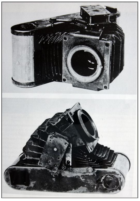

Roland Zwiers Posted August 2 Author Share #856 Posted August 2 Van Hasbroeck (1987) assumes that the panorama camera was produced after the introduction of the Leica in March 1925. This is a wrong assumption (see later). On the other it is a very logical assumption: one would indeed expect that Oskar Barnack would first create a general-purpose hand camera for perforated 35mm cine negative film before embarking on a much more specialized 35mm camera. The next slide shows the panorama camera as reproduced in Van Hasbroeck (1987). Link to post Share on other sites More sharing options...
Roland Zwiers Posted August 2 Author Share #857 Posted August 2 Welcome, dear visitor! As registered member you'd see an image here… Simply register for free here – We are always happy to welcome new members! Link to post Share on other sites Simply register for free here – We are always happy to welcome new members! ' data-webShareUrl='https://www.l-camera-forum.com/topic/378437-100-years-null-serie/?do=findComment&comment=5842165'>More sharing options...
Roland Zwiers Posted August 2 Author Share #858 Posted August 2 Note the accessory shoe on the panorama camera. Would this have been an original feature of 1912-1914 or added in a later year, e.g. so as to accommodate the Fodis rangefinder? Van Hasbroeck (1987) also reproduces two pictures that have been made with the panorama camera. He mentions the negative format of 24x96mm. One of these pictures corresponds to a negative with 20 perforations that I have discussed before. So, it is logical to assume that the panorama camera was designed for this format. Welcome, dear visitor! As registered member you'd see an image here… Simply register for free here – We are always happy to welcome new members! Link to post Share on other sites Simply register for free here – We are always happy to welcome new members! ' data-webShareUrl='https://www.l-camera-forum.com/topic/378437-100-years-null-serie/?do=findComment&comment=5842166'>More sharing options...

Roland Zwiers Posted August 2 Author Share #860 Posted August 2 Hans-Günter Kisselbach (2008), Ulf Richter (2009) and Helmut Lagler (2022) also show pictures of the panorama camera. Ulf Richter and Helmut Lagler mention that the panorama camera occurs in the work notes of Oskar Barnack in the years 1911 and 1912. An early date for the panorama camera (much earlier than March 1925) also follows from a negative that I have discussed before: Welcome, dear visitor! As registered member you'd see an image here… Simply register for free here – We are always happy to welcome new members! The German text states that this ‘special camera’ was hidden in 1918/19 from an inter-allied investigation-committee and that afterwards the camera could not be found anymore. It is not known in what year his text was written. Link to post Share on other sites Simply register for free here – We are always happy to welcome new members! The German text states that this ‘special camera’ was hidden in 1918/19 from an inter-allied investigation-committee and that afterwards the camera could not be found anymore. It is not known in what year his text was written. ' data-webShareUrl='https://www.l-camera-forum.com/topic/378437-100-years-null-serie/?do=findComment&comment=5842169'>More sharing options...
