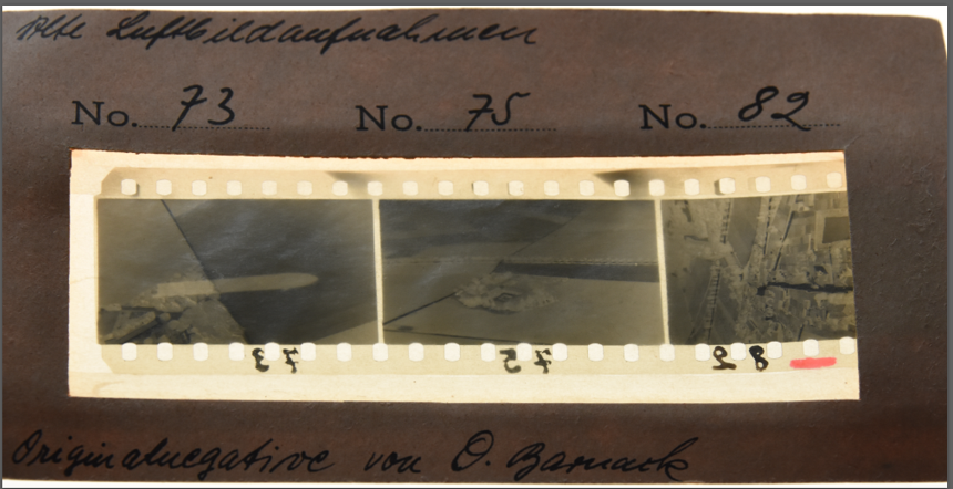

Roland Zwiers Posted June 11 Author Share #707 Posted June 11 Advertisement (gone after registration) It is crucial that native readers of German, like UliWer, do a double-check! Now in 2023, during our visit to the Leitz archive in Wetzlar, I had some time to look at the box with early Oskar Barnack negatives. To my great delight I found negatives that may correspond to Oskar Barnack's handwitten notes relating to March-April 1914. One negative that was obviously taken with a panorama camera. And several negatives that must have been taken with the Ur-Leica. Welcome, dear visitor! As registered member you'd see an image here… Simply register for free here – We are always happy to welcome new members! Link to post Share on other sites Simply register for free here – We are always happy to welcome new members! ' data-webShareUrl='https://www.l-camera-forum.com/topic/378437-100-years-null-serie/?do=findComment&comment=5815899'>More sharing options...
Roland Zwiers Posted June 11 Author Share #708 Posted June 11 The text above the panorama negative reads: Luftbildaufnahmen (ohne Zwischenräume) mit Spezialkamera aufgenommen. [...] Aerial pictures (uninterrupted by in-between speces) taken with a special camera. [...][the additional text is very interesting, but I cannot discuss this now.] The second example concern negatives taken by the Ur-Leica. It would make sense to assume that in March-April 1914 Oskar Barnack had two 35mm cameras on board! Welcome, dear visitor! As registered member you'd see an image here… Simply register for free here – We are always happy to welcome new members! Now in a previous slide I already showed the print of the negative on the left, showing the shadow of the Zeppelin. For these aerial pictures to make sense, the film had to be sensitive to the colours yellow and green. So this may be very early proof of Oskar Barnack's experiments with colour-sensitive black-and-white films. Note that for these experiments Oskar Barnack must have used a yellow-filter as well. Otherwise the over-sensitivity of the film to violet and blue would still have dominated the results. Note as well that the lens/ lenstube on the Ur-Leica was not really suitable for accomodating a yellow filter. The weight of the filter may have tilted the lens, leading to lack of sharpness in the corners. The improper mounting of the yellow filter may have caused other problems. To be continued. Roland Link to post Share on other sites Simply register for free here – We are always happy to welcome new members! Now in a previous slide I already showed the print of the negative on the left, showing the shadow of the Zeppelin. For these aerial pictures to make sense, the film had to be sensitive to the colours yellow and green. So this may be very early proof of Oskar Barnack's experiments with colour-sensitive black-and-white films. Note that for these experiments Oskar Barnack must have used a yellow-filter as well. Otherwise the over-sensitivity of the film to violet and blue would still have dominated the results. Note as well that the lens/ lenstube on the Ur-Leica was not really suitable for accomodating a yellow filter. The weight of the filter may have tilted the lens, leading to lack of sharpness in the corners. The improper mounting of the yellow filter may have caused other problems. To be continued. Roland ' data-webShareUrl='https://www.l-camera-forum.com/topic/378437-100-years-null-serie/?do=findComment&comment=5815902'>More sharing options...
