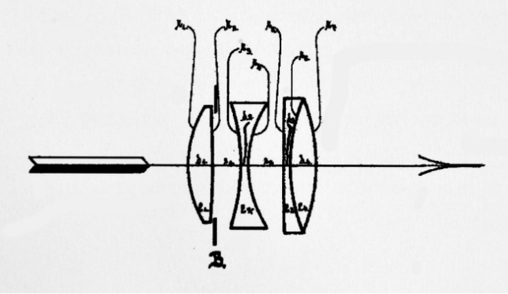

Roland Zwiers Posted August 1, 2023 Author Share #332 Posted August 1, 2023 Null Serie delay After 1918 Oskar Barnack designed an improved prototype, which is known as the Handmuster camera of 1920. This camera is also known as the Kisselbach camera. It stood model for the Null Serie of 1923. Barnack (1931) makes clear that one of the requirements for this new prototype was an excellent lens.The task to design this lens was entrusted to Max Berek. The result was the 4-element Leitz Anastigmat of 1920. Welcome, dear visitor! As registered member you'd see an image here… Simply register for free here – We are always happy to welcome new members! For this 4-element lens Leitz obtained a patent in 1920 (Patent 343086). According to Ernst Leitz (1933) and Max Berek (1948) only a few lenses were produced for internal use. Although Leitz, Berek and Barnack do not say so, it is very likely that this 1920 Anastigmat did not fulfil the requirements. Research by Ottmar Michaely shows that the existing pre-Null-Serie cameras are fitted with 5-element Anastigmats! This implies that the original 4-element Anastigmats have been replaced when the first 5-element Anastigmats became available. Why was this 4-element Anastigmat unsuitable? A plausible explanation is that Max Berek had to circumvent the Tessar patent. This patent was declared valid again in 1920, see the advertisement on the front page of Photographische Rundschau. So as a precaution Max Berek may have used different types of optical glass for the front and rear lens elements. But these elements may have discoloured over time on exposure to oxygen. Using the proven Tessar specifications would have been much safer. But Ernst Leitz II may have decided against paying royalties. The unsuitability of the original 4-element Leitz Anastigmat must have caused a long delay. Had this lens proved adequate, then the Null Serie could have been introduced in 1920 already! Another consideration is that 1920-1921 were not yet years of geo-political tensions with France over reparation payments. These tensions would lead to the French occupation of the Rhineland and the hyper inflation of 1922-1923. In this environment it was very hard to indroduce a new, innovative but also expensive camera on the market. So it seems that the unsuitability of the 4-element Leitz Anastigmat of 1920 caused a very long delay. Max Berek had to start work on another lens (the 5-element Leitz Anastigmat). This lens was ready at the end on 1922. And then this lens still had to be tested on the Null Serie of 1923. And then one bottleneck was the lack of quality of German 35mm cine negative film in the period of hyperinflation.[An observation by Prof Klute; Dr Paul Wolff had a similar complaint.] But the contemporary film producers Agfa, Goerz and Lignose must have struggled to maintain quality standards in an evironment of occupation, the break-down of supply chains, and hyper inflation. This long and unforeseen delay may well be one of the reasons that in later life Ludwig Leitz recollects the Leica as 'our problem child' (Sorgenkind). To be continued. Roland [i] Ottmar Michaely/ xxx, research Handmuster has 5 element Anastigmat. PM . 3 Link to post Share on other sites Simply register for free here – We are always happy to welcome new members! For this 4-element lens Leitz obtained a patent in 1920 (Patent 343086). According to Ernst Leitz (1933) and Max Berek (1948) only a few lenses were produced for internal use. Although Leitz, Berek and Barnack do not say so, it is very likely that this 1920 Anastigmat did not fulfil the requirements. Research by Ottmar Michaely shows that the existing pre-Null-Serie cameras are fitted with 5-element Anastigmats! This implies that the original 4-element Anastigmats have been replaced when the first 5-element Anastigmats became available. Why was this 4-element Anastigmat unsuitable? A plausible explanation is that Max Berek had to circumvent the Tessar patent. This patent was declared valid again in 1920, see the advertisement on the front page of Photographische Rundschau. So as a precaution Max Berek may have used different types of optical glass for the front and rear lens elements. But these elements may have discoloured over time on exposure to oxygen. Using the proven Tessar specifications would have been much safer. But Ernst Leitz II may have decided against paying royalties. The unsuitability of the original 4-element Leitz Anastigmat must have caused a long delay. Had this lens proved adequate, then the Null Serie could have been introduced in 1920 already! Another consideration is that 1920-1921 were not yet years of geo-political tensions with France over reparation payments. These tensions would lead to the French occupation of the Rhineland and the hyper inflation of 1922-1923. In this environment it was very hard to indroduce a new, innovative but also expensive camera on the market. So it seems that the unsuitability of the 4-element Leitz Anastigmat of 1920 caused a very long delay. Max Berek had to start work on another lens (the 5-element Leitz Anastigmat). This lens was ready at the end on 1922. And then this lens still had to be tested on the Null Serie of 1923. And then one bottleneck was the lack of quality of German 35mm cine negative film in the period of hyperinflation. [An observation by Prof Klute; Dr Paul Wolff had a similar complaint.] But the contemporary film producers Agfa, Goerz and Lignose must have struggled to maintain quality standards in an evironment of occupation, the break-down of supply chains, and hyper inflation. This long and unforeseen delay may well be one of the reasons that in later life Ludwig Leitz recollects the Leica as 'our problem child' (Sorgenkind). To be continued. Roland [i] Ottmar Michaely/ xxx, research Handmuster has 5 element Anastigmat. PM . ' data-webShareUrl='https://www.l-camera-forum.com/topic/378437-100-years-null-serie/?do=findComment&comment=4826025'>More sharing options...
willeica Posted August 1, 2023 Share #333 Posted August 1, 2023 3 hours ago, Roland Zwiers said: Null Serie delay After 1918 Oskar Barnack designed an improved prototype, which is known as the Handmuster camera of 1920. This camera is also known as the Kisselbach camera. It stood model for the Null Serie of 1923. Barnack (1931) makes clear that one of the requirements for this new prototype was an excellent lens.The task to design this lens was entrusted to Max Berek. The result was the 4-element Leitz Anastigmat of 1920. Welcome, dear visitor! As registered member you'd see an image here… Simply register for free here – We are always happy to welcome new members! For this 4-element lens Leitz obtained a patent in 1920 (Patent 343086). According to Ernst Leitz (1933) and Max Berek (1948) only a few lenses were produced for internal use. Although Leitz, Berek and Barnack do not say so, it is very likely that this 1920 Anastigmat did not fulfil the requirements. Research by Ottmar Michaely shows that the existing pre-Null-Serie cameras are fitted with 5-element Anastigmats! This implies that the original 4-element Anastigmats have been replaced when the first 5-element Anastigmats became available. Why was this 4-element Anastigmat unsuitable? A plausible explanation is that Max Berek had to circumvent the Tessar patent. This patent was declared valid again in 1920, see the advertisement on the front page of Photographische Rundschau. So as a precaution Max Berek may have used different types of optical glass for the front and rear lens elements. But these elements may have discoloured over time on exposure to oxygen. Using the proven Tessar specifications would have been much safer. But Ernst Leitz II may have decided against paying royalties. The unsuitability of the original 4-element Leitz Anastigmat must have caused a long delay. Had this lens proved adequate, then the Null Serie could have been introduced in 1920 already! Another consideration is that 1920-1921 were not yet years of geo-political tensions with France over reparation payments. These tensions would lead to the French occupation of the Rhineland and the hyper inflation of 1922-1923. In this environment it was very hard to indroduce a new, innovative but also expensive camera on the market. So it seems that the unsuitability of the 4-element Leitz Anastigmat of 1920 caused a very long delay. Max Berek had to start work on another lens (the 5-element Leitz Anastigmat). This lens was ready at the end on 1922. And then this lens still had to be tested on the Null Serie of 1923. And then one bottleneck was the lack of quality of German 35mm cine negative film in the period of hyperinflation.[An observation by Prof Klute; Dr Paul Wolff had a similar complaint.] But the contemporary film producers Agfa, Goerz and Lignose must have struggled to maintain quality standards in an evironment of occupation, the break-down of supply chains, and hyper inflation. This long and unforeseen delay may well be one of the reasons that in later life Ludwig Leitz recollects the Leica as 'our problem child' (Sorgenkind). To be continued. Roland [i] Ottmar Michaely/ xxx, research Handmuster has 5 element Anastigmat. PM . Here is a blueprint for the 5 element Anastigmat. It is dated 22.9.23 and signed off by Barnack at the bottom right. I must presume that this was in anticipation of line production. This was from a folder of blueprints which was sold at auction at the same time as No 105. I had an opportunity to go through it on the day before the auction. This was by far the most interesting item in the folder. We should ask Tim Pullmann whether he has other dated blueprints like this one. William Link to post Share on other sites More sharing options...
Roland Zwiers Posted August 1, 2023 Author Share #334 Posted August 1, 2023 William, This is a fascinating blueprint indeed! It even has 'Barnack' in his own handwriting in the lower right corner. The blueprint shows a 5-element design with the name 'Leitz Anastigmat' and the date 23 [?] September 1923. The name 'Elmax' is not yet applied. According to Leica literature the name change 'Leitz Anastigmat' to 'Elmax' took place in December 1924. 23 September 1923 is clearly in Null-Serie territory. According to Ottmar Michaely all Null-Serie cameras that he was able to inspect, have 5-element lenses. So the blueprint must have been made while the 5-element Leitz Anastigmat was already in production. I am curious after the meaning of 4201; does this stand for the 'Kleinfilmkamera' under consideration? It is followed by Bl. 163 = Blatt = page/ drawing and by Teil: 152 = part 152 In a next posting I would like to show you another design drawing of the 5-element Leitz Anastigmat. To be continued. Roland Link to post Share on other sites More sharing options...
Roland Zwiers Posted August 1, 2023 Author Share #335 Posted August 1, 2023 William, This design drawing comes courtesy Oscar Fricke. Welcome, dear visitor! As registered member you'd see an image here… Simply register for free here – We are always happy to welcome new members! In the upper left corner [A] one can read ‘System 1921’. There is an accompanying drawing of the five lens elements and a technical specification of the eight curves involved. At [B] there is a remark in an old handwriting style that the design specifications (‘das ausgeführte System’) have been changed for the first and the last glass elements. At [C] one can observe that by 7 October 1922 the specifications of glass element 5 (so the rear element) had been altered again. It is interesting to observe that the changes concern the first and the last lens elements. These outside elements would be the most vulnerable to atmospheric influences. Max Berek had to make corrections when confronted with discolouring and/or deteriorating glass. This is also a clue for what may have gone wrong with the 4-element Leitz Anastigmat of 1920 in the first place! Leitz (1933) states that the Elmax was produced from 1923 onwards up to the spring of 1925 (“…bis zum Frühjahr 1925”). This information matches very well with the last design changes of 7 October 1922. One can hardly blame Ernst Leitz and Max Berek for waiting a few additional months before taking the lens in production. All in all, I assume that this design drawing preceded the production of the 5-element Leitz Anastigmat. Your fascinating blueprint must have been made while the 5-element Leitz Anastigmat was already in production. In order to avoid confusion: There is a third more modern handwriting style in pencil with the date 10.7.47. This suggests that these drawings have been commented upon in 1947. This would also explain the pencilled in ‘Elmax’ name on these 1921 and 1922 designs. According to Prof. Von Einem (2004) the ‘Elmax’ name was introduced at the end of 1924. This is confirmed by Ulf Richter, who dates the introduction of the Elmax name a few months before the March 1925 Leipzig fair. Roland Link to post Share on other sites Simply register for free here – We are always happy to welcome new members! In the upper left corner [A] one can read ‘System 1921’. There is an accompanying drawing of the five lens elements and a technical specification of the eight curves involved. At [B] there is a remark in an old handwriting style that the design specifications (‘das ausgeführte System’) have been changed for the first and the last glass elements. At [C] one can observe that by 7 October 1922 the specifications of glass element 5 (so the rear element) had been altered again. It is interesting to observe that the changes concern the first and the last lens elements. These outside elements would be the most vulnerable to atmospheric influences. Max Berek had to make corrections when confronted with discolouring and/or deteriorating glass. This is also a clue for what may have gone wrong with the 4-element Leitz Anastigmat of 1920 in the first place! Leitz (1933) states that the Elmax was produced from 1923 onwards up to the spring of 1925 (“…bis zum Frühjahr 1925”). This information matches very well with the last design changes of 7 October 1922. One can hardly blame Ernst Leitz and Max Berek for waiting a few additional months before taking the lens in production. All in all, I assume that this design drawing preceded the production of the 5-element Leitz Anastigmat. Your fascinating blueprint must have been made while the 5-element Leitz Anastigmat was already in production. In order to avoid confusion: There is a third more modern handwriting style in pencil with the date 10.7.47. This suggests that these drawings have been commented upon in 1947. This would also explain the pencilled in ‘Elmax’ name on these 1921 and 1922 designs. According to Prof. Von Einem (2004) the ‘Elmax’ name was introduced at the end of 1924. This is confirmed by Ulf Richter, who dates the introduction of the Elmax name a few months before the March 1925 Leipzig fair. Roland ' data-webShareUrl='https://www.l-camera-forum.com/topic/378437-100-years-null-serie/?do=findComment&comment=4826406'>More sharing options...
willeica Posted August 1, 2023 Share #336 Posted August 1, 2023 (edited) 1 hour ago, Roland Zwiers said: William, This is a fascinating blueprint indeed! It even has 'Barnack' in his own handwriting in the lower right corner. The blueprint shows a 5-element design with the name 'Leitz Anastigmat' and the date 23 [?] September 1923. The name 'Elmax' is not yet applied. According to Leica literature the name change 'Leitz Anastigmat' to 'Elmax' took place in December 1924. 23 September 1923 is clearly in Null-Serie territory. According to Ottmar Michaely all Null-Serie cameras that he was able to inspect, have 5-element lenses. So the blueprint must have been made while the 5-element Leitz Anastigmat was already in production. I am curious after the meaning of 4201; does this stand for the 'Kleinfilmkamera' under consideration? It is followed by Bl. 163 = Blatt = page/ drawing and by Teil: 152 = part 152 In a next posting I would like to show you another design drawing of the 5-element Leitz Anastigmat. To be continued. Roland This was produced before the decision to proceed with the Leica was taken, but my guess is that this was a blueprint that anticipated series production. As for the numbers you can probably guess what they were from this one which shows the film counter. I suspect that 4201 is the project, 163 is the page and 152 is the part. This may help and the numbers here are 127 and 117, respectively. The date here seems to be 31.12.23. Welcome, dear visitor! As registered member you'd see an image here… Simply register for free here – We are always happy to welcome new members! 1 hour ago, Roland Zwiers said: William, This design drawing comes courtesy Oscar Fricke. In the upper left corner [A] one can read ‘System 1921’. There is an accompanying drawing of the five lens elements and a technical specification of the eight curves involved. At [B] there is a remark in an old handwriting style that the design specifications (‘das ausgeführte System’) have been changed for the first and the last glass elements. At [C] one can observe that by 7 October 1922 the specifications of glass element 5 (so the rear element) had been altered again. It is interesting to observe that the changes concern the first and the last lens elements. These outside elements would be the most vulnerable to atmospheric influences. Max Berek had to make corrections when confronted with discolouring and/or deteriorating glass. This is also a clue for what may have gone wrong with the 4-element Leitz Anastigmat of 1920 in the first place! Leitz (1933) states that the Elmax was produced from 1923 onwards up to the spring of 1925 (“…bis zum Frühjahr 1925”). This information matches very well with the last design changes of 7 October 1922. One can hardly blame Ernst Leitz and Max Berek for waiting a few additional months before taking the lens in production. All in all, I assume that this design drawing preceded the production of the 5-element Leitz Anastigmat. Your fascinating blueprint must have been made while the 5-element Leitz Anastigmat was already in production. In order to avoid confusion: There is a third more modern handwriting style in pencil with the date 10.7.47. This suggests that these drawings have been commented upon in 1947. This would also explain the pencilled in ‘Elmax’ name on these 1921 and 1922 designs. According to Prof. Von Einem (2004) the ‘Elmax’ name was introduced at the end of 1924. This is confirmed by Ulf Richter, who dates the introduction of the Elmax name a few months before the March 1925 Leipzig fair. Roland This is described by Richter (as translated by Oscar Fricke's father, Rolf) as the system data sheet for the 1921 Elmax lens. This looks like a document which was used a lot over the years with additions at various times. This is clearly for a 5 element lens and, based on what we can see, it seems to be similar to the design in the blueprint. Richter also says, however, that the 7.10.22 note indicates a change in computation related to glass types. None of this is surprising given the innovative design and Barnack's penchant for continuous testing. Cameras produced/issued in 1924 and 1925 had the Anastigmat name on the lens and of that there is no doubt. This then became the Elmax and this work in progress sheet would seem to confirm this. One question worth asking Ottmar, if he turns up, is whether any early Elmar which he has examined actually had 5 elements, say up to 1927. The recently published Leica Pocket Book 9th Edition refers to this. It also states that the 5 elements in the Anastigmat were really 4 elements. I don't know whether these statements fall into your 'hoary myths' category, but they may go back to the late Dennis Laney. The more Leica books you read the more confusing it all gets. One of the innovative aspects of the Leitz lenses of the 1920s is that they were almost (probably) the first camera lenses with helicoids since the 1850s. I presume that you have seen my PCCGB Zoom talk on YouTube about this topic. William Edited August 1, 2023 by willeica Link to post Share on other sites Simply register for free here – We are always happy to welcome new members! This is described by Richter (as translated by Oscar Fricke's father, Rolf) as the system data sheet for the 1921 Elmax lens. This looks like a document which was used a lot over the years with additions at various times. This is clearly for a 5 element lens and, based on what we can see, it seems to be similar to the design in the blueprint. Richter also says, however, that the 7.10.22 note indicates a change in computation related to glass types. None of this is surprising given the innovative design and Barnack's penchant for continuous testing. Cameras produced/issued in 1924 and 1925 had the Anastigmat name on the lens and of that there is no doubt. This then became the Elmax and this work in progress sheet would seem to confirm this. One question worth asking Ottmar, if he turns up, is whether any early Elmar which he has examined actually had 5 elements, say up to 1927. The recently published Leica Pocket Book 9th Edition refers to this. It also states that the 5 elements in the Anastigmat were really 4 elements. I don't know whether these statements fall into your 'hoary myths' category, but they may go back to the late Dennis Laney. The more Leica books you read the more confusing it all gets. One of the innovative aspects of the Leitz lenses of the 1920s is that they were almost (probably) the first camera lenses with helicoids since the 1850s. I presume that you have seen my PCCGB Zoom talk on YouTube about this topic. William ' data-webShareUrl='https://www.l-camera-forum.com/topic/378437-100-years-null-serie/?do=findComment&comment=4826459'>More sharing options...
Roland Zwiers Posted August 1, 2023 Author Share #337 Posted August 1, 2023 One question worth asking Ottmar, if he turns up, is whether any early Elmar which he has examined actually had 5 elements, say up to 1927. William, Leica literature suggests it is the other way round.The Elmax name must still have been in use after the design change from 5 to 4 lens elements. So there must have been Elmax lenses with only 4 lens elements. Ottmar Michaely has indeed identified one such 4-element Elmax on Leica Nr. 1162 (see: Prof. Von Einem (2004)). Similar lenses may be present on Leicas produced between June and 7 October 1925. The confusing thing is that there have both been name and design changes in a relatively short period of time. My table, based on discussions with several Leica historians, makes this clear. A design change did not automatically lead to a name change: the name 'Leitz Anastigmat' remained intially the same when the lens design changed from 4 to 5 elements. Likewise, the name 'Elmax' was initially maintained when the design changed again from 5 to 4 lens elements. This course of events implies that there has not been a 5-element Elmar. But there has been a 4-element Elmax. The reason for changeing the name from Elmax to Elmar has to do with an Ernemann tradename dispute. That is the subject for another posting. To be continued. Roland Welcome, dear visitor! As registered member you'd see an image here… Simply register for free here – We are always happy to welcome new members! 2 Link to post Share on other sites Simply register for free here – We are always happy to welcome new members! ' data-webShareUrl='https://www.l-camera-forum.com/topic/378437-100-years-null-serie/?do=findComment&comment=4826482'>More sharing options...
willeica Posted August 1, 2023 Share #338 Posted August 1, 2023 2 minutes ago, Roland Zwiers said: Leica literature suggests it is the other way round. So the newly published (2023) Leica Pocket Guide 9th Edition is wrong, but that story has been doing the rounds for years. I am glad that I have never been tempted to take the Elmars apart on my early I Model A examples 😅. What about the statement in the Pocket Guide that the Anastigmat was a 4 element lens in 3 groups? I think this may be because of confusion caused by the original 4 element Anastigmat lens. However, the blueprint and the data sheet clearly show a 5 element lens for the Anastigmat and later the Elmax. Your next big target might be to find out at what serial number the Elmax went to 4 elements. Anything to do with glass type, Goerz v Schott , or something like that ? William Link to post Share on other sites More sharing options...
Roland Zwiers Posted August 2, 2023 Author Share #339 Posted August 2, 2023 Alan, This whole discussion started with the question: is the Leitz Anastigmat a 4- element or a 5-element design? One opinion said 4-element: just look at the 1920 drawings and the 1920 patent application. These are reliable primary sources! Another group (including Ottmar Michaely) observed: the lenses that are found on the known Null-Serie and pre-Null-serie cameras all have 5-element Leitz Anastigmats! This is reliable empirical evidence. So what to do? I re-examined the primary sources on the 1920 Leitz Anastigmat. So Oskar Barnack (1931), Leitz (1933) and Max Berek (1948). This required close reading again! Oskar Barnack (1931) says that for the Handmuster of 1920 he needed an excellent lens. And that Max Berek would design such an excellent lens. He does not say that the 1920 Anastigmat was an excellent lens! Leitz (1933) says that of the 1920 Anastigmat only a few specimens were made 'for internal use'. So for a long time Í assumed: 'internal use' = Null-Serie use. But that was my own assumption. Leitz (1933) does not say so. Max Berek (1948) says that from the 1920 Anastigmat are derived: the Elmax and the Elmar. Again, he does not say that the 1920 Anastigmat was an excellent lens. So then it occured to me: maybe only two specimens of the 1920 Leitz have been made. One for the Handmuster of 1920, one for the sister model (Gebrauchsmuster) that may have been sent to the patent office. That is for internal use indeed! But after a short while the glass started to discoulour. Opting for unproven optical glass (possibly so as to avoid the Tessar patent) had resulted in disaster. So Max Berek would start out immediately on a 5-element alternative. Wy 5-elements, why not copy the Tessar design with the proven optical glass? In my hypothesis Ernst Leitz II did not want to pay royalties. So when the frst specimens of the new 5-element design came available, they replaced the 4-element Anastigmats on the Handmuster and Gebrauchsmuster cameras of 1920. The 1920 Anastigmats ended up in the dustbin. That is internal use as as well 🙂 Roland Link to post Share on other sites More sharing options...
Roland Zwiers Posted August 2, 2023 Author Share #340 Posted August 2, 2023 So the newly published (2023) Leica Pocket Guide 9th Edition is wrong, but that story has been doing the rounds for years. William, Sorry, the last posting was also adressed to you, Yes, according to my current working hypothesis that story is wrong.But please note that this is my second working hypothesis on this subject.It shows that when new evidence comes in, one has to include that in the story line. And so the story line (the current working hypothesis) may have to be adapted. This is a good example of how to make progress without having to lose face or faith.The discussion started with the question: is the Leitz Anastigmat a 4- element or a 5-element design? Now I had just discovered a new primary source, Leitz (1933). It is an article in the magazine Die Leica, edited by Curt Emmermann. Ed Schwartzreich and me are planning to write an article about this. Now Leitz (1933) states that the 4-element 1920 Leitz Anastigmat had been 'for internal use'. Leica literature states that the 1920 Anastigmat was designed for the Handmuster camera of 1920. Leica literature states that the 1920 Anastigmat was an excellent lens.So in this story line I assumed (working hypothesis 1) that the 1920 4-element Anastigmat must have been used on the Null-Serie of 1923 as well. After all, the Null-Serie amounted to a small batch of cameras for internal use (not for sale). Then came one new piece of empirical information. Ottmar Michaely objected that all Null-Serie and pre-Null-Serie cameras that he had been able to inspect, all carried a 5-element Leitz Anastigmat. In my opinion such empirical evidence overrules pre-war primary sources, as one must always keep in mind that pre-war sources may have a bias. [We have seen this as well with Oskar Barnack (1931) (Why I created the Leica) and Dr Paul Wolff (1937) (I won my first Leica in 1926).] So I had to look out for a new working hypothesis that includes the new empirical information. In this way I don't lose face (it would be worse if I chose to ignore the new information!). I don't lose faith (the new information can only bring me closer to 'the truth'). I don't say that the new working hypothesis is the truth, the whole truth, and nothing but the truth. It is just the best working hypothesis that I can formulate with the available information. Still, The 1923 Leica Pocket Guide 9th Edition may be based on information that I have overlooked. After all, my passion is to dig in pre-war sources. If a new piece of information comes along, I am very willing to adapt my working hypothesis again. Roland 1 Link to post Share on other sites More sharing options...
