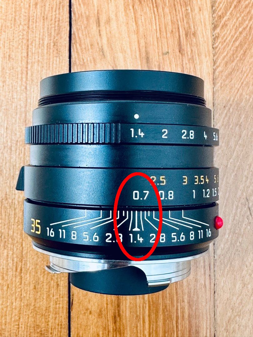

evikne Posted February 28, 2023 Share #6 Posted February 28, 2023 (edited) I don't own this lens anymore, but I found a random image on the web. As you can see, when focus is turned to the near limit, the 0.7m engraving is going slightly past the marker. This means the actual MFD is a little closer than 0.7m. – Which also means that the engravings are pretty accurate. Many (most?) Leica lenses are made this way. Just be happy and think of it as a little bit of extra MFD that you get "for free". Welcome, dear visitor! As registered member you'd see an image here… Simply register for free here – We are always happy to welcome new members! Edited February 28, 2023 by evikne Link to post Share on other sites Simply register for free here – We are always happy to welcome new members! ' data-webShareUrl='https://www.l-camera-forum.com/topic/369237-has-anyone-tried-measure-the-actual-distance-as-indicated-on-the-lens/?do=findComment&comment=4705043'>More sharing options...

evikne Posted March 1, 2023 Share #8 Posted March 1, 2023 (edited) Obviously, some engraved numbers cannot show the distance with mm precision. But here are two examples from the 35mm Summilux pre-ASPH thread that more clearly show what I mean. The MFD of this lens is stated to be 1 m / 3.28 ft in catalogs etc. But the lens to the left was measured to have an actual MFD of 0.73 m, and the right one was measured to be 0.89 m. On both lenses this corresponds very well with the distance scale. Especially the left one goes way past the 1 m and 3 ft engraving. Welcome, dear visitor! As registered member you'd see an image here… Simply register for free here – We are always happy to welcome new members! Edited March 1, 2023 by evikne Link to post Share on other sites Simply register for free here – We are always happy to welcome new members! ' data-webShareUrl='https://www.l-camera-forum.com/topic/369237-has-anyone-tried-measure-the-actual-distance-as-indicated-on-the-lens/?do=findComment&comment=4705815'>More sharing options...
