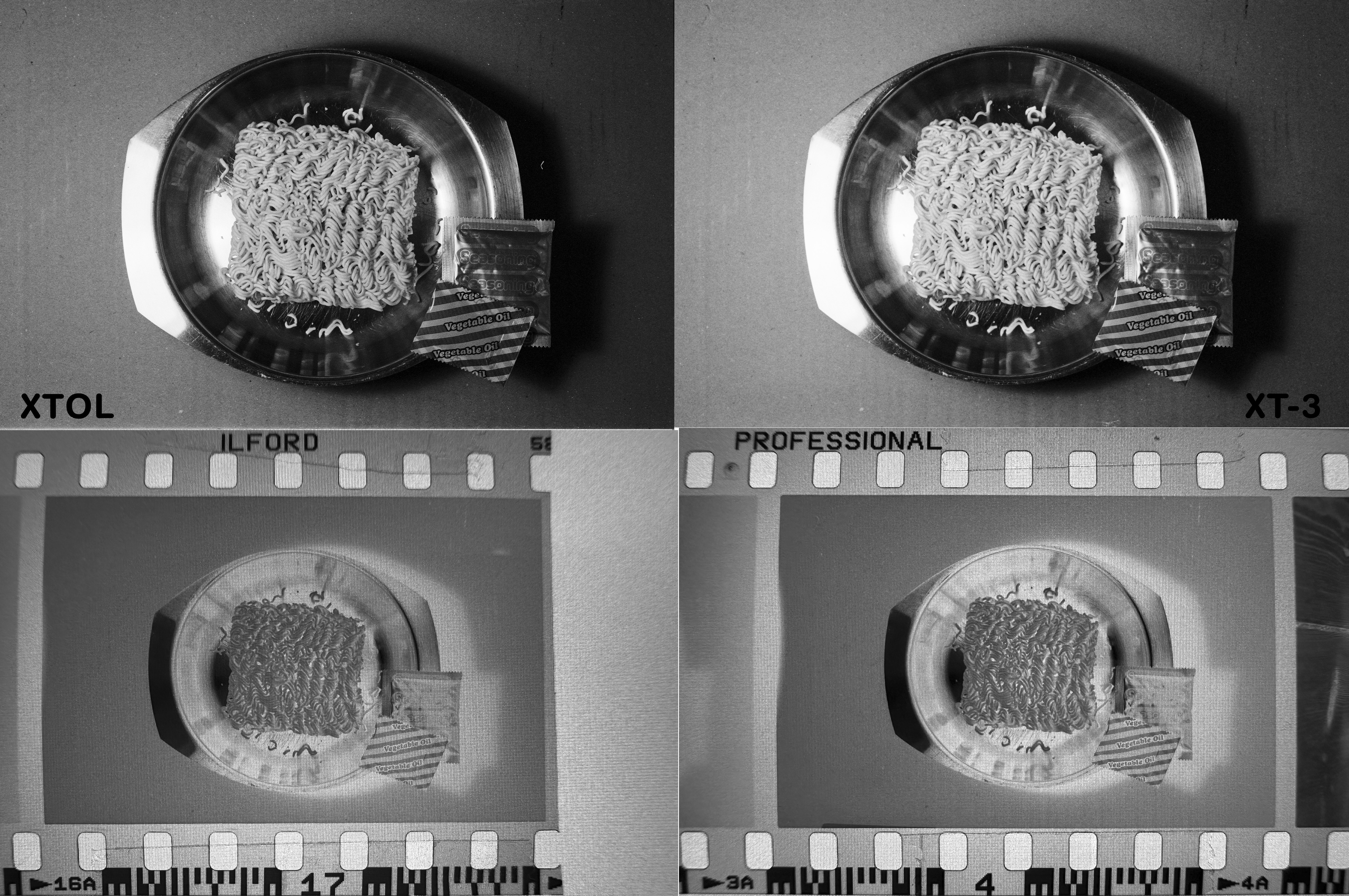

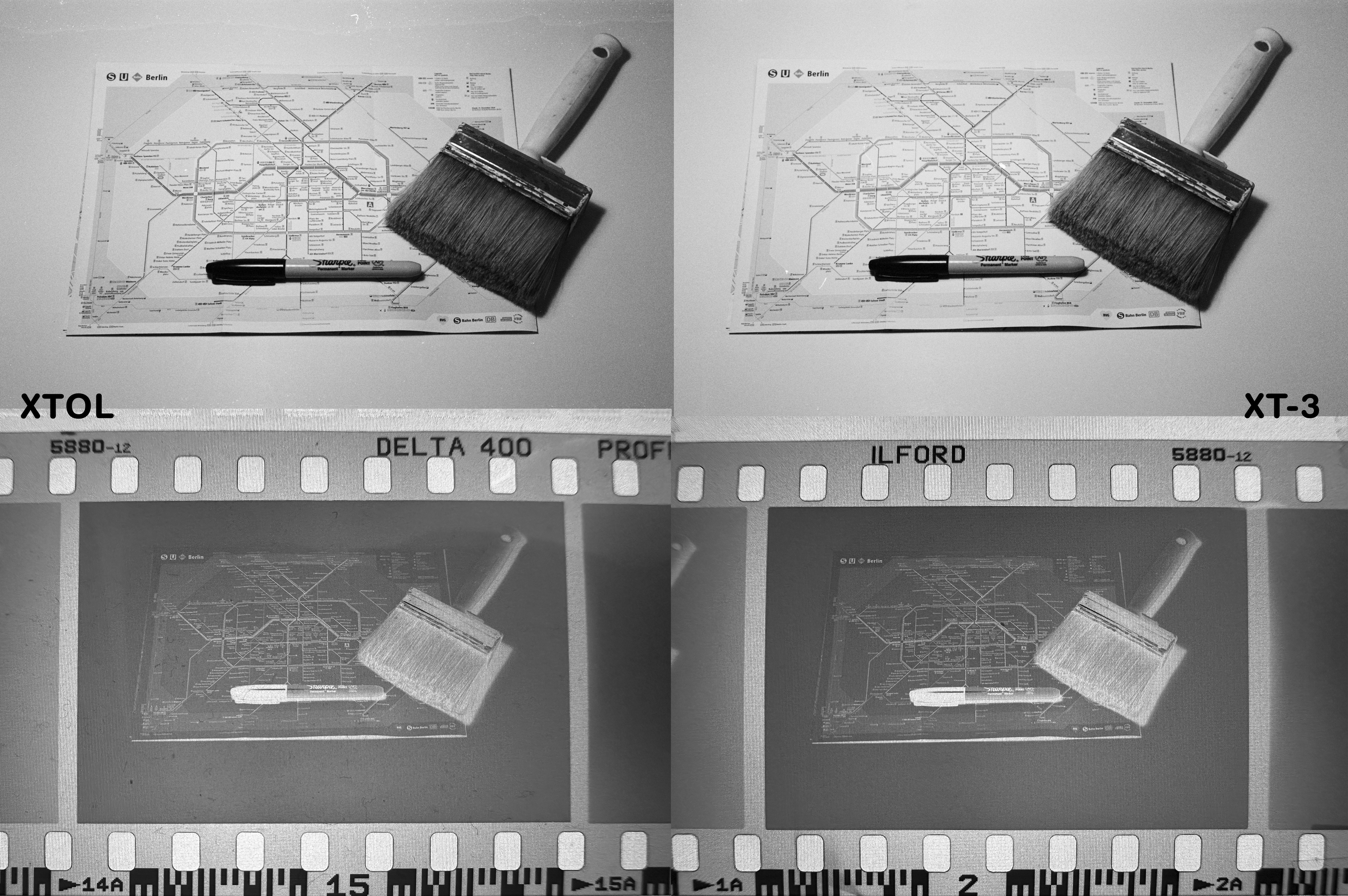

username Posted February 19 Share #163 Posted February 19 Ok, so I couldn't wait (until I've used up all my XTOL) and dissolved my first XT-3 pack to see how it performs versus the XTOL. Please take the following with a grain of salt, call it a semi-scientific comparison if you will 🙂 It's all Delta 400, shot @ 360. Developed in XTOL 1:1 / XT-3 1:1, at 20°C, for 12minutes (excluding the pour in and out of the developer), 10sec initial agitation (4 inversions), and 10sec every full minute. Actually using a stop bath now, followed by 2-bath fixing, for extra nerd points 😀 Negs are scanned with Silverfast 6 - without any Negafix profiles, without any adjustements - and are not edited after the fact. Welcome, dear visitor! As registered member you'd see an image here… Simply register for free here – We are always happy to welcome new members! To be frank I'm not completely sure what to make of it (read: I'm kinda too dumb to properly judge my negs) 💁♂️ Obvioulsly the XT-3 developed film looks a bit "hotter", so yes the XT-3 seems to be more "active" compared to the latest (PSI) version of XTOL that I have - but I can't really tell whether the XT-3 neg is actually a bit overdeveloped already - or the XTOL one still underdeveloped. Keeping in mind that with the 12 minutes (plus pur in / out) I'm already over the Ilford-reccommended 11,5mins - and especially over the Kodak-reccommended 10,5mins for Delta 400. 1 Link to post Share on other sites Simply register for free here – We are always happy to welcome new members! To be frank I'm not completely sure what to make of it (read: I'm kinda too dumb to properly judge my negs) 💁♂️ Obvioulsly the XT-3 developed film looks a bit "hotter", so yes the XT-3 seems to be more "active" compared to the latest (PSI) version of XTOL that I have - but I can't really tell whether the XT-3 neg is actually a bit overdeveloped already - or the XTOL one still underdeveloped. Keeping in mind that with the 12 minutes (plus pur in / out) I'm already over the Ilford-reccommended 11,5mins - and especially over the Kodak-reccommended 10,5mins for Delta 400. ' data-webShareUrl='https://www.l-camera-forum.com/topic/359851-xtol-experiences-and-issues/?do=findComment&comment=5760037'>More sharing options...
ArnoG Posted February 19 Share #164 Posted February 19 Can’t say I see much difference, which was also my conclusion with XT3 at 1+1. It seemed just fine, but XT3 didn’t seem to like higher dilution as well as xtol (very non-scientific and not well documented conclusion!) Link to post Share on other sites More sharing options...
username Posted February 20 Share #165 Posted February 20 12 hours ago, ArnoG said: Can’t say I see much difference For clarity, I wasn't trying to find out whether film developed in XT-3 gives a different look compared to XTOL (there's this thread over at the Photrio forums where the OP states there's slight differences / improvements with XT-3 in certain circumstances, in case anyone's interested, keeping in mind this is from 2021 - so he's comparing it to the pre-PSI version of XTOL, for what it's worth).. ..rather I was just trying to find out how "active" they are in relation to each other - trying to figure out how exactly I would have to adjust my developing times now I'm moving from XTOL to XT-3 - and looking at the results so far I agree with what others have stated in regards to XT-3, that it's a bit more active compared to the latest version of XTOL. Which kinda "makes sense", as now the dev times are probably more close to the ones given for the original XTOL, the ones published in the old datasheets. Link to post Share on other sites More sharing options...
