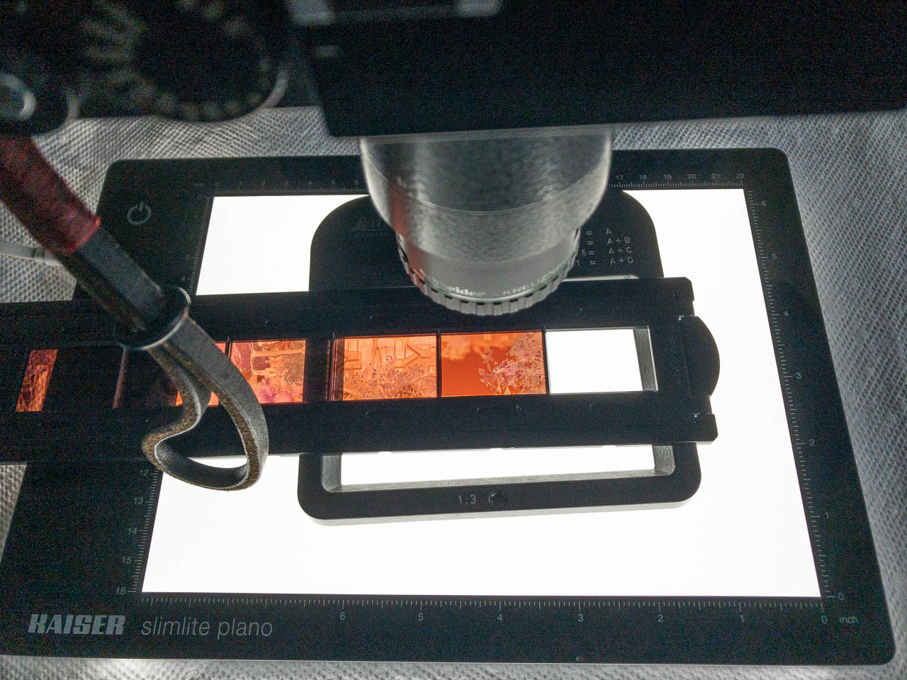

jmahto Posted January 20, 2020 Author Share #2 Posted January 20, 2020 Lightpad Kaiser slimlite plano (it is color balanced) and negative holder. Welcome, dear visitor! As registered member you'd see an image here… Simply register for free here – We are always happy to welcome new members! 1 1 Link to post Share on other sites Simply register for free here – We are always happy to welcome new members! ' data-webShareUrl='https://www.l-camera-forum.com/topic/305545-beoon-and-scanning-color-negatives/?do=findComment&comment=3895700'>More sharing options...

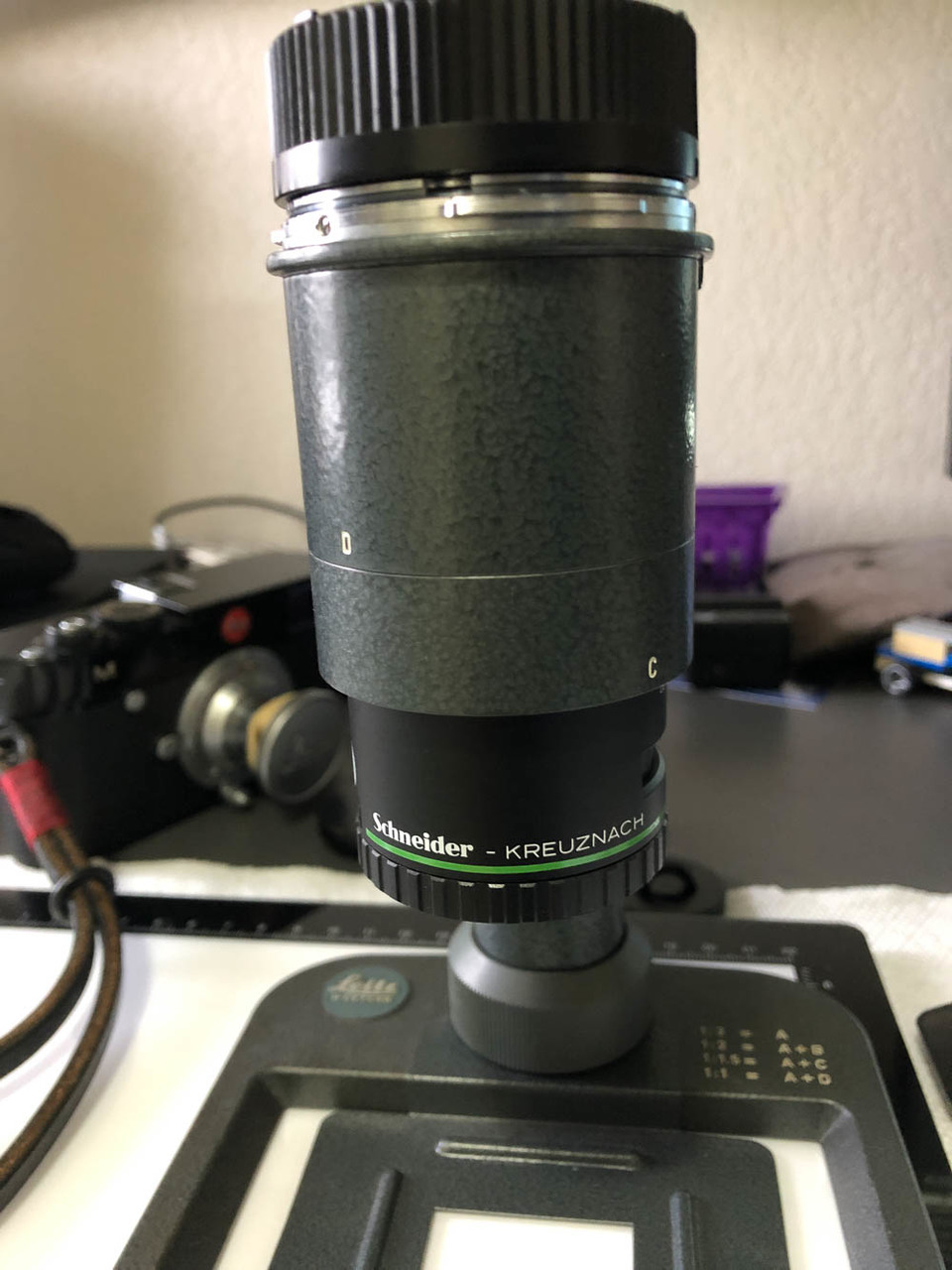

jmahto Posted January 20, 2020 Author Share #3 Posted January 20, 2020 Camera setting: Focus by raising BEOON column. Use f2 for docusing and then stop it down to f8. Shutter 0.7sec, ISO 200. If you want you can WB based on lightpad light (needed for color sides so that I don't need to adjust later. For color negative WB is adjusted in LR using unexposed part of negative. Welcome, dear visitor! As registered member you'd see an image here… Simply register for free here – We are always happy to welcome new members! 1 Link to post Share on other sites Simply register for free here – We are always happy to welcome new members! ' data-webShareUrl='https://www.l-camera-forum.com/topic/305545-beoon-and-scanning-color-negatives/?do=findComment&comment=3895702'>More sharing options...

Steve Ricoh Posted January 20, 2020 Share #9 Posted January 20, 2020 3 hours ago, jmahto said: Lightpad Kaiser slimlite plano (it is color balanced) and negative holder. Welcome, dear visitor! As registered member you'd see an image here… Simply register for free here – We are always happy to welcome new members! It looks like you're using the Plustek negative holder on top of the BEOON base. I remember using the same enlarger lens, i.e. the Componon-S 50 2.8, but using the BEOON 1:1 mask, however the column adjustment bottomed before focus could be acquired. I tried the Plustek neg holder as you appear to be using, as shown above, and 1:1 focus could be achieved without any problem. The only snag was centralising the neg holder each time I advanced the frame. If this could be overcome it would be perfect. Link to post Share on other sites More sharing options...
jmahto Posted January 20, 2020 Author Share #10 Posted January 20, 2020 1 hour ago, Steve Ricoh said: It looks like you're using the Plustek negative holder on top of the BEOON base. I remember using the same enlarger lens, i.e. the Componon-S 50 2.8, but using the BEOON 1:1 mask, however the column adjustment bottomed before focus could be acquired. I tried the Plustek neg holder as you appear to be using, as shown above, and 1:1 focus could be achieved without any problem. The only snag was centralising the neg holder each time I advanced the frame. If this could be overcome it would be perfect. ..correct. The column bottoms out with focal point at the bottom of the BEOON base and not below. With mounted slide or negative holder above the base it is just a matter of raising the column. Advancing to next frame and centralizing is not a problem if you look through the LV. For me the only issue is shooting the photo at the end of the holder (in my picture I have left one gap) since the folder won't sit on top of the base (one side will fall off). My current solution is to leave one gap and the move the strip after shooting the first one (so that there is a gap for the fifth one. The holder has space for six). I will also add a caution to cover the light gap (I didn't do in the picture above) for best results for photo at either end of the strip. Otherwise there is a slight light flare (causing corrected picture edge to darken). Link to post Share on other sites More sharing options...
Steve Ricoh Posted January 21, 2020 Share #11 Posted January 21, 2020 9 hours ago, jmahto said: ..correct. The column bottoms out with focal point at the bottom of the BEOON base and not below. With mounted slide or negative holder above the base it is just a matter of raising the column. Advancing to next frame and centralizing is not a problem if you look through the LV. For me the only issue is shooting the photo at the end of the holder (in my picture I have left one gap) since the folder won't sit on top of the base (one side will fall off). My current solution is to leave one gap and the move the strip after shooting the first one (so that there is a gap for the fifth one. The holder has space for six). I will also add a caution to cover the light gap (I didn't do in the picture above) for best results for photo at either end of the strip. Otherwise there is a slight light flare (causing corrected picture edge to darken). I was going from memory from about 2 years ago, but I remember the issue you mention. I tried all sorts of things to balance the Plustek neg holder. One of which was a sheet of glass sitting astride the BEOON base, with the neg carrier on top. I also masked using a sheet of black card with an appropriate cut out. The need to re-orientate the neg holder for each frame annoyed me so I went back to the Plustek. BTW, the BEOON was designed to be used with a 50mm Leica lens, and I found it worked as the designers intended. The only downside is a degree of softness towards the edges of the negative compared to a flat field enlarger lens. And that was with the 50mm 'taking lens' set at f11! Link to post Share on other sites More sharing options...

jmahto Posted January 21, 2020 Author Share #16 Posted January 21, 2020 (edited) 5 hours ago, dau said: The base of the BEOON has cutouts so that you could pass the film strip under the BEOON's base. I have tried the negative (without holder) directly under cutout and it does work even with my enlarger lens, however there is a chance to get Newton’s ring due to direct contact between negative and glass. If you use negative holder under the BEOON base then you may not be able to focus for some lenses like mine due to increased distance and BEOON column bottoming our. Steve also mentioned it above. Edited January 21, 2020 by jmahto 1 Link to post Share on other sites More sharing options...

jmahto Posted November 23, 2020 Author Share #20 Posted November 23, 2020 On 11/18/2020 at 12:36 AM, Rokkor said: Thanks for sharing. Would that also work with an adapted APS-C camera like Fuji X-T1? Is the Schneider lens the only lens needed? Images look great. I just now tried with my Sony Nex6. By using only D tube and 50 Componon-S, I can focus and image "almost fills" the sensor. You will get parts of sprocket holes in scan and I will consider it acceptable. This is compared to FF where using D+C tube and same lens fills entire sensor with 1:1 image. 1 Link to post Share on other sites More sharing options...
