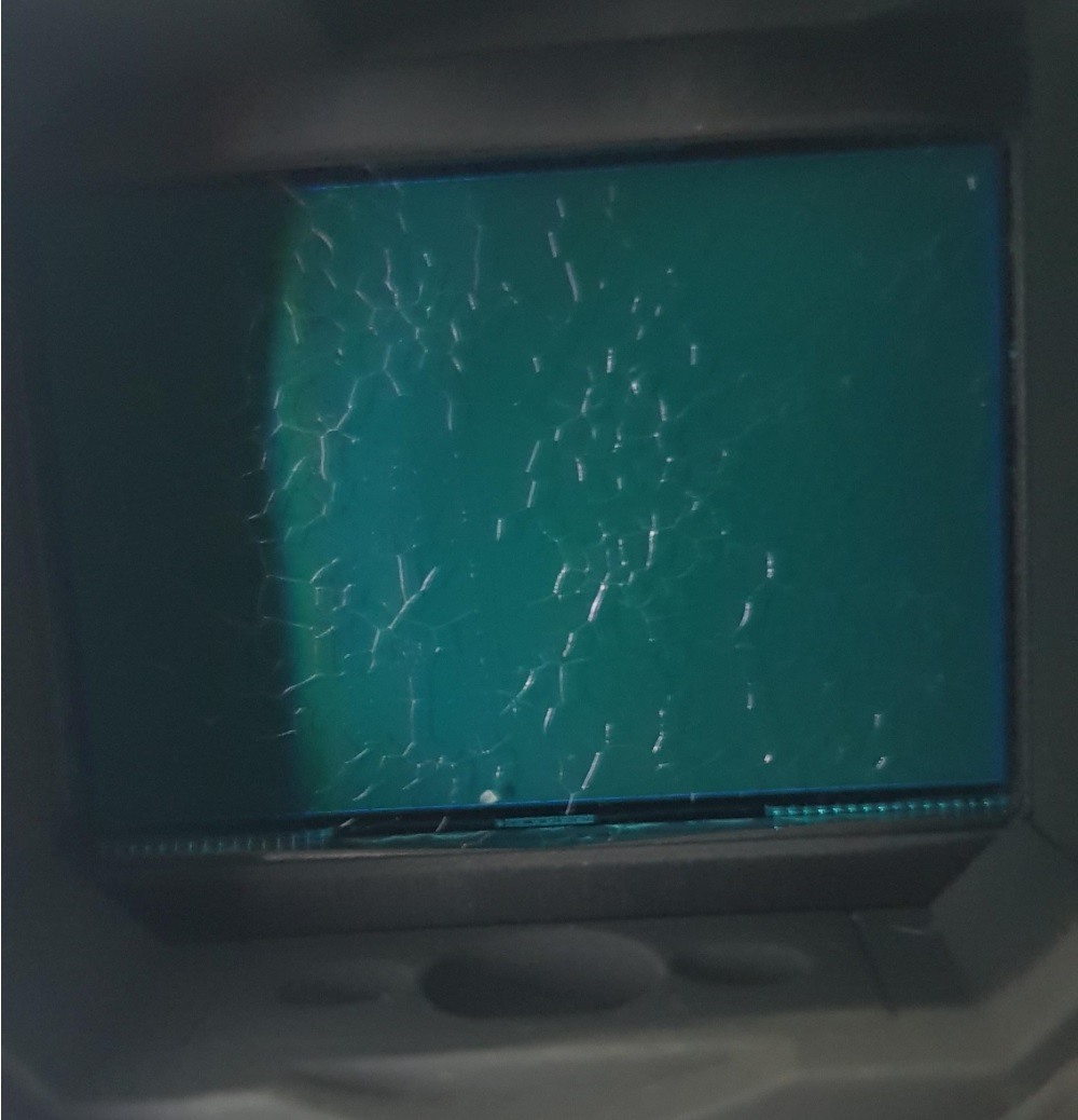

kievnut Posted October 28, 2019 Share #1 Posted October 28, 2019 Advertisement (gone after registration) Haven't used the M9for about 10 months and just find out the sensor looks like this? What can be the problem? CCD replaced years ago. Thanks. Welcome, dear visitor! As registered member you'd see an image here… Simply register for free here – We are always happy to welcome new members! Link to post Share on other sites Simply register for free here – We are always happy to welcome new members! ' data-webShareUrl='https://www.l-camera-forum.com/topic/302911-m9-sensor-problem-with-images/?do=findComment&comment=3843826'>More sharing options...

ianman Posted October 28, 2019 Share #2 Posted October 28, 2019 (edited) 16 minutes ago, kievnut said: CCD replaced years ago How many years ago? Knowing the exact date would help. You can also email Leica with the serial number of your M9 and ask which sensor you have. Edited October 28, 2019 by ianman Link to post Share on other sites More sharing options...
kievnut Posted October 29, 2019 Author Share #3 Posted October 29, 2019 Sensor was replaced on Jan 2014. Emailed Leica and replied with "Sensor corrosion" and most likely have to pay for the replacement. I thought "Sensor corrosion" is "some dots on the sensor" (I found this before the sensor was replaced in 2014) but this "spider web" like stuff is 3D on the sensor and is like growing... It is like this Link to post Share on other sites More sharing options...
Ray Vonn Posted October 29, 2019 Share #4 Posted October 29, 2019 That's amazing, first time I've seen something like that. Fair enough if the camera's been dropped on the floor, but just to corode like that?? Link to post Share on other sites More sharing options...
ianman Posted October 29, 2019 Share #5 Posted October 29, 2019 9 hours ago, kievnut said: Sensor was replaced on Jan 2014. Emailed Leica and replied with "Sensor corrosion" and most likely have to pay for the replacement. I thought "Sensor corrosion" is "some dots on the sensor" (I found this before the sensor was replaced in 2014) but this "spider web" like stuff is 3D on the sensor and is like growing... Jan 2014 was well before the new type was developed so that sensor is at risk. But you got the answer from Leica so now you are sure anyway. I thought it was always dots too but I have seen a few weird shapes posted here and there. 1 Link to post Share on other sites More sharing options...

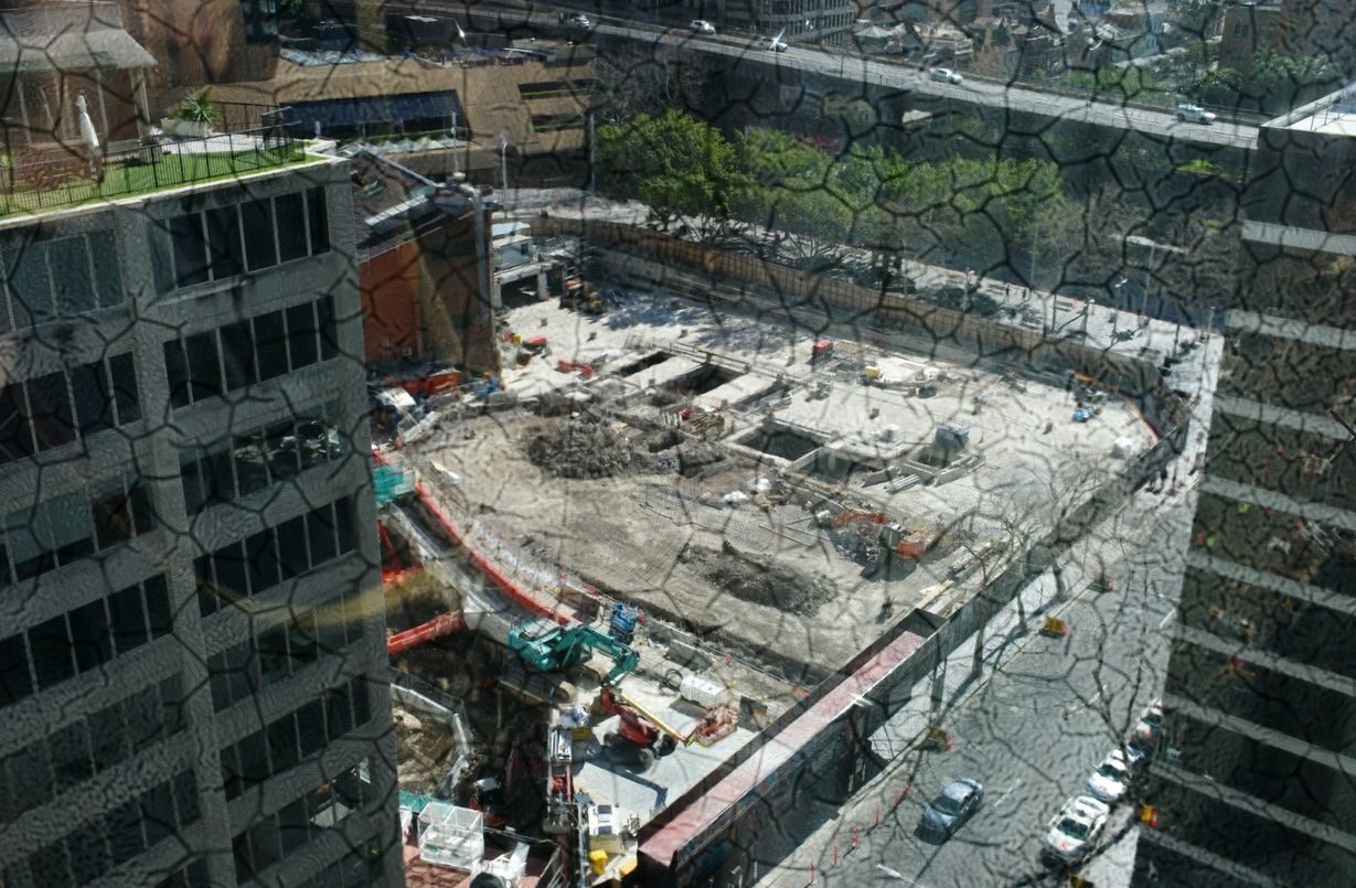

Ko.Fe. Posted October 29, 2019 Share #6 Posted October 29, 2019 14 hours ago, Ray Vonn said: That's amazing, first time I've seen something like that. Fair enough if the camera's been dropped on the floor, but just to corode like that?? Here is another one. 1 Link to post Share on other sites More sharing options...
Ray Vonn Posted October 30, 2019 Share #7 Posted October 30, 2019 Advertisement (gone after registration) 9 hours ago, Ko.Fe. said: Here is another one. Wow. And yet I would still go on replacing sensors rather than plump for the newer CCD-less models. 2 Link to post Share on other sites More sharing options...
capelini61 Posted June 29, 2020 Share #8 Posted June 29, 2020 On 28/10/2019 at 18:55, kievnut said: Não usa o M9 há cerca de 10 meses e apenas descobre que o sensor se parece com isso? Qual pode ser o problema? O CCD foi substituído anos atrás. Obrigado. Welcome, dear visitor! As registered member you'd see an image here… Simply register for free here – We are always happy to welcome new members! I replaced the original sensor with a second generation one and it is now corroded after 4 years, I have already contacted Leica and they said there is no guarantee. Link to post Share on other sites More sharing options...
