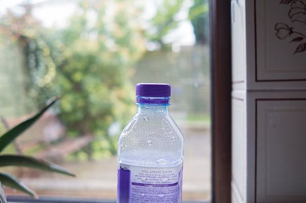

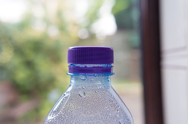

jenniferx Posted January 27, 2017 Share #24 Posted January 27, 2017 I received my step up ring and additional elpro 2 today! I've taken some illustrative pics regarding their use that maybe someone would find helpful if this modification is of any interest. Stacked together there is definitely obvious pincushion distortion- these wooden blinds are straight in real life. Corrected with a value of -14 in Adobe Camera Raw seems to do the job. And it's not scientifically measured by any stretch but I took some pics of a bottle of water to roughly provide a bit of perspective on the gains from the elpro's, for my own reference as much as anything else. The width of the purple lid is just a tiny bit over 3cm. This first picture is the closest you can get with the x2 on its own. And this is with a single elpro 2 added. Big leap up. And finally with the second elpro 2 added on (this one was corrected for distortion, same figure as above -14) For my own purposes I think the single elpro 2 will be sufficient for pretty much any close up's that I want to take out and about but it's nice to have the option of also going a little bit further if needs be. I'm still super pleased with this little set up and can't wait to use it properly. 1 Link to post Share on other sites More sharing options...
