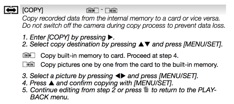

wbarker Posted May 2, 2010 Share #3 Posted May 2, 2010 Directions for copy command Link to post Share on other sites More sharing options...
